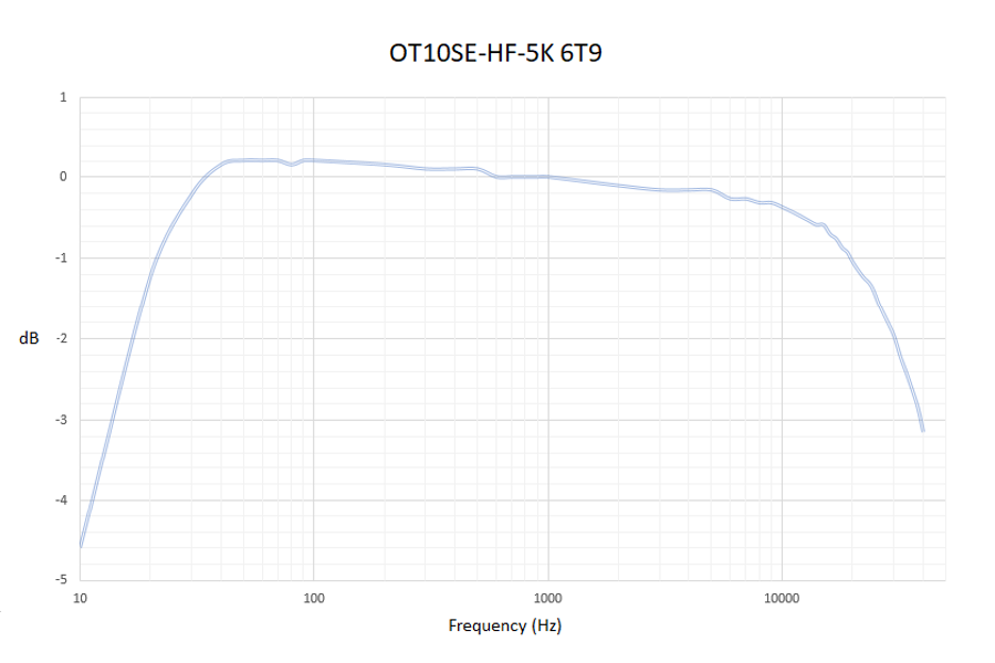

I built a "spud" amp based on the 6T9 tube with the pair of the 5K OTs. (2.7W output @ 1 kHz) Here's the frequency response graph:
attachment.php

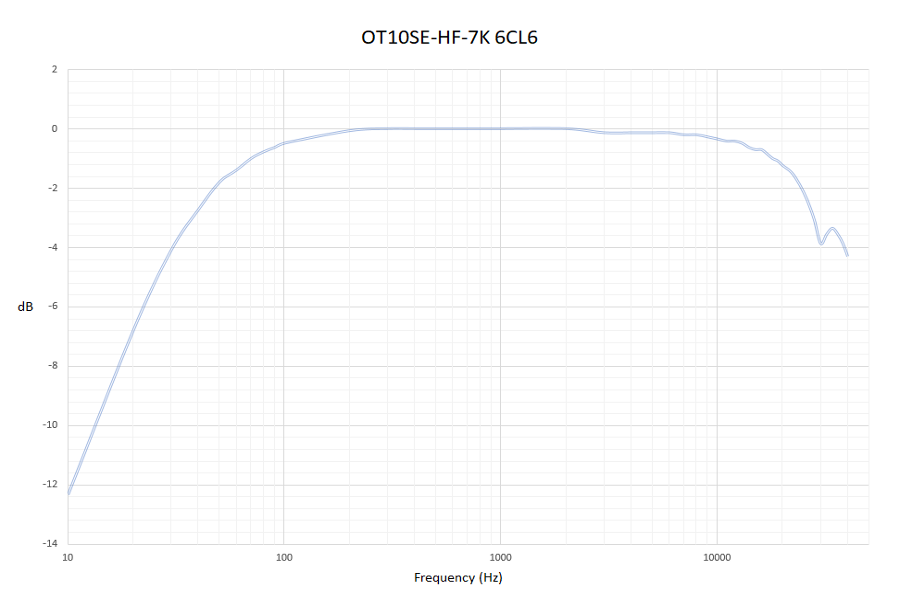

I got a pair of 7K OTs for another spud. (1.7W output @ 1 kHz) Here's the FR graph:
attachment.php
They sound pretty good.
