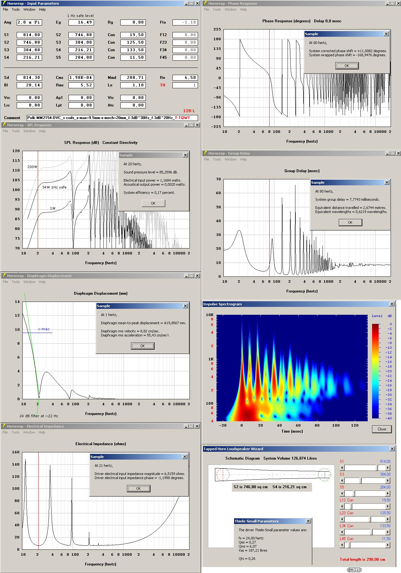

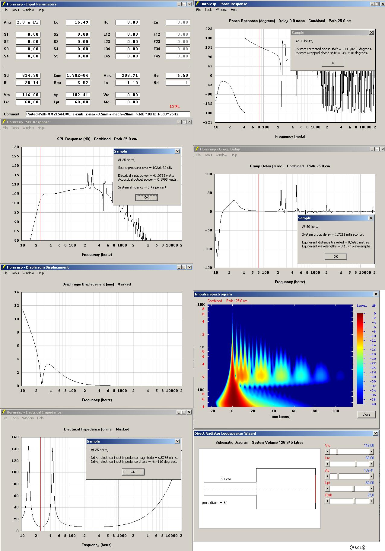

Hi Sulla,FYI
You are IMO pretty close with your estimation, See my investigations:
b:magnify: 🙂
