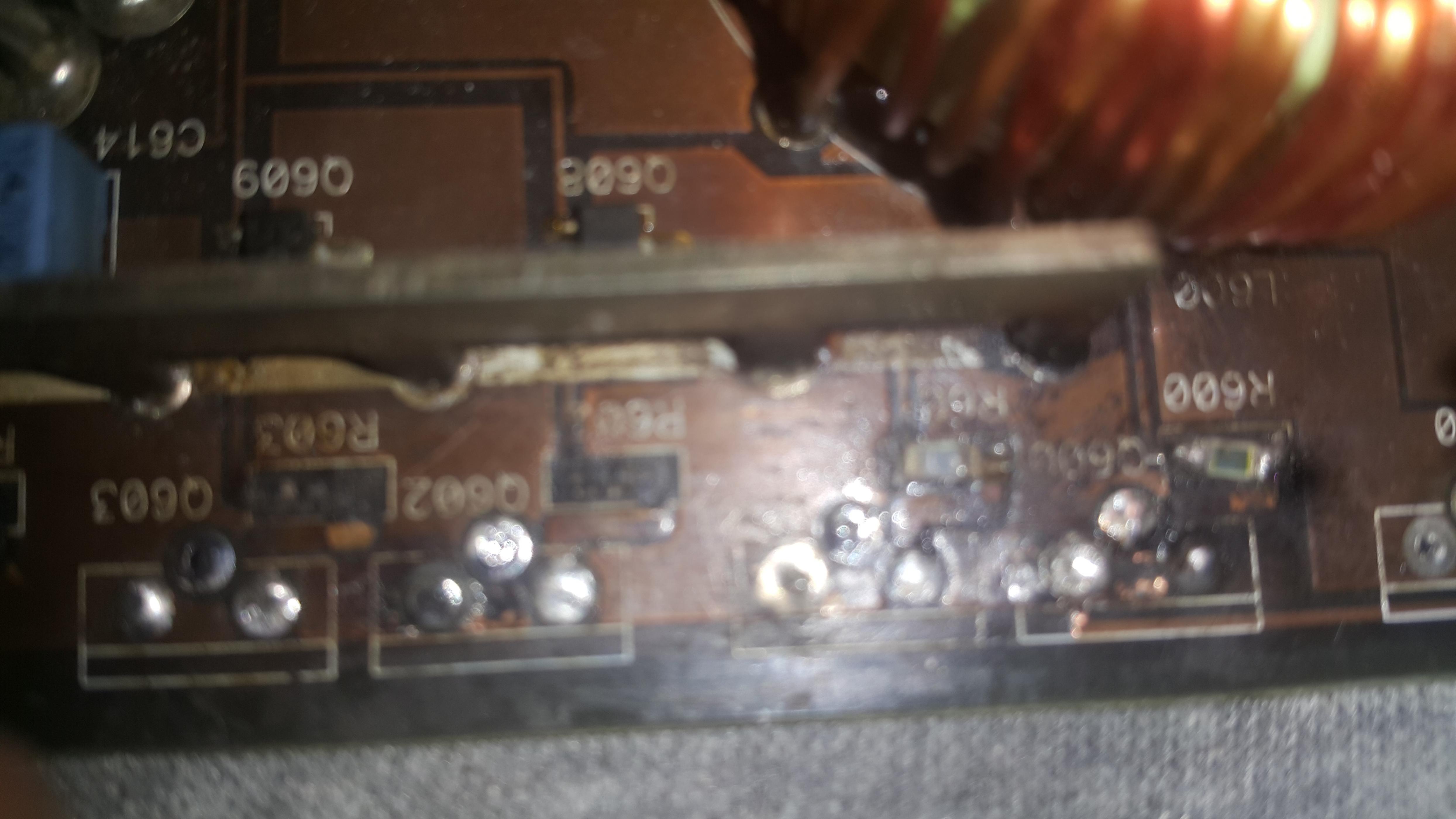

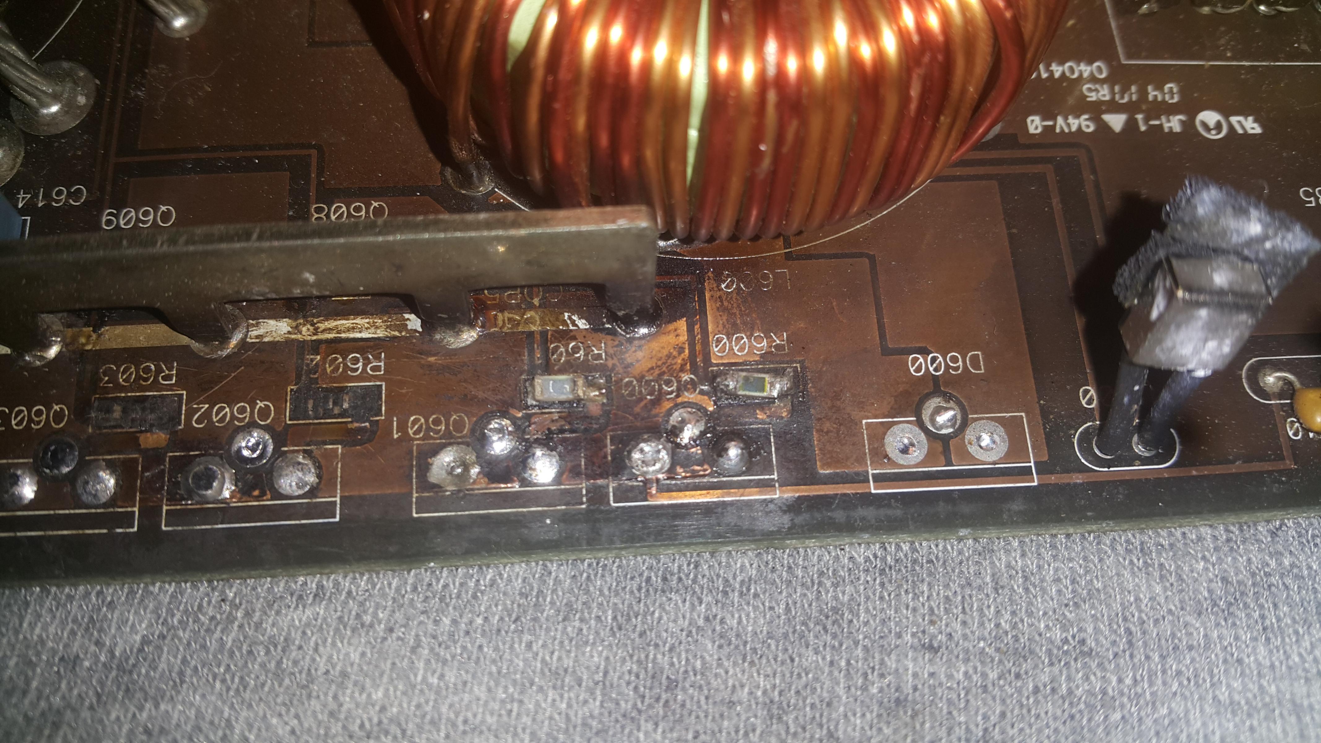

Can someone help me to identify R600-R607 thank you
