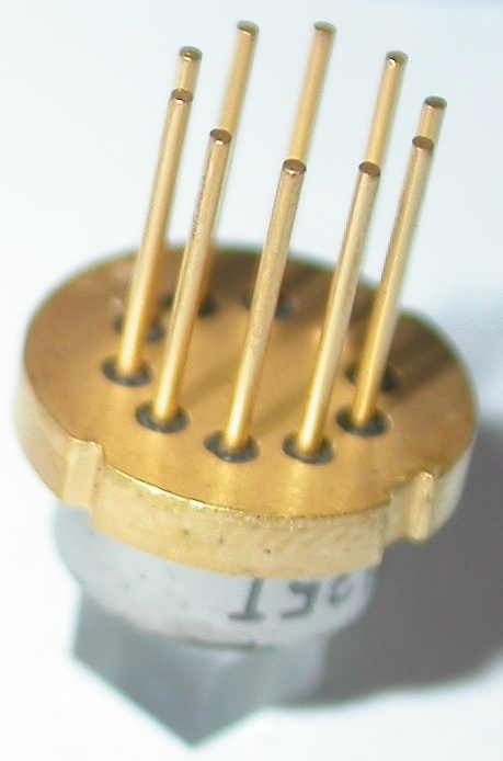

Different Sharp's LDGU (hologram Laser Diode) Types - LTOH30PA vs. LTOH30PF
For Sharp's LDGU devices LT0H30PA and. LT0H30PF there still isn't find a data sheet.

This means, that the only different between this two hologram laser diodes obviously must be the max possible speed suitability.
Who knows, from which pc cd-rom drive type/model comes this datasheets?

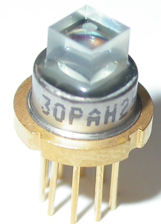

in the attachement the Sharp diodes, from that I need the currently available successor devices in the same outline

In the meantime I get various CDM12.4 laser heads again.
All ones where is to read "Made in" ... Japan, Malaysia and Taiwan work fine in all respects.
Thus there must actually be a supplier either for NOS from Sharp or good quality copy.
But all CDM12.4 heads "Made in China" (10 pcs) I had to complain cause too low power output.
I must send back all 10 pcs. Thus the hologram diodes from this heads must be a bad copy
