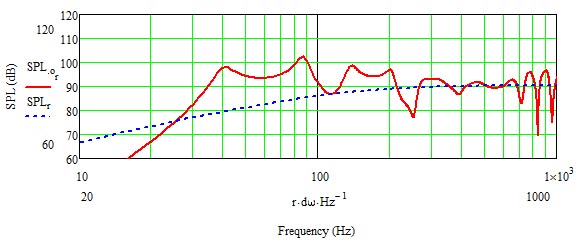

Thank you very much for running the sim on the FW208N. Is that boominess caused by too low a Qts, too low an Fs, or is it more complicated than that?
Sorry I didn't reply to you specifically. Read my posts just before this one to get an idea whats wrong. I suspect its just a CC (compression chamber) size problem and has nothing to do with the Q or the FS of the driver. The nice thing about a horn is that they are very forgiving of these specific things. I said I wouldn't re-sim it with an adjusted CC but I think I will just to see if it helps. If it does, then with the way I designed this box, you can adjust your CC quite a bit in either direction. Let me run upstairs and I will take a look at the numbers.

Tom,
Are you sure the T/S parameters you used to create the SPL curves in Post #19 are correct. The dashed blue curve, driver infinite baffle response, does not look right for a low Qts driver. The SPL at 1 kHz looks very low and the hump around the driver fs looks more typical of a driver with a Qts valius of 1.2. I think this is what produced the boomy BLH response.

Okay, I just simmed it again with different CC sizes. I was wrong in my assumption. I have to retreat and say I am not sure why this driver is not working well but I don't believe the Qts is the problem. I think the Fs as you stated may have a little to do with it. This is a 37 Hz exponential horn. That is a driver with a free air resonance of 29 Hz. The horn is likely tuned too high for this driver and just as with a BR box displays a boominess in a particular frequency range when tuned too far above the Fs of the driver. That's my best guess at it. Anyone else want to take a stab at the full reasoning? Dave, Chris, Gm, Scott?

Thank you Martin for chiming in. No, I am not sure of those parameters. They are what was provided me. I thought the curve looked out of whack as well. So, if the T/S parameters are incorrect then all my stammering around in the dark here was in vain. Hehe, that's good to know because I hate it when I am totally befuddled by something. So what do you think is off on those parameters? I looked and looked around for a full set or a measured set on the interwebs but wasn't able to get any.

Tom,
My guess is the BL you entered is too low. Did you use the MathCad worksheets to check or complete the T/S parameters? If you have Vad then you can calculate BL using the appropriate MathCad worksheet. I think there is enough info to derive the T/S parameters not provided on the Fostex data sheet. If you cannot find independent measured results, this is the next best option.

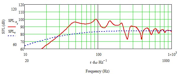

Hmm, I did use your BL sheet. Let me double check to see what numbers I used. I entered something wrong it seems. I don't know what though because as you stated my BL is coming back way different than it did the first time. Maybe I misread the results before. The IB response is more inline for what we were looking for. Thank you Martin. Now, we are still getting a wicked hump at 40 Hz but hang on (doing all of this in realtime). Okay, I was correct about the CC helping a great deal. I don't seem to be able to lose the 40 Hz hump but I can reduce or at least alter it through CC volume adjustment. Martin, as always, thank you for chiming in.
Tell me, is the 40 Hz hump a result of a horn that is tuned too high for the driver in question? Thanks!

Harderror,
Well, due to my own error those initial results were off. Now, from the looks of it, that driver will work but you will have a pretty obvious 3-4 DB hump at 40 Hz. I think that could be tamed with stuffing but let me go check that. BTW, the sim I posted on the last post was with an enlarged CC. If you were to keep the CC the same size, the hump would be at 45 Hz. Adjusting stuffing could help but keep in mind if you stuff too densely you could affect the dynamics of the driver adversely and likewise if you don't stuff at all. I tend to just line all sides of the CC with batting but others claim they like the sound with actual stuffing in the CC. You can adjust things marginally as well by stuffing the first 1/3 of the line and or batting different areas down the line. I think the only way you are going to reduce that hump is through the adding of series resistance. 6 ohms gives a pretty acceptable curve. (See attached) The attached FR is the design as is with 6 ohm of series resistance added. That in theory could sound pretty good though it may be a touch unethical in Full Range circles.
So, coming full circle, yes, this design could work quite well with that driver. I hope to see someone try it as it could be interesting to have a true audiophile 2-way horn design that needs no subwoofer. In fact, I want to try it now. So many drivers, so little money.

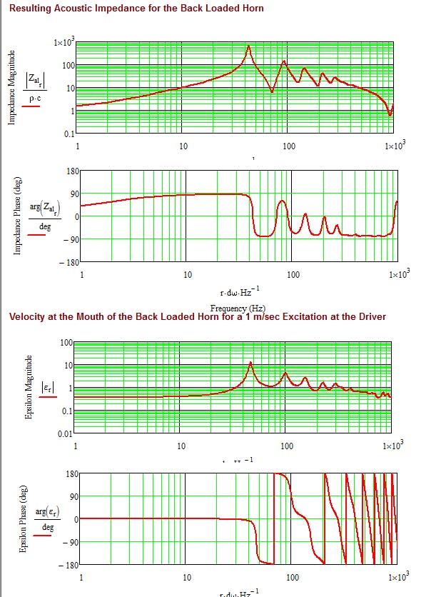

Tom,
I think you need to look at this as two designs.
Below about 200 Hz you have a TL (or TQWT if you prefer) with several lightly damped standing wave resonances. These create the peaks in both the acoustic impedance and velocity ratio plots. The resonant behavior spills over into the SPL plot where you see peaks and dips. Adding stuffing will help reduce the Q of each peak.
Above about 200 Hz the acoustic impedance of the mouth is starting to damp the standing waves and couple the "horn" to the room efficiently. That and the offset of the driver in the coupling volume smooths the SPL response.
Now assuming you can live with the peaky-ness. The elevated response below 200 Hz is going to help with the baffle step issue. I think you will see benefits in the corner loaded part of the simulation.
Martin

When I design a horn, I always make sure I am getting around a 4-6db lift so that baffle step is effectively dealt with. The thing that has me on this driver is that sharp peak at 40 or 45 Hz depending on the parameters of the CC. I guess I just wanted to understand why this particular driver looked to be 3 db higher at 40 than it is at 70. I now believe it's an impedance issue to some degree but the question still remains, what causes that sudden swoop up on the FR at that frequency. Do you believe that a speaker with a free air resonance of 29 Hz is peaking like that because the horn is tuned to 37 Hz or 45 Hz? I suppose it isn't that terribly important since the majority of the drivers I designed this enclosure for have a fairly smooth LF shoulder and don't do a quick peak just before dropping but understanding why seems like it would be helpful. Thanks again Martin!
