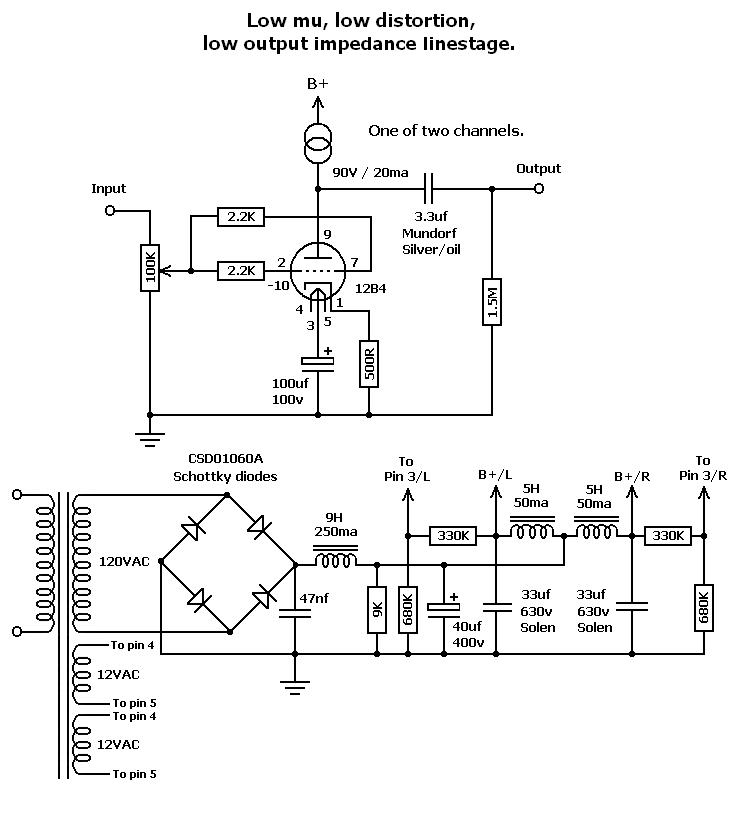

A "gotcha" with common cathode line stages is trouble with low impedance loads, like those some SS power amps present. Few tubes, in common cathode, can directly drive the IHF 10 KOhm "standard" load. A happy exception to that state of affairs is the 12B4. Plenty of 12B4 designs are available. I've uploaded my version.
The power supply shown uses a pseudo choke I/P filter. Choke I/P filters are inherently well regulated, unlike the cap. I/P filters you may be familiar with.
It seems you are in a "240" V. power mains zone. Both a Triad N-68X, for B+, and a Triad VPL24-400, for heater power, have dual primaries. Therefore, that "iron" works in both "120" and "240" V. zones and it's reasonably priced.
