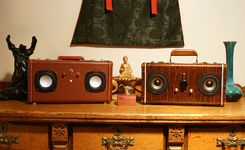

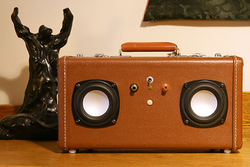

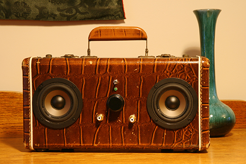

Here are some photos of a couple mew portables. The cases are vintage French made clarinet cases cr. early 60's. reinforced with 1/4" board to give them more stiffnes.
One has a pair of Aura NS3-193-8A and a modified Sure 2024 amp with a Li-ion 12v battery for power. The second one have Tang Ban W3-881SJF full range drivers with a small low pass filter and a Sure TPA3122D2 amp with the same Li-ion battery pack.

Nice! How do they sound, and how do the Tang Band compare to the Auras? I choose between exactly those two drivers for my build!
They both sound quite decent for such a little box. The Aura/2024 has a nicer full rich sound with a little better bass than the Tang-Ban/3122 combination. The Tang-Ban/3122 is quite a bit louder but a tiny bit thin. All and all I am quite happy with the way they turned out. Friends who have heard them are quite amazed by the sound and volume they put out. I have one more case to work with- not sure what I will put in it. I'm pretty much limited with the 12v battery supply.
OK that is what I expected! I went for the Aura for that reason.

Congratulations, they're cool! I have something similar in mind so this is good inspiration. Unfortunately the speakers you're using are not as widely/cheaply available in Europe and shipping+taxes is generally a deal breaker for me when buying from US so I'm currently looking into alternatives. Tang Band W3-665SC is on my short list in order to stay low budget (can be found for €10) but I'm not sure how they compare. Logitech have used them with success in their computer speakers though so it's supposedly a tried and tested driver.
Update to the above: I managed to find the Aura's for a reasonable price (about €16 here in Denmark) but the same shop also has Monacor SPX-32M for around €20 which could be just as interesting. In any case the odd looking wooden phase plug would be a neat match for a retro style box like yours!

But not much in the way of driver separation (stereo) and What keeps fingers. toes and Golf balls from destroying those cones ?

Bare- There isn't a lot of separation of the speakers but what can you do with such a small case. They are sealed in separate sealed enclosures inside the case.
Thor Ra- I buy the Aura's from Sollen for about $16 so that's pretty close to what you are paying. It's actually the power supply that's the most expensive component.
