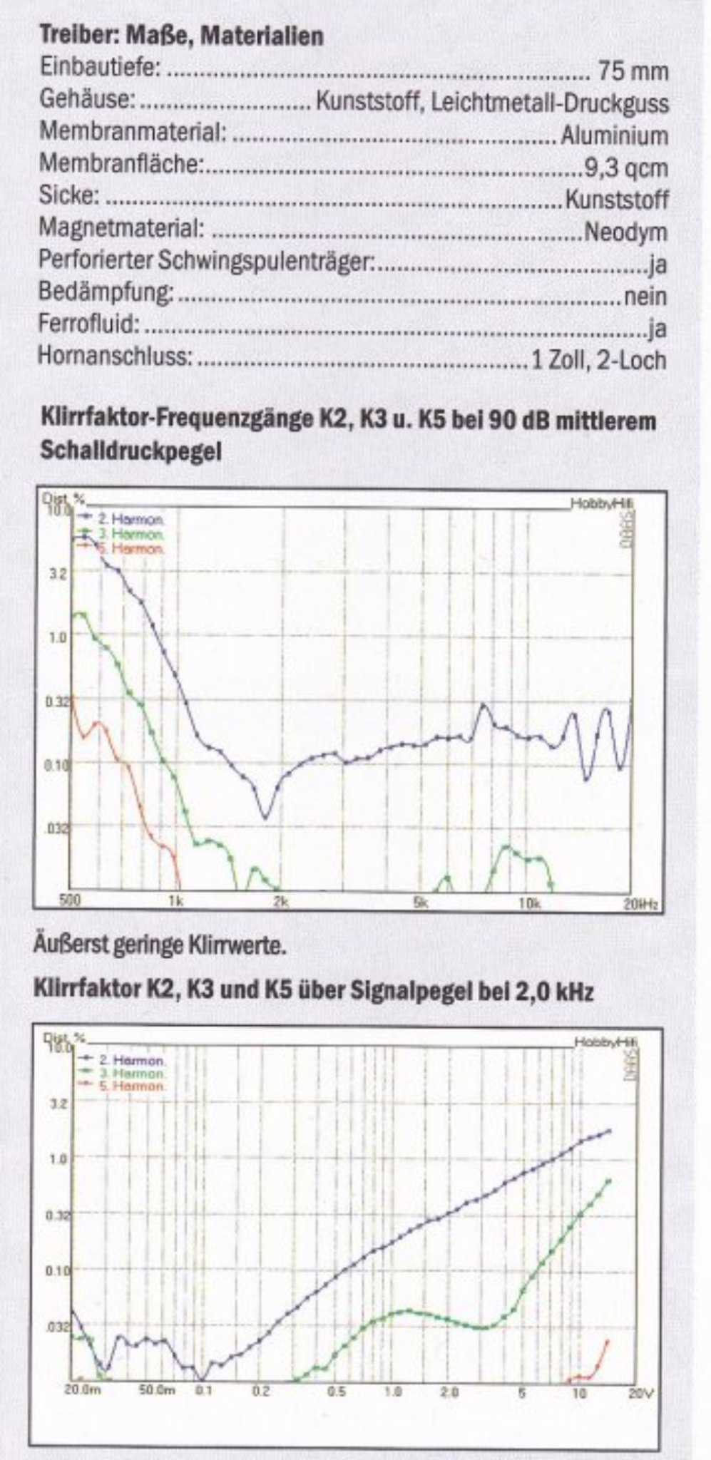

Here are some distortion plots of the CDX1-1430 on the H1-7050 WG. Its just as good as some higher end soft domes. This isn't common for most CDs, to be this suited for hifi use.

The Celestion CDX series basically IS a dome tweeter. Above is a pic of my CDX1-1425 that's been taken apart. As you can see, it's a plain ol' aluminum dome with a very simple phase plug attached.
I think it's possible that the improved performance may be due to a relatively low compression ratio.
IE, with 'conventional' compression drivers, you have a concave dome, typically titanium or mylar, and a phase plug with a very high compression ratio. Basically, 80-90% of the diahpragm is masked off.
With the CDX series, it's a convex dome (like any ol' hifi tweeter) and the phase plug is 90% open. Compression ration is around 2:1 I'd estimate.
The B&C neodymium compression drivers with 0.7" and 0.5" throats are built the same way, but the B&C uses some type of soft plastic, whereas Celestion uses aluminum.

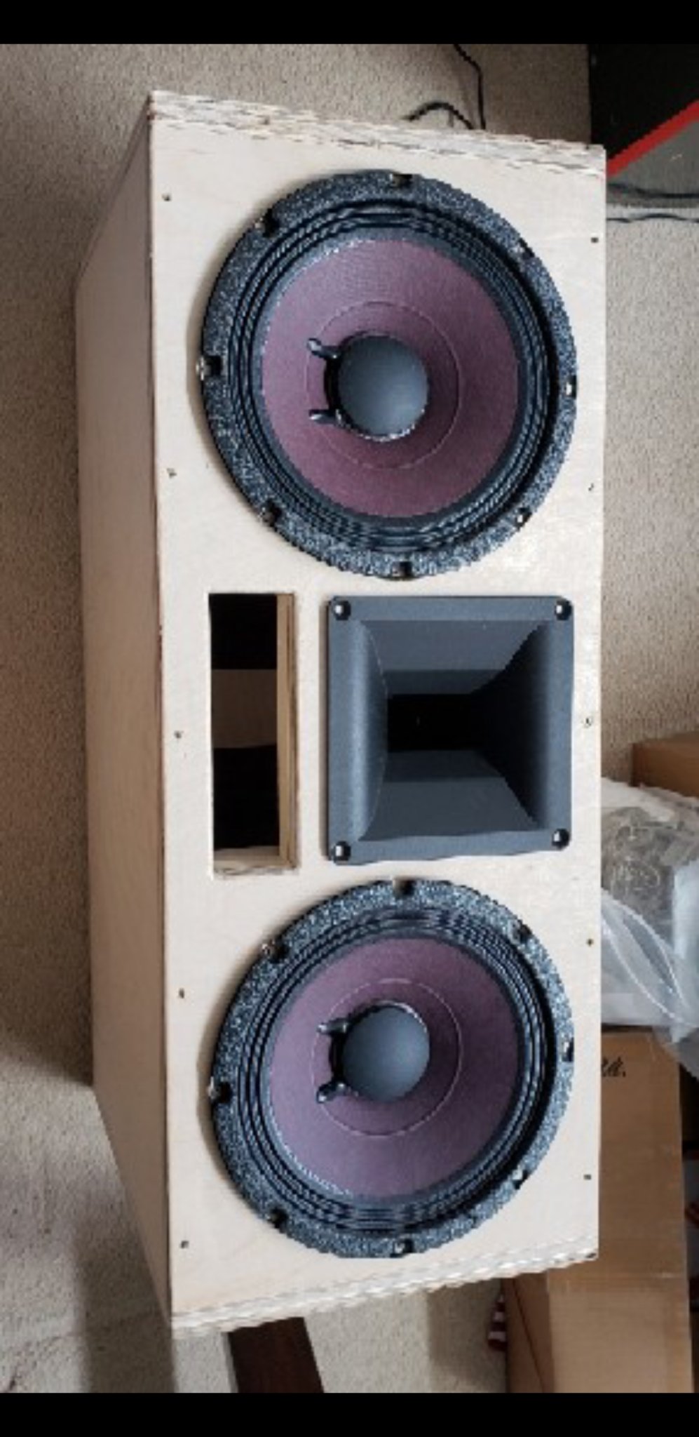

I'd want to experiment with open up the outer phase plug on the 1430 and trying it on a smaller, shorter horn for better HF dispersion. As it stands now, it sounds great on both the H1-7050 and STH100. Above 3k the 1430 sounds just as good as any larger metal hifi dome, maybe a bit more engaging too. Cymbals, horns and flutes are reproduced so cleanly and with great depth / width throughout the entire listening window, which is surprisingly wide with even the STH100. The slight edge goes to the H1-7050 though. I think the phase plug does show its limitations by the extreme top end, dropping off sharply like a rock. The 2407 does this too along with other ring radiator clones like the Eminence 151 and PRV D260. For the money, the D260 is amazing, being that it only costs 50 bucks retail. I use this one ALOT on small PA builds crossed above 2.5k on the ME20 and STH100 WGs. Below is DE260 on ME20 and 2 x Beta8A
