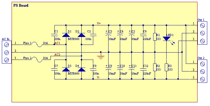

hi,
can u post a schematic for PS10K40. Would like to order two units but just to confirm whether it fits or not.
i post the schematic, it is the same for all the boards with single differential voltage, only the value of the caps is different.
i check the 22,000 uF at 50V caps, there is no cap with this value which can fit on this board. they are big can type, with screw terminal only. an alternative will be to use the 18,000uF at 71V which fit exactly on this boards, they are 35mm diameter and 100mm long. the total capacitance is enough even for class A amplifiers.

Please note I inquired about the larger capacitor than that comes standard with the kit
the biggest capacitance caps which can fit on this board are 12,000uF, the model which i use for the TA3020 v2 board. they are 30mmx50mm. for bigger capacitance, may connect in paralel with this caps, next to the board. one good solution will be to use one 18,000uF at 71V connected between V+ and V- this will increase performance, and attenuate pumping effect which ocures at class D and T amplifiers.

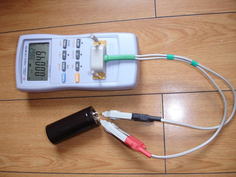

HI,
for your PS10K40, can I know the capacitor ESR and the operating life ? What is the make of the MUR , On semi ?
rgds.
i measured the 18,000uF at 71V caps ESR, they have about 5 mOhm. this is a very low value, not too many caps have ESR so low. the capacitors life is depending on the ripple current and working temperature. the minimum operating life is 4000 hours at 85*C and maximum ripple current. the operating life rise exponentially if the temperature or ripple current decrease, so values of 100,000 hours or more are very common.
the diodes are made by ON Semi.
