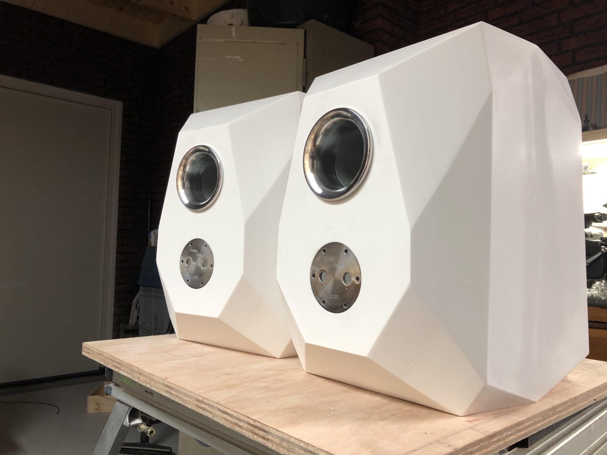

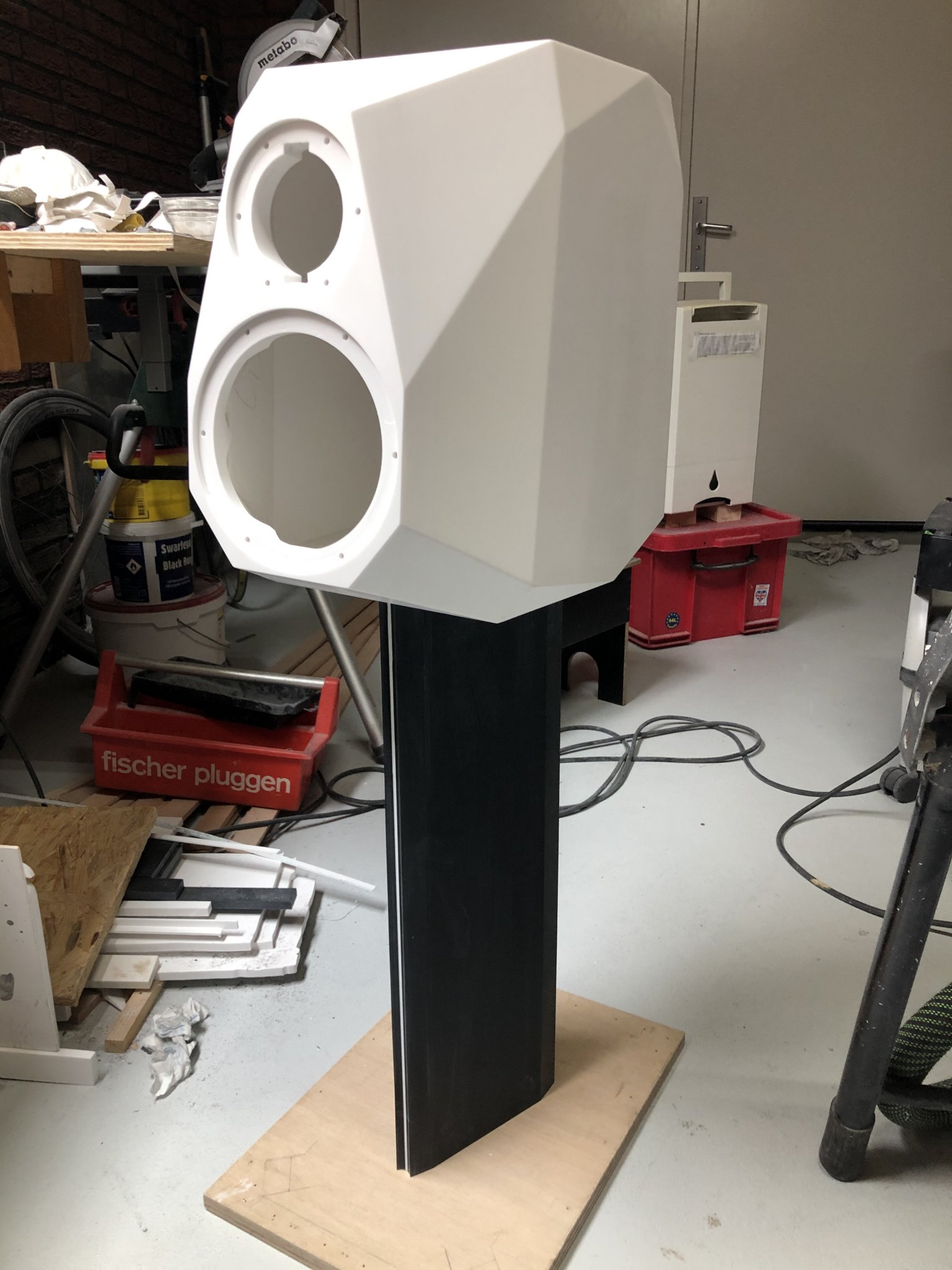

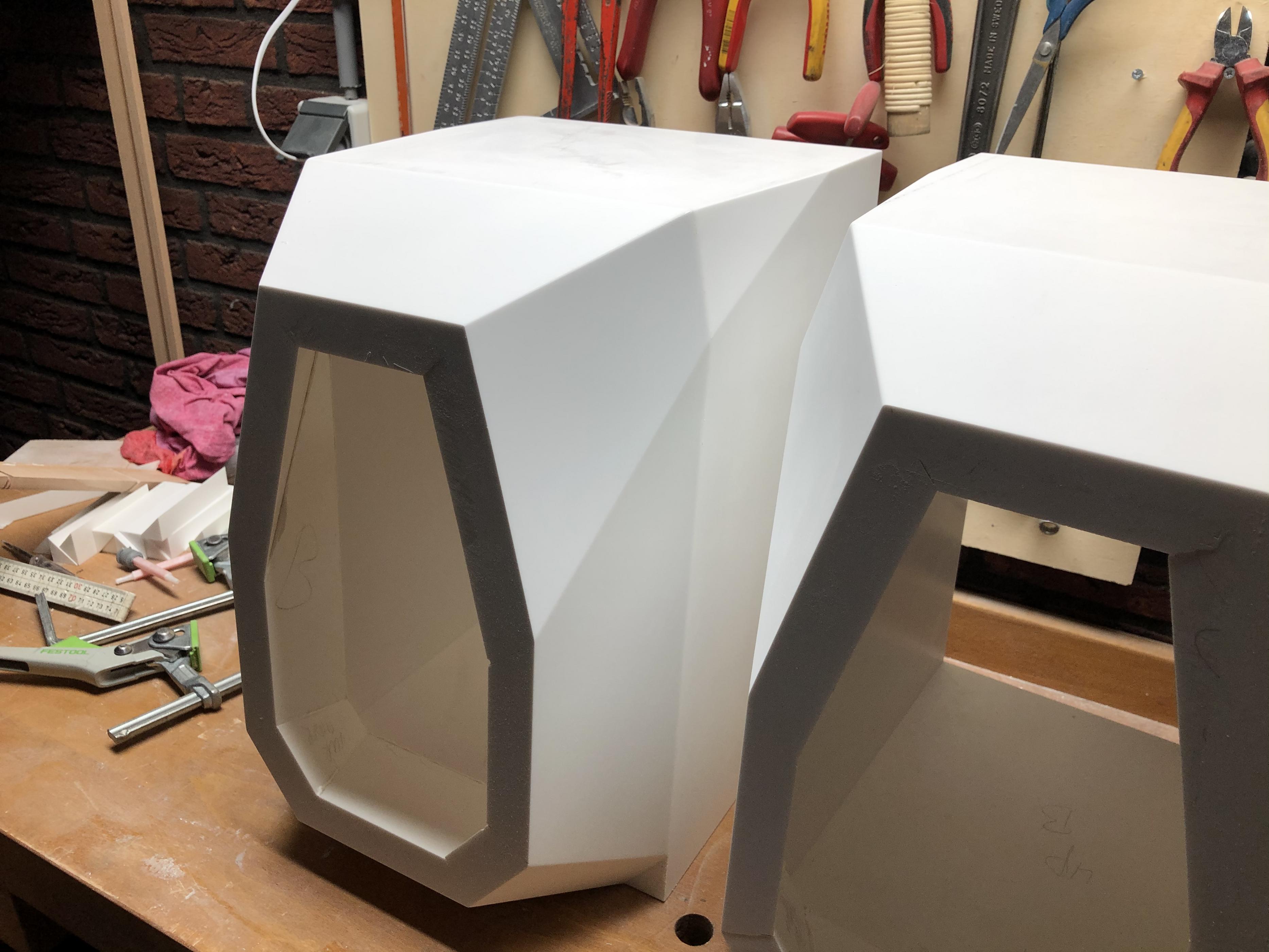

Last year I build a record player with a plinth of the material Corian, it was a great improvement relative to my previous player, which was made of veneered plywood. That made me thinking of another built of my current loudspeakers out of corian
a few weeks ago I started the built, I still have the drawings that I made 6 years ago, these are based on a thickness of 25mm, corian plats are 12.5mm thick, so I had to glue 2 plates together to achieve 25mm thickness.
The build still in progress, and I'll give you some pictures

HI, that truly looks great! Last year I started as a student on thh Hout en Meubilering College in Rotterdam. Now I am looking for challenging projects, and I think this one is very challenging. Can I find those drawings somewhere. I would like to create these in solid dutch essen and walnut. Thanks in advance.Small update
Very cool build! Have to ask what you are using to cut with? Looks like you would need an and industrial size wet table saw?
Very nice. Next pair you should go for 10mm + 14mm corian + 1mm viscoelastic glue = 25mm. This will give you an even deader cabinet.
Had a google around on this. Turns out you can use anything that'd cut wood. Hole saw, bandsaw, jigsaw etc. I'd been thinking of Corian for a TT plinth, kitchen suppliers sell offcuts, some will cut to size & finish edges if that's what you want.Very cool build! Have to ask what you are using to cut with? Looks like you would need an and industrial size wet table saw?

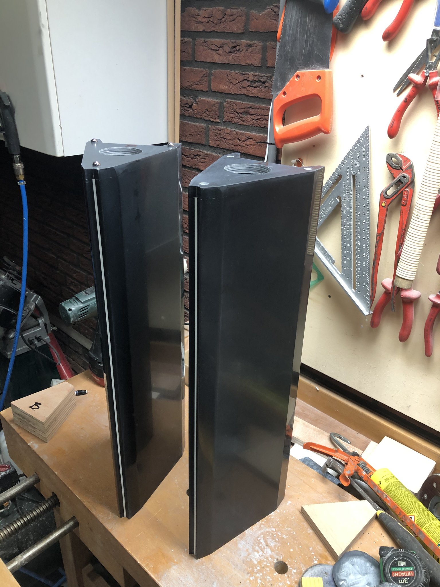

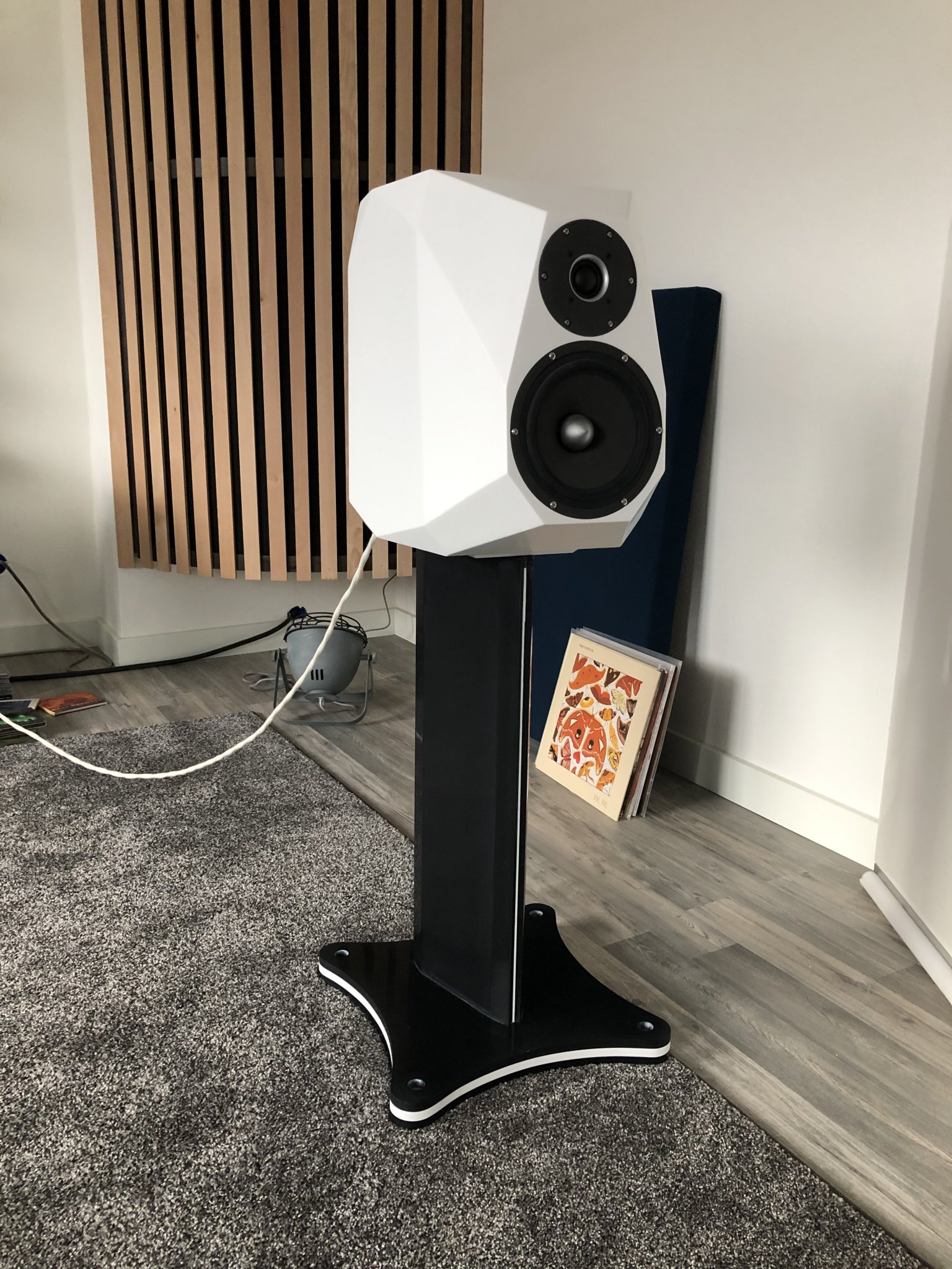

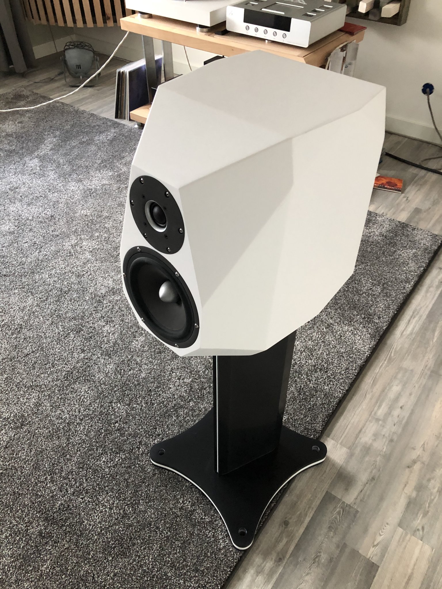

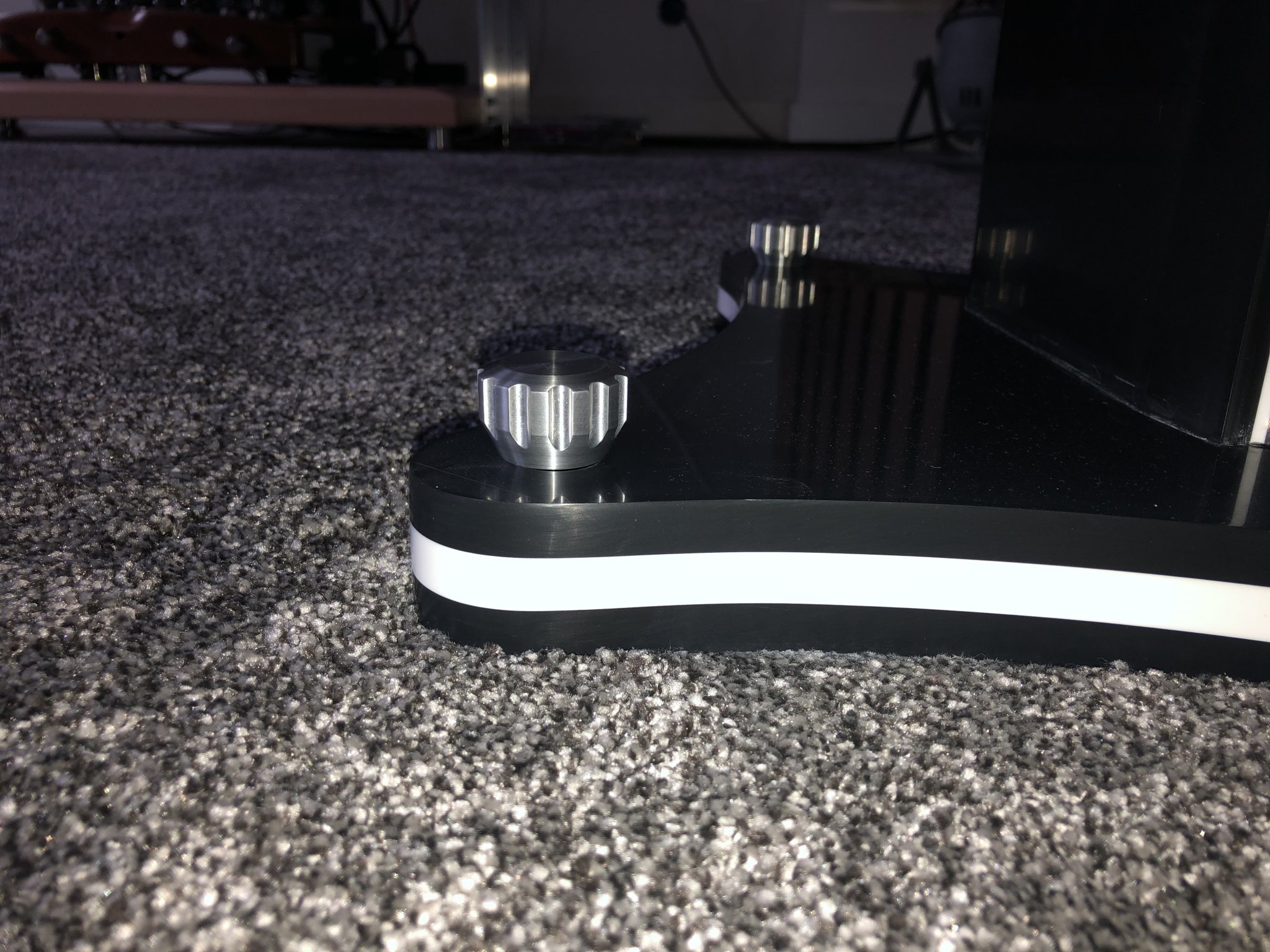

And some pictures of the final result
Everything is better, tight base, more detail, wider stage, midrange is beautiful.
During listening, speakers are not noticeable

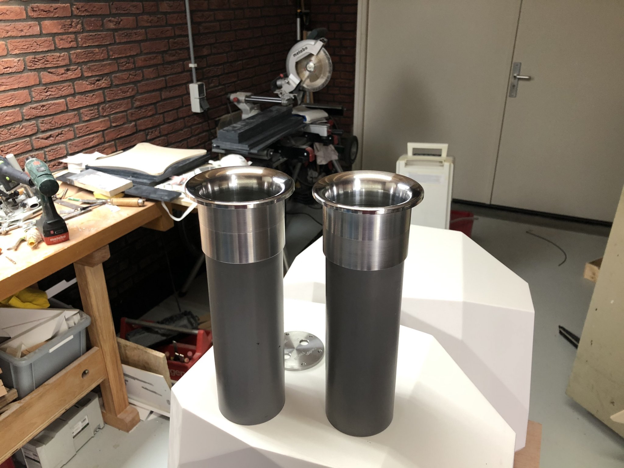

Everything part is made by myself, I own a little cnc milling machine , that make it little easierLove those. Great workmanship. Where did you source the port tubes and binding post plates?
