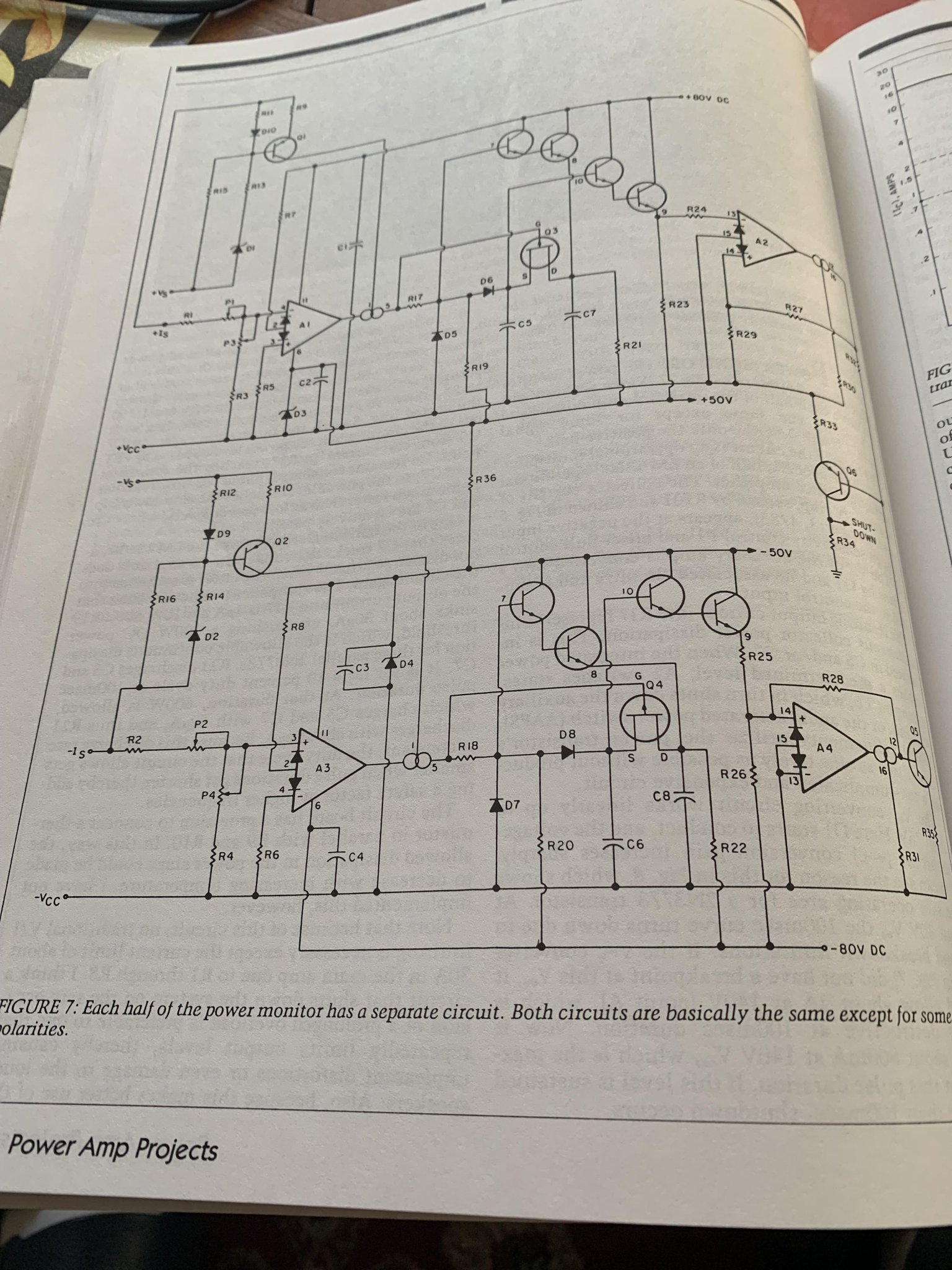

Looong time ago I designed an analog circuit modelling the SOA of output devices of a power amp.
The SOA sim output drove the protection circuit.
Worked very nice; it let anything go as long as the SOA wasn't exceeded, so it automagically took account of load impedance and phase angle.
It was published in https://cc-webshop.com/collections/books-audio/products/audio-amateur-power-amp-projects but I will see if I can find it on my PC.
Of course, these days I would use a controller to do the calculations digitally rather than analog computing.
Can't find it now, but this was the concep:
Cut the SOA in a number of sectors that are relatively straight line approximations.
For each sectors determine the time in us or ms that that particular V*I can be allowed.
If the allowed time is exceeded, shut down.
Continuously calculate V*I which is the instanteneous power dissipation.
Determine which value of the SOA curve is appropriate for the current V*I value, and count down the allowed time.
You can do this with charging or discharging a cap.
All this is done on a continuous basis, so the calculated V*I dynamically adjust the countdown (cap charge or discharge).
Worked like a charm.
Edit: here's the content list: https://www.hificollective.co.uk/books/power-amp-projects-book-2007.html
The articles are the New Power Amp Alternatives duo.
Jan

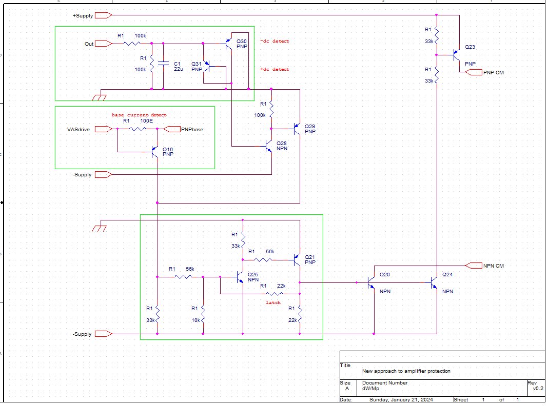

Cool. The schematics here are starting to puzzle me. Thanks! @MarcelvdG @jan.didden
@Easyamp. Just to answer your question on howto make it cut current faster. The way I see it: Each transistor to turn on or off is some capacitance to charge or dischage which takes a little bit of time. To reduce that time, make sure the transistors doing the turnoff can pass lots of current. The higher the current spike, the faster the turnoff. Next just minimize the number of stages it takes before shutdown reaches the power transistors.
Like youre doing its a good idea to latch off the whole amp from the ltp's. Do check how the output responds when doing so! Does it mute neatly when turning off?
I would additionally short the bias of your ops BUT sense current directly from the emitter resistors on P and N sides. (Shortest "turnoff path") This looks like a traditional current limiter lol. Like jan suggested, set these to limit at a high current. Your ops will see a big current spike before the latch turns off the amp. Just implement the current limiter such that we survive that spike. (Said limiter may need some resistors and diodes to make sure it doesnt mess with linearity and turn out to be VI limiter you set out to avoid)
Currently im working on a mosfet relay with current sensing. (Also to avoid the VI limiter) It has a latch that can handle high current peaks to pull down the gates of the mosfets pretty darn fast. It still passes 40 amps for 1us but the OPS shouldcould survive that.
Hope all this helps a little, all the best,
Ruben

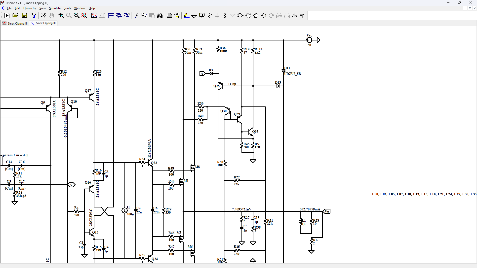

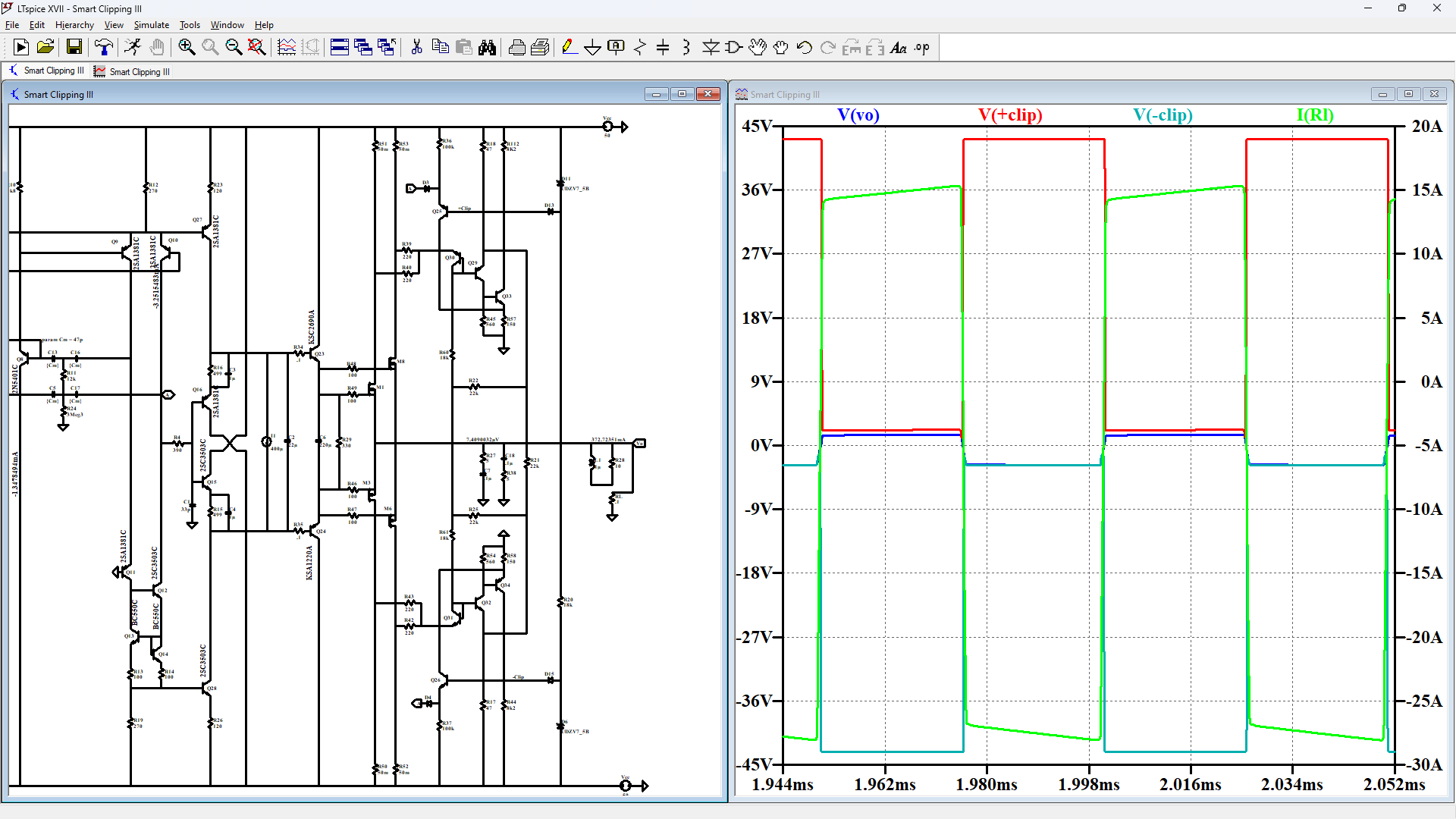

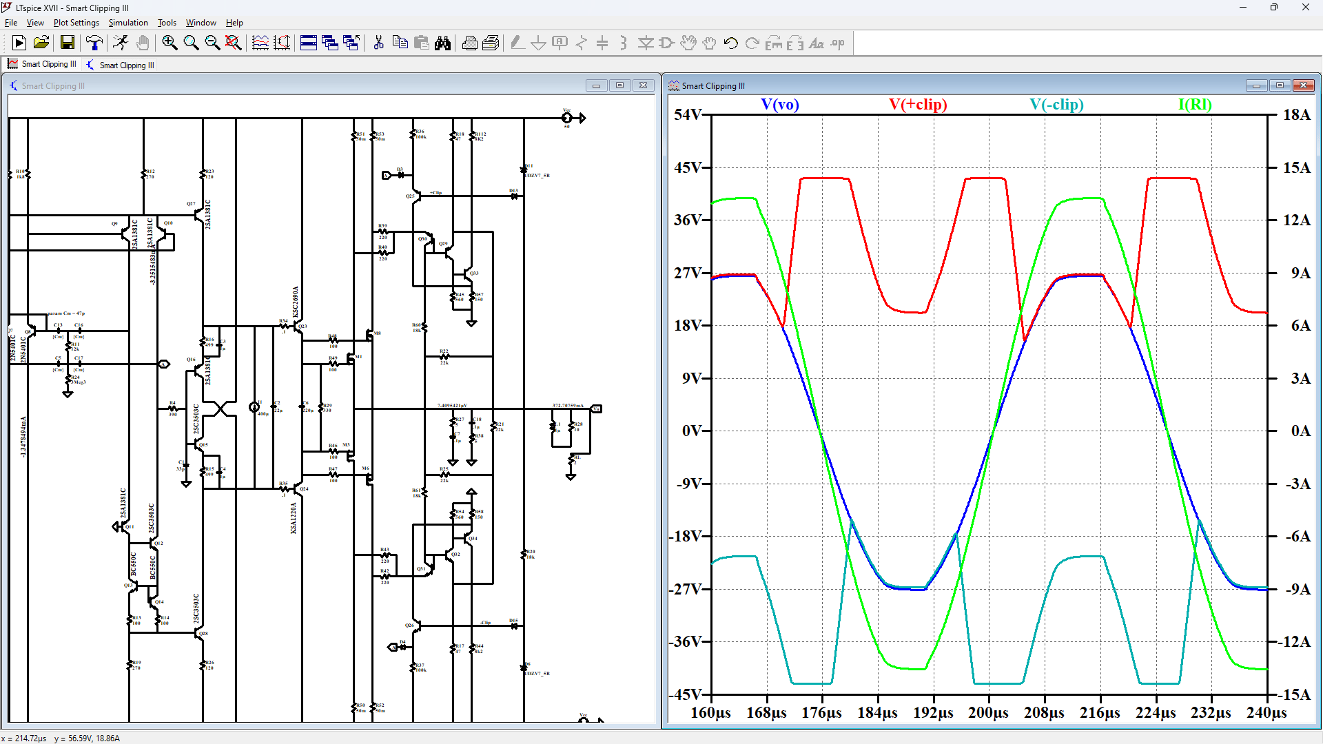

Dead end? How about instead of a somewhat voltage dependent current limiter, you use a current dependent voltage limiter. Suppose the clipping voltages respond to the current through the OPS devices. Perhaps something like this could work. Q29 is sensing output current through the 50mOhm drain resistors and outputs a small signal proportional to output current. Q33 now gives it some gain and develops the clipping voltage over the 8k2 resistor R112. Q25 essentially buffers the clipping voltage and D3 connects it to the VAS output. Values are not final but I like this circuit and Ill probably implement a version of it in future builds.
Cheers!
