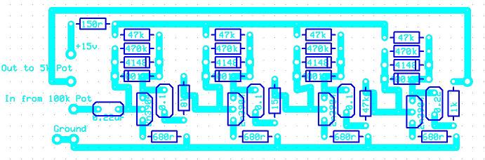

This is the circuit "Minion" is speaking about
Now I play in a hardcore metal/punk band so I thought this could be the perfect first build that I could actually put to use and if I like it I can go on to build a preamp and combine this schematic into it for a gain channel?
I would just appreciate it if someone could help me out a bit and help me read this diagram... Like set me on the right track toward my final goal and stuff 🙂 I'm struggling to work it all out, I'm going to try and draw up a schematic once I understand it better but any help would be gratefully appreciated 🙂

I am useing this curcuit in my Guitar amp for Distortion and it is honestly one of the Best distortion sounds I have ever heard.....
The design calls for 2n3904 Transistors but I found I get a MUCH better sound useing 2N2222 Transistors....
If you want to use it as a Pedal you could easilly add a Bypas switch so you can Turn it on a off by stepping on the Bypass switch and best of all it will only cost about $4 in Parts at most....
I play Heavy death metal and hardcore Punk type music and this is perfectly suited for this type of Music.....
Cheers
PS: the orentation of the Transistors is reversed in the diagram....

I just spent some time finding a program and drew up this schematic, is it the same as the one I posted previously? and are the components accurate? I'm not sure if I even drew it right...
I'm struggling to understand how this works, Its a distortion unit but the potentiometers are only at the input and output? so how does the distortion level change? anyways again any help is very much appreciated 🙂

I expect the pot on the input would change distortion levels, and the one on the output will simply be a volume thingy. I'm not much use at interpretting circuits, so I can't say much else...

Schematic looks OK except for the pots, which are arranged incorrectly...
That's what they should look like. Lower case k is correct but it should be capital R for the resistors.

You did a pretty good job of translating that layout into a schematic. The device uses one of the oldest tricks in the book of guitar distortion devices. That is to use back to back dioded to clip or square off the signal. In this case the designer has elected to put the signal throught that process 4 times. More is better ? right.🙂

Its not a complicated circuit and its repeated 4 times.
Each stage has x10 voltage gain (20dB gain).
TBH for the first two stages the diodes seem irrelevant as there will not
be enough voltage to turn them on. Related to that doubling up the diodes
(in series) on the last stage may help, or using silicon diodes for the last stage
and germanium diodes for the third stage, its an easily tweakable circuit.

PS: those pots are NOT drawn wrong. If you look, they are functioning as variable resistors: hook the wiper (middle terminal) to the input or output leg. The pot can then be turned from zero ohms to the full value of the pot - 5K or 100K ohms. This will behave differently than running them to ground as a voltage divider.

Yes they are, they wouldn't work like that - particularly the output one which would do nothing when turned from end to end.
