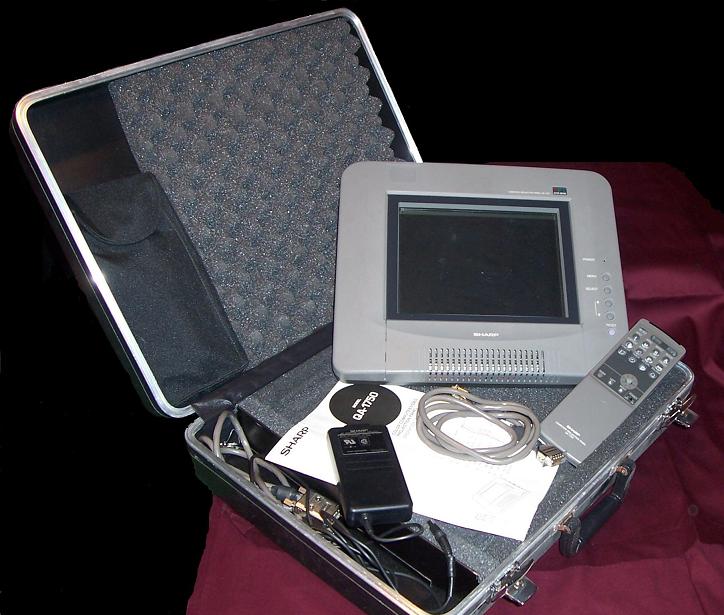

btw where is a good place for ohp panels...i've been sticking to ebay so far...and its slim pickings from there.I have a Sharp QA-1750 if you’re interested. It's only 640x480 (800x600 compressed) but it works well and comes with everything in the picture. I would probably recommend a higher resolution for playing video games but it’s available if you’re interested. rasmussen2179@yahoo.com
Zaner21
edit... sorry forgot pic. 🙂
