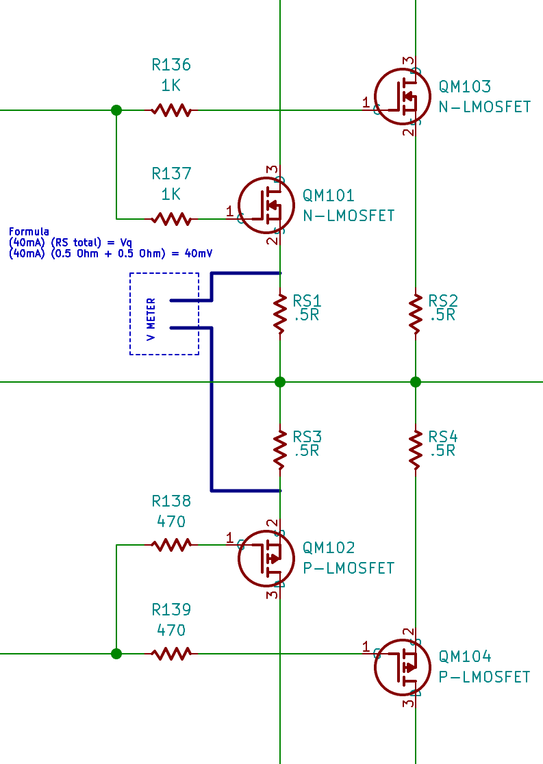

Could you also set the bias without source resistors by shorting the input and checking the current draw from each rail? Seems you could initially set the bias to zero and read the current draw from the rest of the circuit for each rail, then trim it out to the desired bias. If there are multiple pairs, this would assume they are sharing the bias current equally. I assume you could get a ballpark validation of current sharing (or lack thereof) by using an IR thermometer on the case of each device.
Would this approach work?
I wouldn't get too creative in the method if I was anybody.
You can use nearly any resistor type and physical size to temporarily fill in as source resistors for setting it. You don't even need a place on the circuit board for them if you dont insert the source lead. Just temporarily use another resistor. See attachment.
The voltage I use across Rtrim is between 0.85V and 0.89V
That should ballpark you and possibly even be your solution.
Erring here would be to use 0.85V as your low, and using a fixed resistor, it would be okay to get a slightly higher drop.
I do recommend using temporary source resistors to double check your work and secure your mind.
After all this, you can, through multiple test units, come up with a resistance that may work for all of them and everyone else.

I won't call this creative. Nelson Pass mentions this method in the F6 Burning Amp talk paper. When discussing the Power Supply CRC filter, he states:
By the way, you can use the voltage drop across the resistors to measure the bias current of
the amplifier.
Assuming you use a CRC filter in your power supply, you can measure the voltage drop across the filter resistor. If its a 0.1Ω resistor, multiply the mV value by 10 to get your current in mA through the rail. Back out the IPS, VAS and Driver currents to arrive at the OPS bias current.
If you want to try that technique, feel free to do so. I would still double check the results using source resistors initially.
I am only saying this for your own sake, to know for yourself how accurate each method corresponds to another.
Once you know some data, you can do as i do (since I use neither source resistors or CRC), and just measure for 0.85V or thereabouts, across Rtrim.
I just ran a test and checked my Rtrim for both R+L channels and found one to be trimmed to 86 Ohm and another 93 Ohm. So as you can see, a 90 Ohm fixed resistor would do the trick just fine for both channels.
