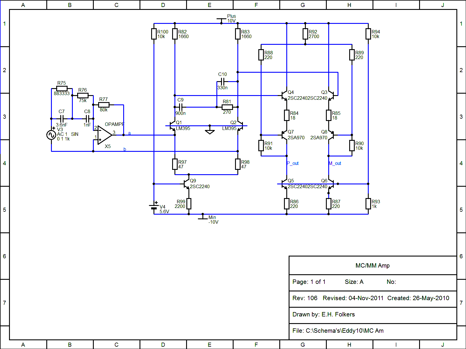

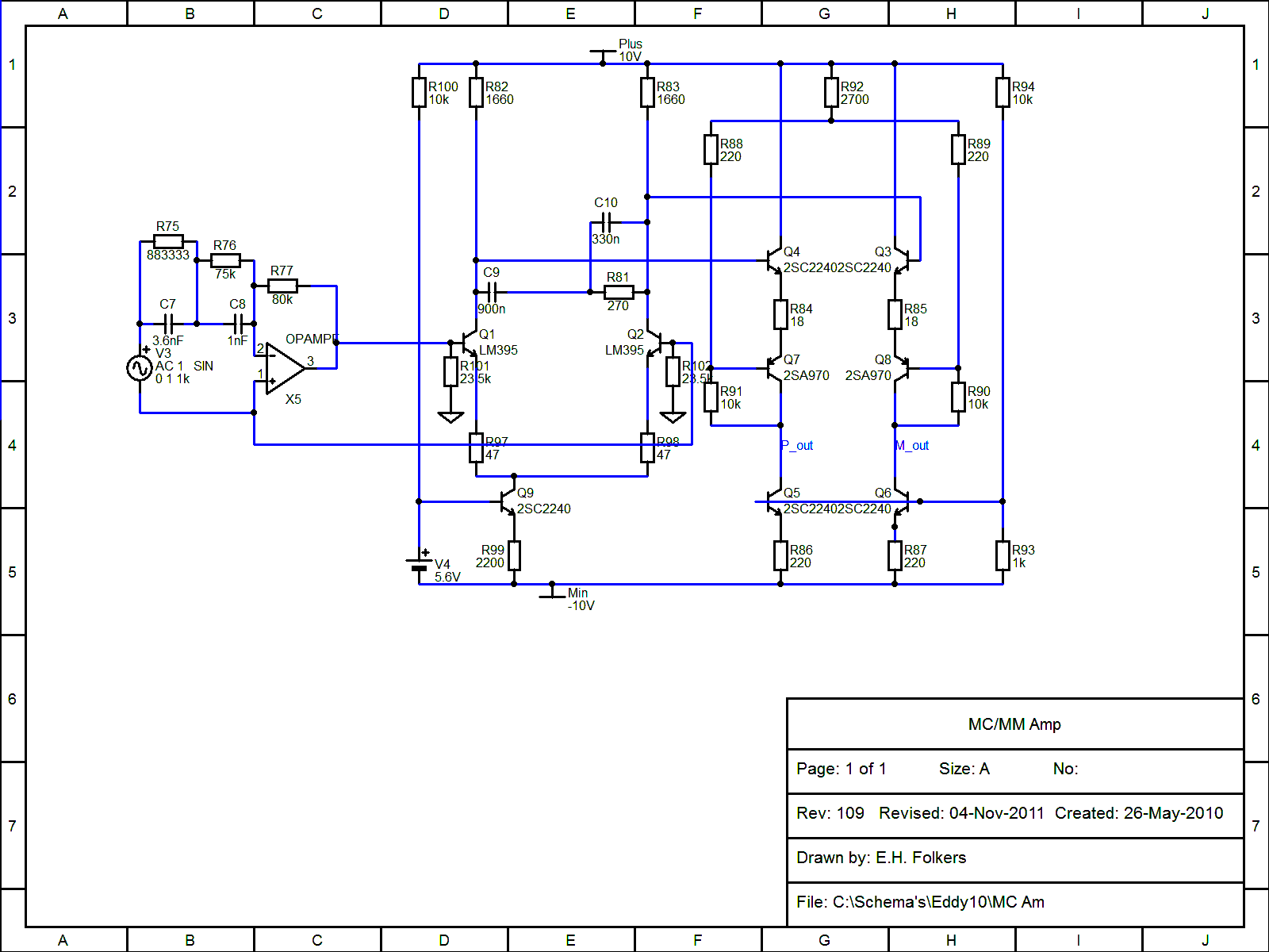

So here is the MC/MM phono-amp. The difference is in the entry-point.
Moving Magnet comes in on the basises of the LM395, wich is an matched dual BJT.
But for Moving Coil, the basises get grounded and the signal comes in on the emitters.
Both versions are shown.
Any matched pair BJT can be used for the LM395 like MAT02 and the like, and for all other transistors any good quality BJT wil work.
On the left with the OP-AMP is the modeled cartridge with anti-RIAA after Lipshits.
The RIAA can also use some tweaking for more precision.
The output, P_out and M_out are ballanced, but can either be used for single ended use.
Happy listening,
Eddy
