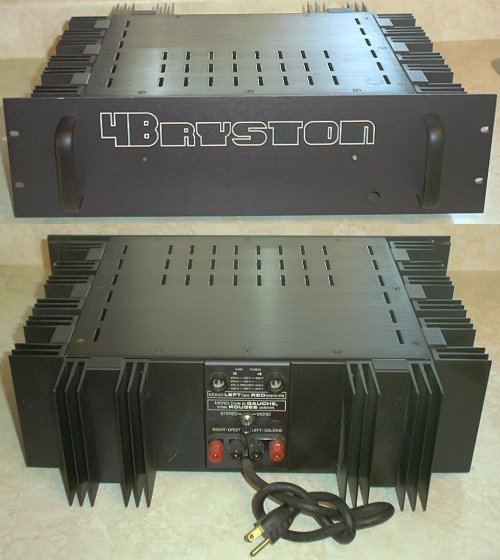

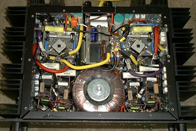

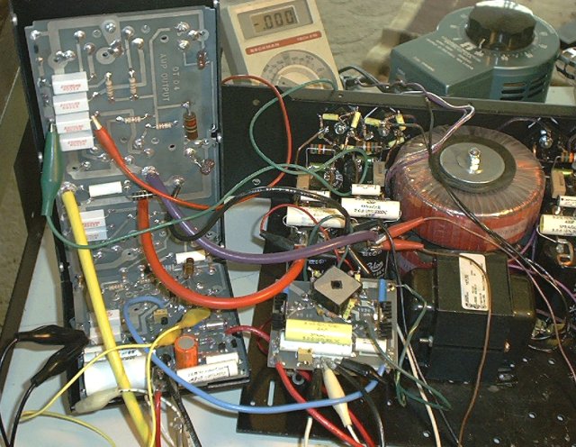

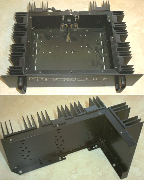

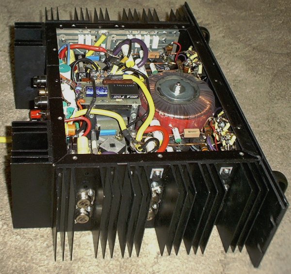

COMPLETED!
OK, I have the first amplifier up and running. 😀
I still have some fine tuning to do, but initial listening tests have been quite positive. The biggest difference between it and the stock PS Audio model Two C plus is in the clarity and inner detailing. With the original amplifier you can, for example, hear the sound of a violin in a recording. With the new amplifier, you can actually hear the tone of the instrument, the sounds of the bow on the strings, and the resonance of the body. The difference is akin to what I'd expect from exchanging a cheap MM cartridge with a high quality MC unit. This is a much larger improvement than I had expected.
Another big improvement is with the bass and dynamics. I expected more authority with the new amplifier based on the higher power output, but the dynamics have completely taken me by surprise. Loud transients, like percussion, appear to almost jump out at you, and sound much more realistic. Even with casual listening this is very noticeable, and can be a bit scary if you're not expecting the sound of a live drummer in your listening room.
Other than that, the soundstage is a bit wider and better defined, with more space between instruments, and much more depth. As well, with the parallelled output devices and larger heatsinks, the amp runs very cool, unlike the original design.
Overall, the new amplifier is a whole lot more musical and listenable. Swapping back to the original amplifier, it now sounds like a cartoon image instead of the real thing. The difference is simply amazing.
Anyways, here is a pic of the completed amplifier:

How can we be sure this is not the original Bryston parts ?
Sorry, i couldent resist, it looks so well made😎

How can we be sure this is not the original Bryston parts? Sorry, i couldent resist, it looks so well made
Thank you for the compliment!🙂 Actually, a real Bryston looks quite different than this on the inside!
