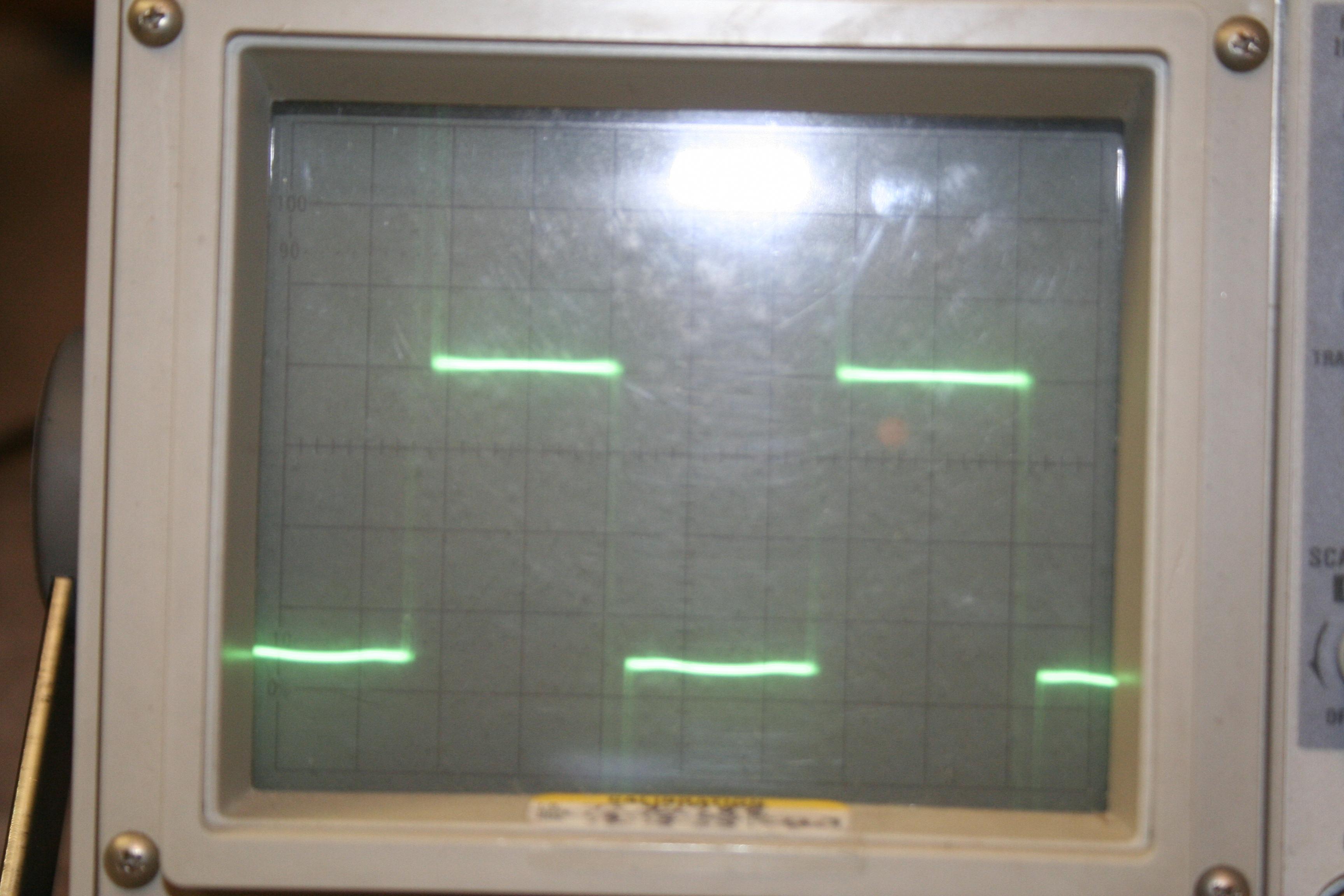

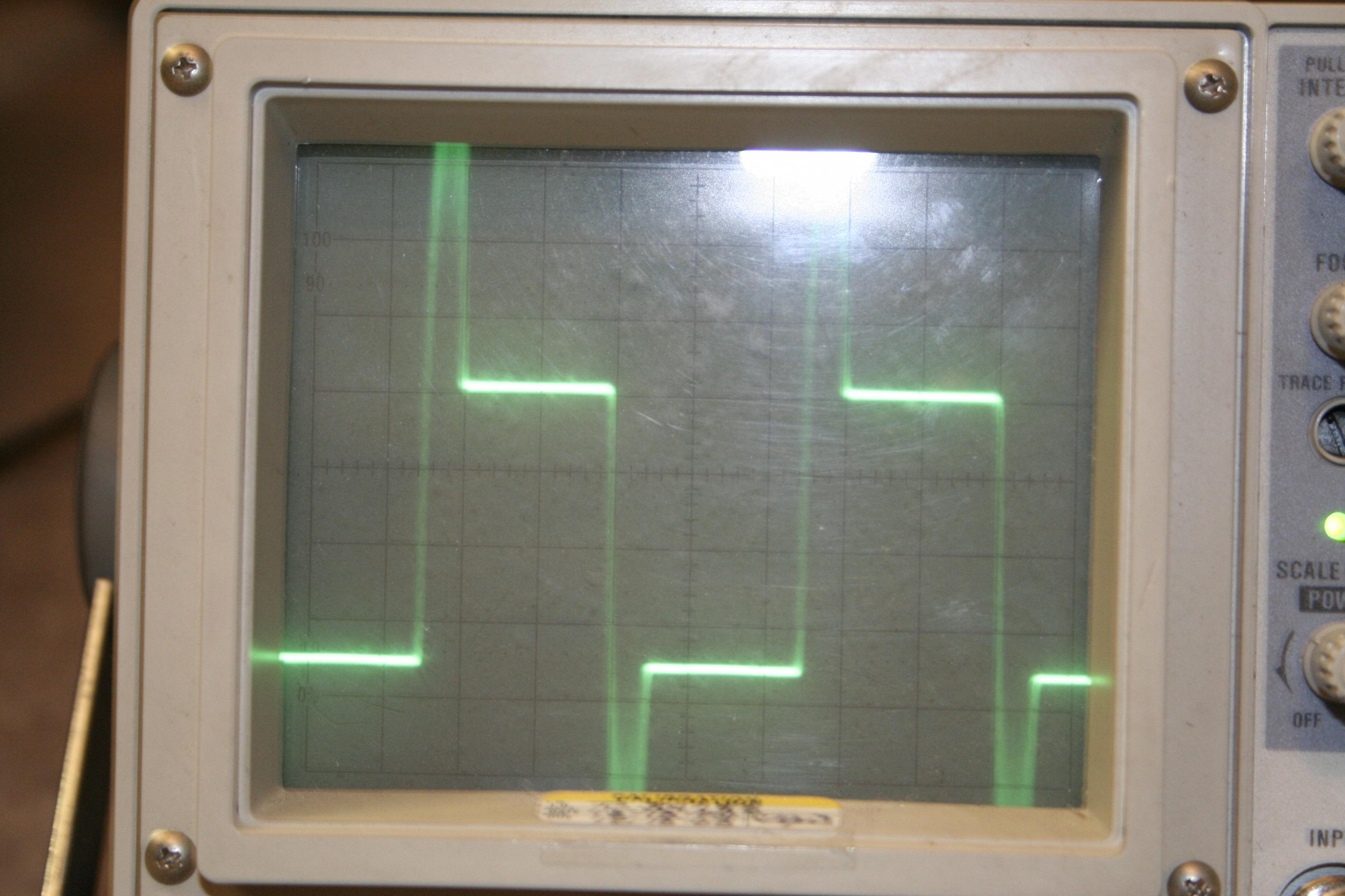

Continued testing:
Well I couldn't add just a resistor across the Bases without constant oscillation, but I did scrounge a package of paper/oil caps that are 0.22uf, so i put one of those across it by itself and it does seem to increase the point at which oscillation starts. I.E. its seems more linear now.
For instance, it almost looks stable under an 8ohm load now with almost all input, awesome! 😀 I tried it with a few waveforms, a nasty square and sawtooth, as well as a clean triangle and sine. They all followed very cleanly at 8ohm up to the computer output voltage, more squirmy like before at 4ohm.
I can see with the multimeter that the voltage is not very constant across that cap when playing music, so it apparently needs to be a bit bigger. I assume the idea is to get the bases to be at a mostly constant voltage offset.

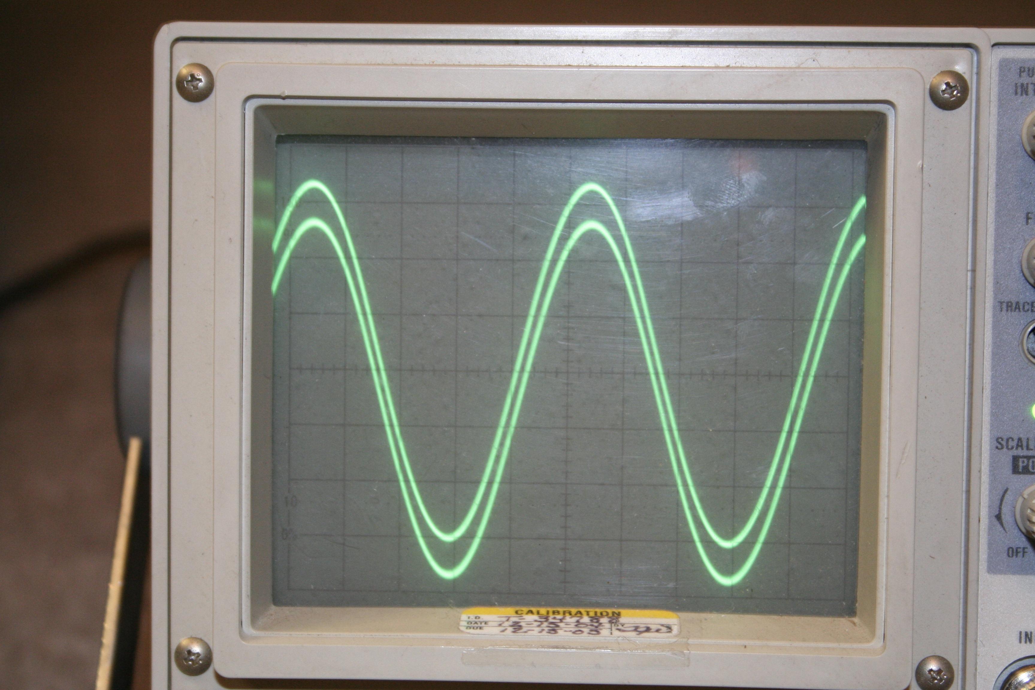

ok so the noise won't go away with the scope I have, I can deal with that. Do you know of any methods to use an oscilloscope to measure distortion? Any way to get an idea of the THD? On my scope, using the setting that fits the signal across a full screen, I am hard pressed to decifer it from a pure sinewave, I.e. No visible distortion to me.
when I invert the signal and add the output the gain is not an exact ratio on my oscope so I have to vary one of them to minimize the difference and I generally get a much smaller sinewave. If I zoom in a few times, around 5 or 10 I can see what seems to be a sharper signal (not sinewave) but I can't figure a way to change it, playing with the bias doesn't seem to make it change.

No low distortion is not possible on a scope because the noise floor is greater than the distortion. The typical 20 MHz scope only goes down to 5 mV/div. The reason is because of the bandwidth of the vertical amplifier. Noise power is proportional to band width. So the only way to reduce the noise power is to lower the bandwidth of the vertical amplifier. Secondly, the scope would have to have a band pass filter that could selectively capture the harmonic(s) of interest.
Some specialized scopes have a feature to lower the bandwidth so noise measurements are possible down into the micro and in some cases even the nanovolts. Filtering the input to the vertical amp will help some but only for the external noise not the internal noise. This is the nature of general purpose scopes, wide bandwidth.
You can view the residual output from a distortion analyzer on a scope.

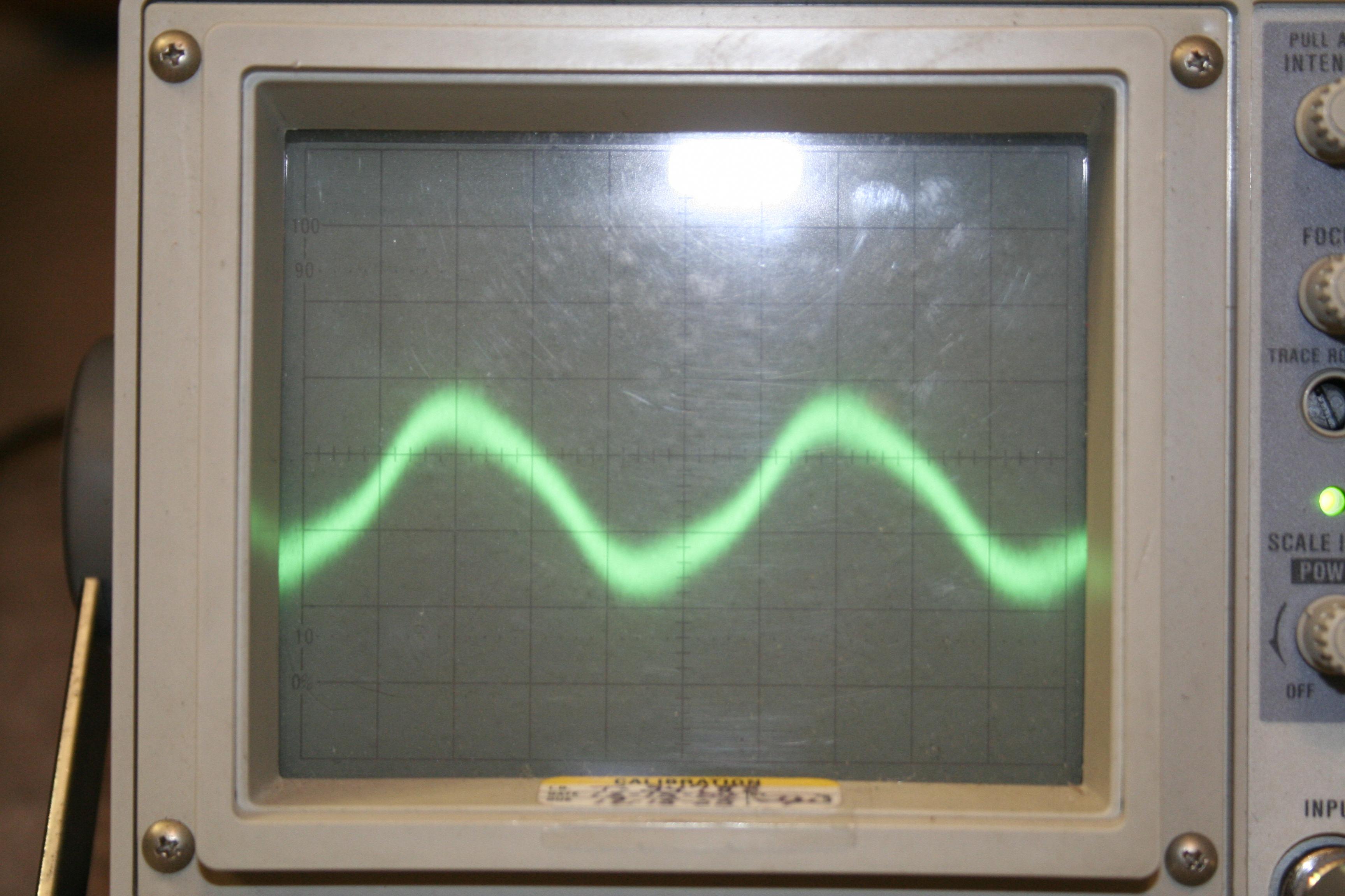

Ok so I hope to get some input based on these photos I have of the output, I don't know if its just crap from the oscilloscope or its actually from the amplifier.
I have the output on x10 and the input on x1. Simple signal, just a sine wave. I think its a 1khz. I forgot already 🙁
I have a picture of the input and output signals matched as closely as I can with the variable voltage adjuster.
Then I go down to 10mv, subtracting the two signals.

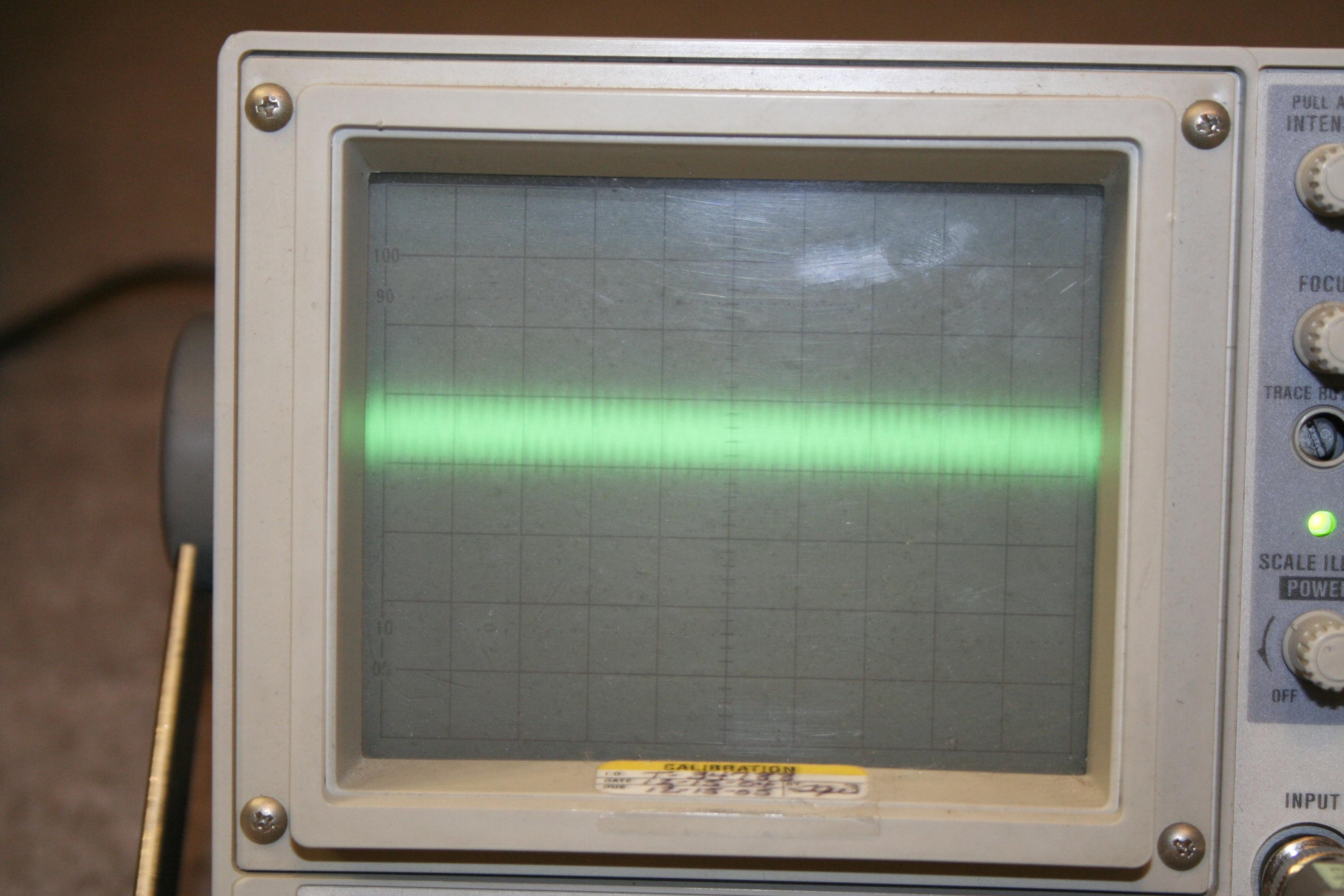

Then a picture of 1mv with the input unplugged from the computer (background noise or some cheap idea of it) I probably shouldn't have left the subtraction function on, but that's what I did...
The problem I have is that when I decrease the voltage increment, the picture stays about the same size, wtf is up with that? I dunno what to think.
