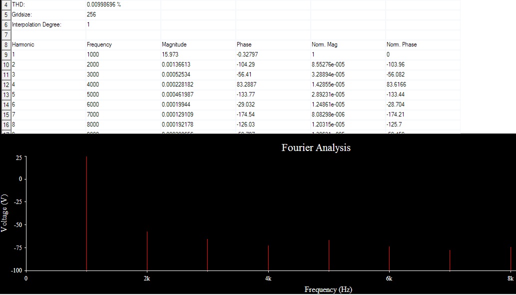

I'm sure it sounds good... it's ended up very like the "blameless class b" of Doug Self.
Q1 and Q2 ????? 100MA devices... that's asking for trouble... and the result would be burned out speakers.
Edit... what is your thinking behind C8 and C12 ?
Without c8 and c12 the amp oscillate's.
it limits the current source
And the bc107c and bc177c can handle 200Ma collector current and they are cooled so they can handle 0.65w collector dissipation.

I'm not trying to sound critical... and I would hate to see you damage or destroy a good pair of speakers because of this.
The BC107 is 100ma collector current (maximum continuos). 200ma is specified as a peak current... my data doesn't seem to specify the time duration, but I'm sure anyone reading this will confirm that they are not robust enough for drivers.
At full output into say 4 ohms have you simulated (or measured) the base drive requirements of the output devices. Remember that current gain in the outputs will drop off at higher levels of collector current (beta droop).
bc107 is a 45Vce0 and 100mAIc device.
It could act as a driver to a 1 or 2W headphone amplifier.
It is unsuitable, as driver, for an 8ohm speaker amplifier.
C8 & C12 when fitted usually connect between supply rail and base, not collector and base.
Yes i know about beta droop but still 200x40= worst case 8amp of drive
see the picture the Cdil datasheet says 200ma continous.
and these are Cdil and MEV devices.

I'm going to add something else now... I looked at your data for the outputs... and 4 amp maximum collector current again isn't really enough. You have to imagine all the worst case scenarios, switch on surges, switching on with the volume turned fully up... a momentary short on the outputs, and of course a reactive speaker load. Transistors suffer from an effect called secondary breakdown where they fail suddenly even though the ratings might suggest otherwise. This usually happens at collector currents near to, but below the maximum rating and at highish VCE voltage... it's a well known effect.
Your amp has no SOAR or safe operating area protection to guard against this.
Don't take it as a critisism... try and understand why they are not really suitable.
Yes for lowish domestic listening you will probably get away with it... but take the design further... try and anticipate all that could happen and design against that possibility.
using a +-20Vdc supply will take the drivers to a maximum 40V + mains and transformer voltage tolerance. That's about as high as you dare take a 45Vce0 device.
Using an 8ohm speaker from +-20Vdc requires a peak resistive current of ~2.2Apk.
Into a real speaker load allow for 3times this or ~ 7Apk on short term transients.
If the hFE of the a768 remains at 40 then the worst case base current would be ~170mApk and this must be supplied by the driver.
It is more likely that worst case current demand from the driver could be as high as 300mApk for a reactive 8ohm speaker.
a768 and bc107 do not work for an 8ohm capable power amp on +-20Vdc supply rails.
if we get 18Vpk into an 8r0 load then maximum power is ~20W.
Typically you would need a pair of ~60W devices to survive this duty.
i agree on the output transistors but again but this a 15 watt amp max and it is designed for this goal see all other components.
so the devices will suffice.
