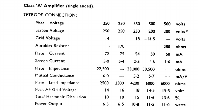

From the STC 807 report (attached) the THD is quite high, as is the case for all SE pentode amps. Making the plate load lighter than specced will improve harmonic performance somewhat at the expense of output. The 807 will require gNFB to clean up the mess, and to provide for speaker damping, which pents don't do well due to the high rp. The 807 also likes to make high order harmonics and open loop sound very harsh. Screen voltage regulation will definitely improve the performance. VR tubes are good, but an active screen voltage regulator will be better still. You avoid having to run so much current through the VR tubes, and keeping the current down improves regulation, and reduces the heating.

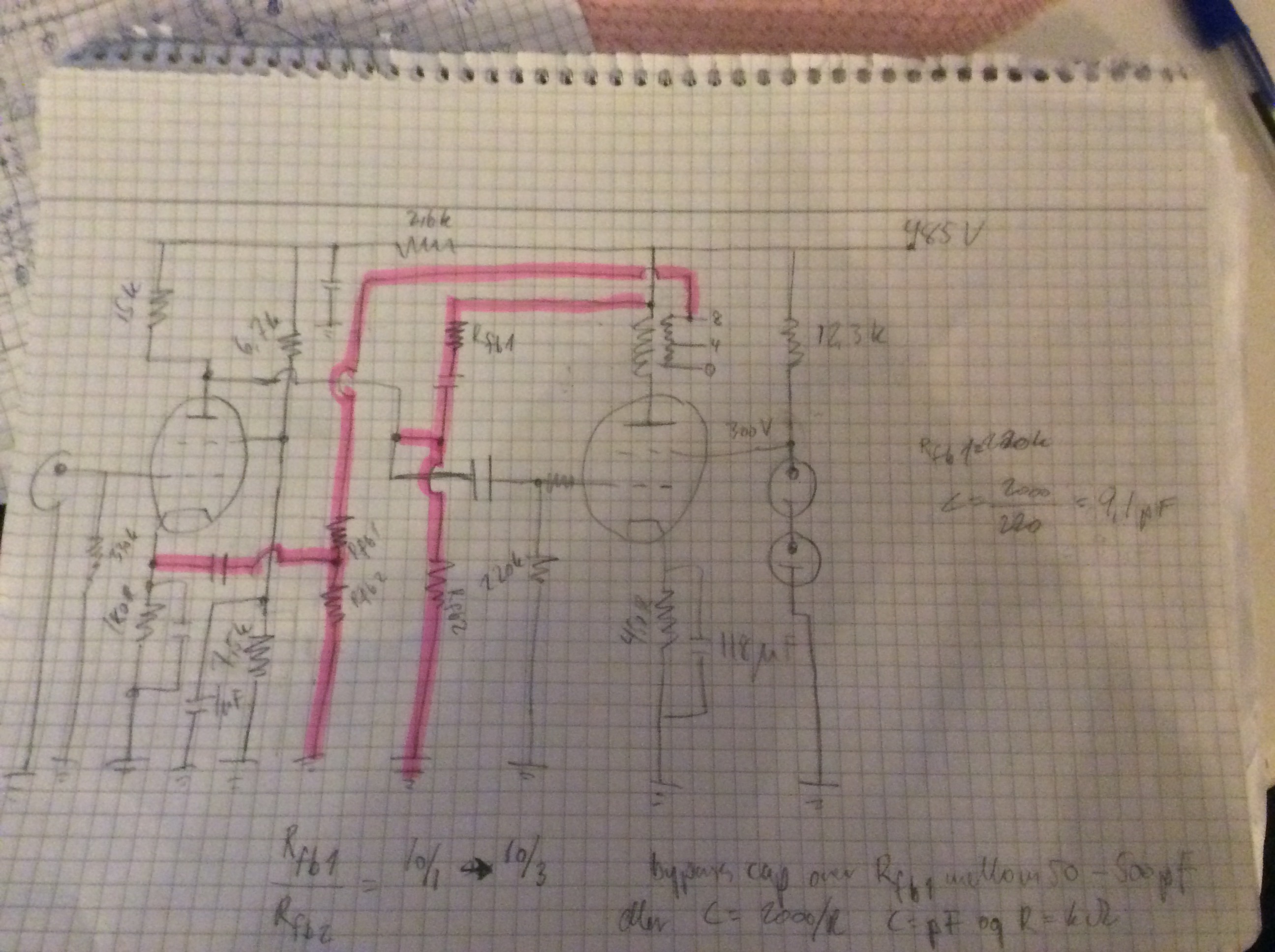

Used anode-anode feedback (Schade?) but I might experiment further with gNFB. I like the sound of it as is, but it should be a quick experiment so why not.

1. For the Schade feedback, you do not need the feedback resistor that goes to ground.
The rp of the input tube, in parallel with the RL of the input tube is all the feedback divider you need (Rf resistor and Cf capacitor drives the parallel impedance of input tube rp and RL).
The capacitor Cf will cause a rise of gain at low frequencies (less negative feedback as the capacitive reactance of Cf increases at low frequencies).
Some Schade circuits use that cap, but many do not. If there is no capacitor, then the feedback resistor Rf becomes an additional source of current to the input tube plate.
Some readjustment of the plate load, RL, may be needed.
You may want to raise the impedance of the input tube rp, you can do that by taking out the input tube bypass capacitor; but that will reduce the gain, even before you apply the schade feedback.
You can do a partial increase of the input tube rp, by splitting the 1k cathode resistor, and putting the bypass cap across only the top resistor. Examples are: 500 Ohm and 500 Ohm in series, or 900 Ohm and 100 Ohm in series. Bypass cap across one 500 Ohms gives less gain than Bypass cap across 900 Ohms.
2. For the global feedback, the input tube cathode bypass cap is shorting out the feedback signal from the feedback resistor.
Instead, take the value of the input bias resistor and divide it.
The input tube bias resistor is 1k. Instead, use a 900 ohm resistor from the input tube cathode in series with a 100 Ohm resistor to ground. Put the cathode bypass capacitor across the 900 Ohm resistor, and connect the feedback resistor, Rf, from the output transformer, to the junction of the 900 Ohm resistor and 100 Ohm resistor.
Have fun trying different circuits and listening.
