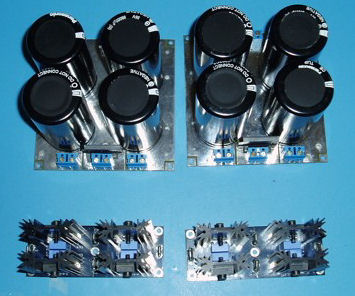

New Aleph X Power Supply Boards. Rectifier boards are from the Big Parsnip Group Buy with Mur Fast Diodes, Heatsinks and Snubbers. The Filter is a simple C filter with (2) Panasonic 56000 uF @ 35 V capacitors per rail (112,000 uF per rail) Terminal Blocks and a ground breaker bridge. The filter board is my own design and is double sided 2 oz copper.
