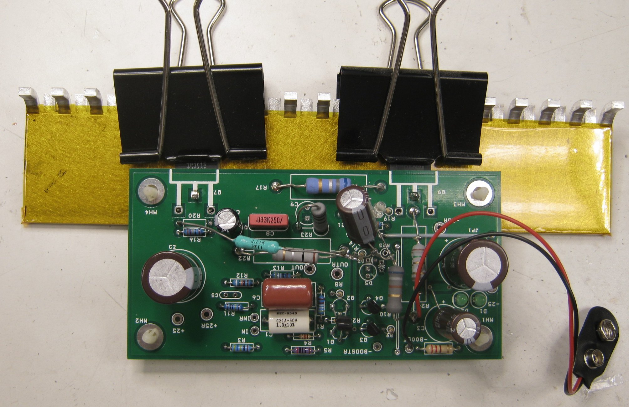

A while back (quite a while, actually) I posted a Class A design using an Ixys depletion mode fet as a substitute for the usual Aleph top side modulated current source, I actually had some boards done back when I was still using OSH Park for board fab (yes, they're purple...). I've returned to that design with a different scheme for biasing the topside current source. Attached is a picture of the partially assembled board waiting for a matched diff pair front end and some selected output mosfets. More action on this may happen over the weekend. When I get home, I'll post a prelim schematic (it's on my home computer).

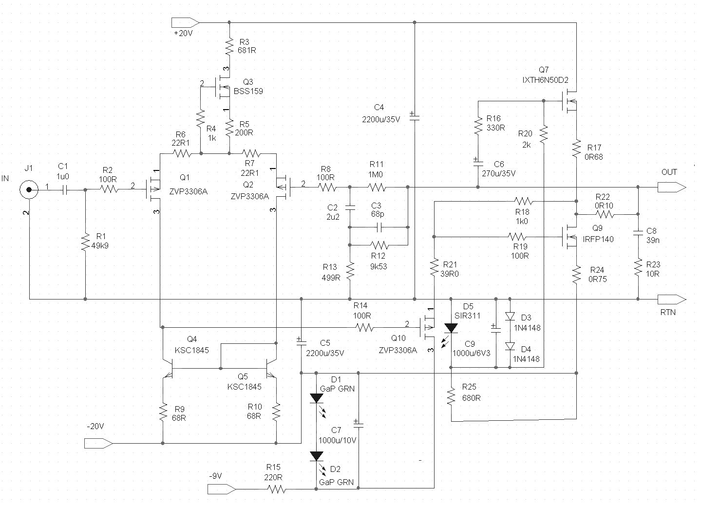

OK, here's the preliminary schematic for the new board. The SIR311 is a GaAs IR LED made for purposes of illumination, available for cheap at yer favorite auction site. Anyway, I will be making a couple of mods to get around some issues I noticed after I got the boards back from China. I'll be doing some tuning with a couple of current probes to optimaze the value of Aleph current sense resistor for symmetric drive.
