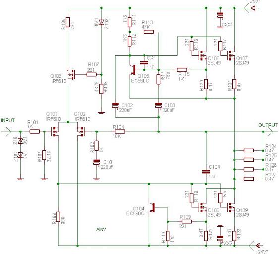

I may well just try building an aleph using about 12 2sk134 TO3 mosfet as per moamps effort etc.
But that leaves me with 12 of 2sj49 mosfet (compliment to 2sk134) to find a use for.
any suggestions?
Can "a negative" version of an Aleph be built with these-
you can probably tell i'm possibly getting out of my depth.
Apologies Mr. Pass... you must be shaking your head.

What about ZenV5?
It´s complementary design, very simple and you could lower gain, parallel devices and add aleph input stage or whatever you like.

Thank you all for your replies.
Moamps , did you just happen to have the schematic lying around?
The Pos & Neg monobolc idea also passed through my mind, I wonder if they would sound different (mirror image..)

george a said:Thank you all for your replies.
I have 8 pcs. 2SJ49 too. This schematic was like idea in my head long time. Today I was checking my drawing skills. 😉
I wonder too.
