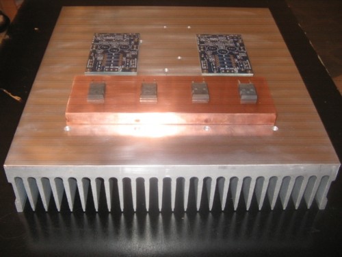

A question about heatsinking --just how much watts of heat does one channel produce from a 16V transformer? My rather small .75 C/W heatsink gets too hot for my liking. Is one channel just producing excess power because of the missing 2nd channel?
I think that I might have to use one .75 C/W heatsink per FET if I don't use a fan.

Assuming 16VAC secondaries, I would guess
the final rail voltages to be around +/- 21V DC.
If you're using the basic 1A bias then you
can expect som 40+ watts of dissipation per
channel.
Naturally cooler is better as far as heatsinks
go. Can you touch the heatsink for at least
a few seconds. If so, then the heatsinks
are acceptable warm.
Dennis

Thanks, Dennis, I can touch them for at least 3 seconds before feeling too uncomfortable. I guess I'll use a low-powered fan for now.
Hi Applebook,
Have you been running that channel with the heatsink
facing down as shown in the picture and you can still
touch it for a few seconds?
For maximal efficiency, the heatsink should be vertical,
with the fins going in the up/down direction. Also,
it looks like you have the output mosfets mounted in
the direction of the fins. Please consider remounting
them in the other direction (rotate setup 90 degrees)
and have them a little further up from the bottom
of the heatsink; about 1/3 of the way is ideal.
Dennis

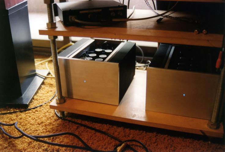

spzzzzkt said:One really dodgy photo of 2 x Aleph 30 monoblocks 🙂
cheers
Paul
What is the overall WxHxD dimension of one block?
