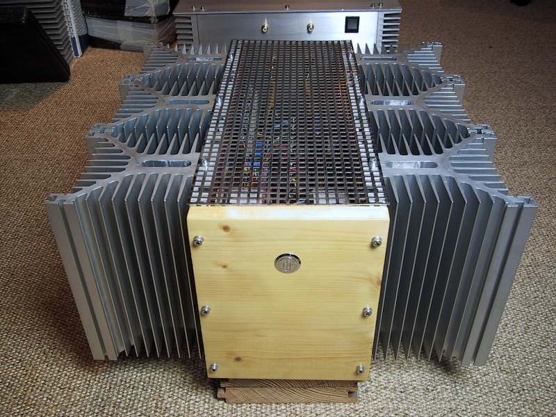

Variac said:The cast surface does have a Lot more surface area than a smooth one. So, maybe that helps. I have to admit that they do seem to always be smooth commercially. I wonder if a very slow fan would make the cast one better than a smooth one with the same fan?
The rough surface does indeed give a larger surface but the cooling effect is smaller due to the air molecules locked in the roughness. Using a fan and making sure that air flow is not even but rather as turbulent as possible would probably help. At least this is the way I understand it. That is however completely unrelated to my sincere admiration for the nice work and craftmanship...nice.

Did you use sand cast foudry? If so Why not make real kewl heatsinks with some kinda drawings or letters(with the fins)??
Good point but I was only interested in having a good functional sink. In the other hand, the more complex your pattern the more difficult to sand cast a good looking part.
Pricewise I think these sinks cost less than a simillar commercial part, if you find one.
I appreciate you comments, it's allways nice to hear others comment on your creations even if it's a clone.

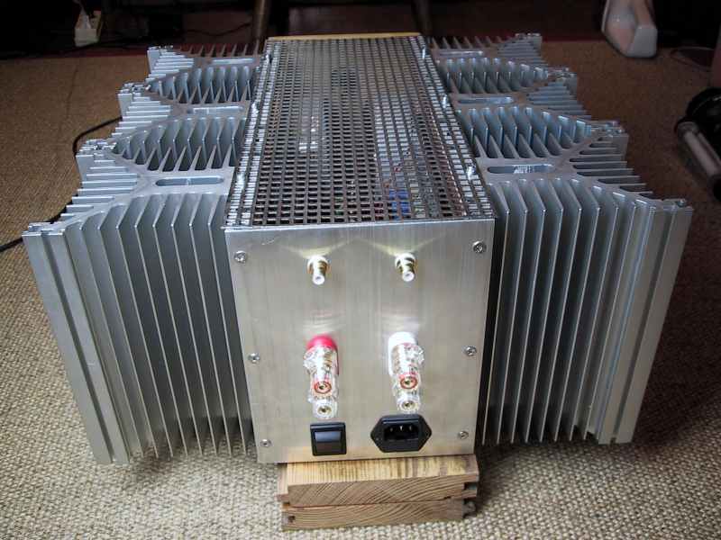

Ur Sv: I am sure you are right about smooth being better. If air were trapped in the surface it would act as an insulator. Of course if you are making your own, you can just make 'em bigger!
Better start saving my drink cans.....
I once saw a demonstration by a guy showing an easy way to cast aluminum. He made a coal fire, let it get burning well, then directed the output of a vacuum cleaner as a blower to make the fire really hot. He could easily melt about a cup of aluminum in a steel pan set on the coals (the blower was on continuously). I'm sure with time a lot bigger amount could be melted.
My understanding is the wood pattern is pressed into a box of sand mixed with oil. The sand is then packed tightly around the
pattern, then the pattern is removed leaving a cavity which the aluminum is poured into. It helps removal of the pattern if it is designed so the fins taper in width. Since the pattern fins would be pressed downward into the sand, the thick base would be flush with the sand surface. The base of the finished heatsink would need to be pressed on a belt sander to make it flat.

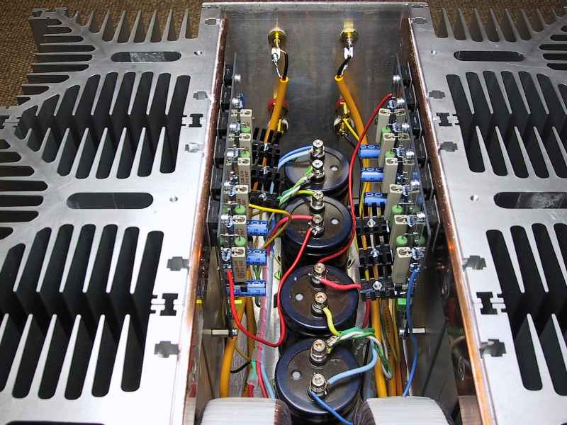

apassgear said:1/137
PSU has two home brew trannies rated at 750 VA each. They have a stack of a little more than 3" of EI 150 2% silicone laminations. I'm using only one diode bridge though. Caps are 6x39Kuf, total of over 230Kuf for both channels.
Since i had hum at the speakers I decided to make a CRC filter, so I separated the first two caps and added four power wire wounds at each rail, 4X3.3 Ohms in parallel, I usually go overboard with power disipation on resistors, these are 10W each and needed only about 8W total. After the Pi filter was added hum disapeared from the speakers. If you put your ear inside the box near the trannies you can hear some noise, so nothing to worry about.
Rails are at +- 50V. I do have some imbalance, about 1 V from rail to ground but does not cause any trouble.

The foundry I go to is a very simple setup, low tech furnaces (shop made) but as always it is somewhat involved in the way they have to clean the molten alu and the way they prepare the sand. They add bentonite and other things to the sand and when they want a good surface casting they powder some construction cement to the surface of the sand mold.
Actually they don't use oil in the sand mixture, they only add water to get a certain humidity that will "hold" the sand mold.
They don't press the pattern into the sand. What they do is lay the pattern with the fins to the top (in this case) over a bed of sand, then they put a steel frame around the pattern and start pouring sand over the top of the pattern while they compact the sand until they reach the upper level of the frame. Next they turn around the frame with all the sand and pattern attached and extract the pattern, powder the sand with cement and tun it around againt a flat bed of sand and they are ready to pour the molten metal. There are other things they do such as providing a feed entrance for the metal etc.
