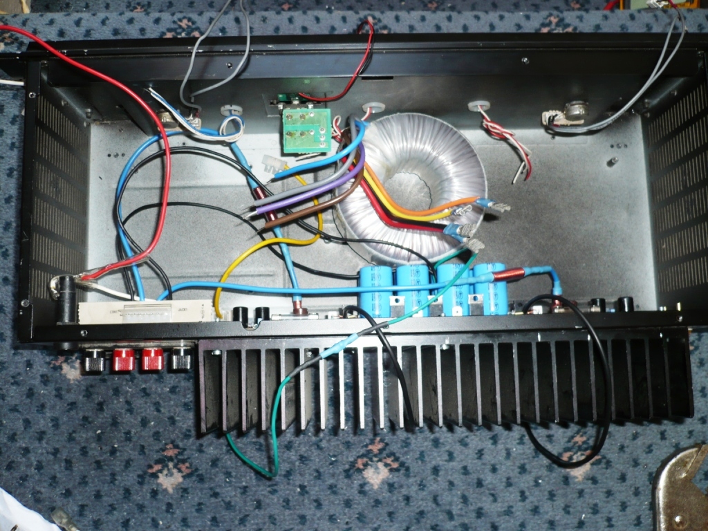

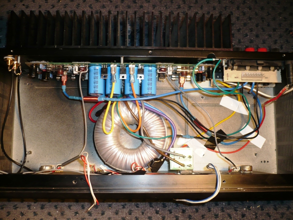

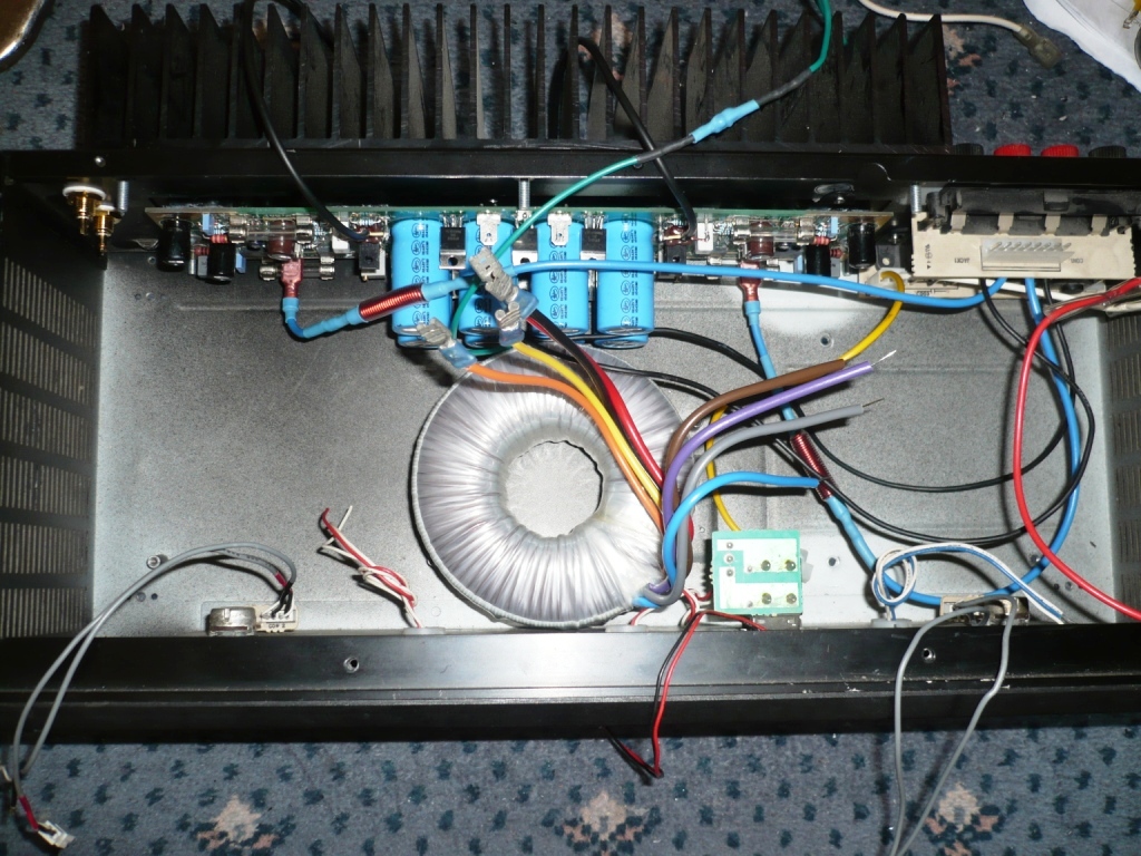

Now a question: Is this xmfr too close to the pcb & should I mount it on the right hand side which is where the speaker outs & PS in are?
The first pic shows the Naksa mounted, On the back panel, the RCA inputs are on the left of the pic; the speakers out & PS-in are on the right. On the front panel the grey wires are the in & out to the two pots left & right. The wires tied in a knot are for front panel leds which I will attach for left 7 right channel.
Prof smith - see first post for link.
From my experience, transformer induction is audible but I have never gone extreme in the implementation. Many have used grounded copper sheet/plate to shield the transformer. I used steel plate in my latest amp project.
Transformer orientation seems already okay. Position is of course better on the right because it is farther to the line level input on the left. But I prefer physical balance (transformer in the center). Attention to detail, when required, can be done with the shielding.
Thanks Jay, yes I guess I can go with this without drilling & bolting down the trafo just yet. I will be re-visiting the layout anyway to implement lightspeed vol controls that why I'm not so worried about the crap vol pots

Just about finished - everything done except the leds to be connected ( these are the wires hanging over the front - there are 3 wires for two leds on each side - I'll only be connecting one led each side.)
This turned out to be a really neat fit for the Naksa board. I will look at an LDR lightspeed vol. control & also maybe re-doing the front panel into something more suited to the hopefully high quality sound of this amp - if it sounds special, I want to make it look special. Any ideas?
I will be powering it up tomorrow.

The trafo at the centre of the board is just fine, a toroid has minimal external field at low power anyway, and at high output the amp will still preserve a high S/N ratio. I would always prefer to have the toroid on the other side of the heatsink, but this is not always possible. You can secure peace of mind with a thin, ferrous metal shield between the filter caps and the toroid, however, that's always a useful option.

Personally I'd say leave it where it is. I do have problems with toroidal induced noise on my series 200, though it is probably worse because the toroid is under the pcb. (I know it is noise from the torroid, because a lead sheild cuts it a lot, and taking it out of the case completely removes the noise). It is under the right channel and the noise on the right channel is worse, which is why I suspect in your case putting it in the center radiating towards the PS is probably better. I would think the PS would be less lilkely to pick up noise than the amps.
If you do find problems you can try rotating the torroid, I've been told that they don't necessarily radiate evenly and that rotating them can send the emi away from the circuit (not sure if this is correct or not).
The torroid in my Chip AMP is VERY close to the chips but I have no problem with noise at all, the orientation though is that the p2p amps are at right angles to the torroid which is mounted vertically.
Tony.
Thanks Hugh & Tony,
Yes another option, if needed, would be to mount the toroid on it's side at the front panel but we will see how this configuration sounds first. I'm waiting until tomorrow to apply power as I'm tired now & I want to start fresh in the morning with the sound.

A quick suggestion on toroidal installation: Convention has it that the area from which the leads exit is the highest radiator of EMI. It is also encouraging to be able to just rotate a jury-rigged trafo to the lowest measured hum position.
However, unless you have adequate safety precautions and good nerves, locating this side and the diode leads to their furthest point from the amp's input stage and signal wiring will also have a very good chance of avoiding obvious EMI. 😎
Hi folks,If you do find problems you can try rotating the torroid, I've been told that they don't necessarily radiate evenly and that rotating them can send the emi away from the circuit (not sure if this is correct or not).
this is worth doing......................able to just rotate a jury-rigged trafo to the lowest measured hum position.
A dmm set to mVac and the input RCA fitted with a shorting plug shows this up.
Your transformer leads look like solid core. Better if they are flex leads, more flexible and resistant to breaking.
But do make sure the mains connections are well insulated.
