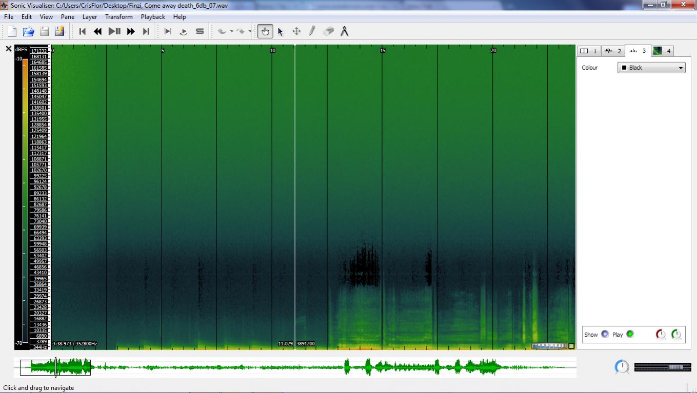

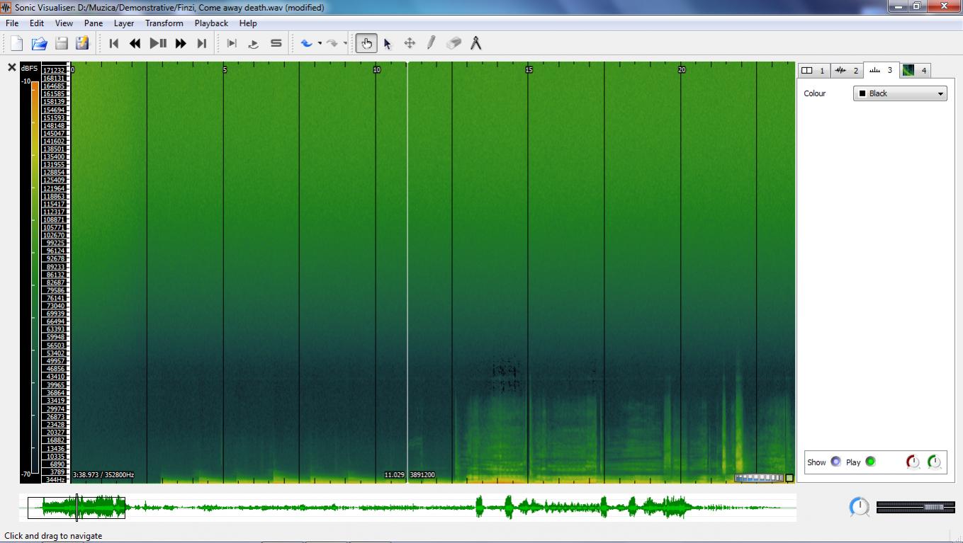

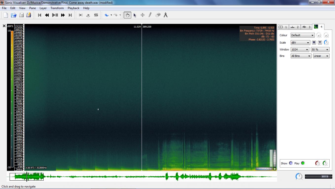

Hi all,
I am coming back with some spectrograms.
1. 352.8k DXD file, plays with audible noise
2. 352.8k DXD file above, low passed with a second order filter at 20k, plays with no noise
3. different 352.8k file, plays with no noise.
4. 352.8k DXD file, the same as the first two, this time low passed with a 1st order filter at 20k - I get audible noise on this.

A short comment on the spectograms above. At the risk of sounding like a broken wheel, I believe they support my findings.
1. the genuine DXD file has a large noise content up to 170Khz, as expected. I will compare this to a master 192Khz file I've been informed it had been recorded at this sample rate to check if it has the same noise distribution. I believe it won't.
2. the low passed DXD file has little information above 20Khz, therefore no audible noise effects. Ofcourse this is not desirable as there might be relevant audio information up to 40Khz. I don't know what to believe about the idea that content above 22Khz has any importance in the audio band however the bandwidth has an impact on the impulse response and this is a reason good enough to perfect 352.8Khz playback in my system.
3. the first 352.8k I played in my system (with no noise), was sourced from a site or recording studio I can't rememebr of. I can't explain the sudden low pass at 88Khz. I believe it's either an upsampled 192Khz file, either a genuine 352.8Khz recording which employs a very sharp low pass at that point.
4. A shalow low pass (6db) on the DXD file lets some amount of noise density in the high frequincy area. I believe this noise interacts with the DAC and produces the noise/hiss I hear in the audioband. This noise is fainter in intensity than on the original DXD file.
