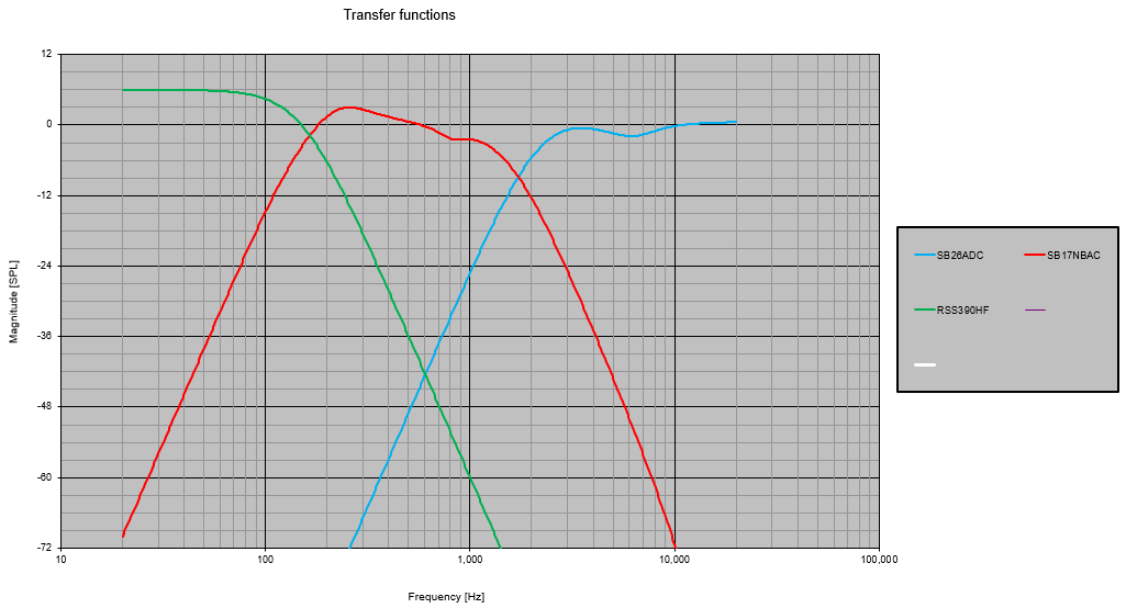

Sorry Jim I lost track of this thread. Thanks for posting all those details of FR curves and the transfer functions. I've posted mine for what it's worth. I'm trying to go for a waveguide on the 26ADC to see if I can push the HD lower for the SB17NBAC with a lower crossover point. I may not need this in practice, so will mock up 2 baffles and do some listening.
In anycase, here's my xfr functions.. all sims so far - for a comparison for what its worth. No LT on the low end (but that will no doubt get an in room adjustment).

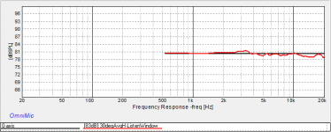

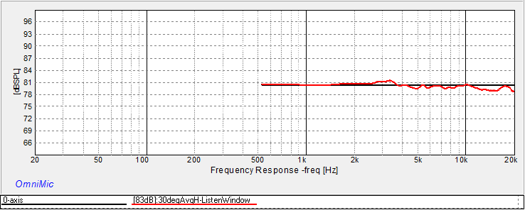

I finally got around to making horizontal off-axis measurements, which digitalthor asked about earlier.
The first curve is the listening window response averaged over +/-30 degree horizontal, normalized to the on-axis curve
The second plot is the horizontal off-axis response at 0, 15, 30, 45, 60, 75, and 90 degrees. I used an improvised "spin-orama" to do this.
I also did some distortion measurements at the upper end of my normal listening volume, approximately 95 dB

I'm very interested in those SB ceramic drivers. Measurement looks all great, and I wonder how they would sound (subjectively). Any special strength or coloration you have noticed?
Yesterday 03:57 PM
Regarding both the SB17 woofers and the SB26 tweeters: My measured on-axis response curves were almost an exact match to the published on-axis curves from SBA, and there was almost no difference between the left and right drivers.
Subjectively, they have a lot of detail and clarity. Especially in the very soft quiet moments where they maintain details down to very low SPL. This allows them to convey a very realistic studio or hall ambience, where a plucked string slowly fades to black, or a cymbal rings down to nothing. They transition from soft to loud to soft very realistically.

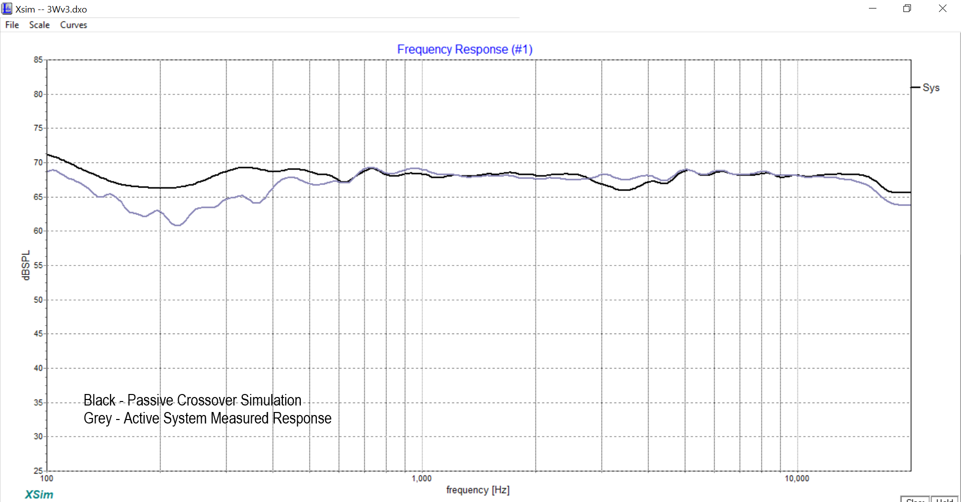

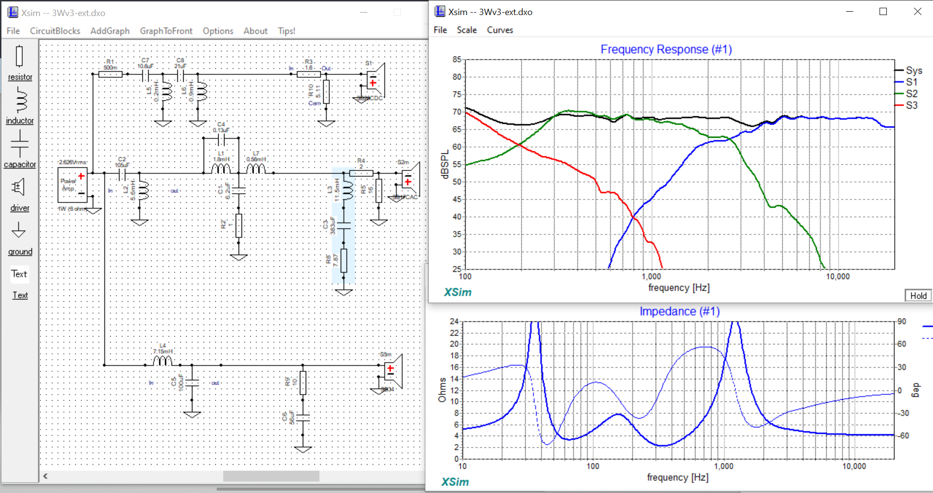

Just for giggles, I tried to design a passive crossover to mimic the performance of the active crossover. This is an academic exercise, I have no intention of building this crossover.
Drivers are the same as my active system:
SB3475NRX-6; 12 inch woofer in sealed box
SB17CAC35-4; 6 inch midwoofer
SB26CDC-C000-4; 1 inch tweeter
The impedance data I measured with DATSv3, using the right hand side drivers as installed in the cabinets.
The frequency response data was gated measurements taken from the drivers as installed in the cabinets. I spliced the near field responses to the woofer and mid below 400 Hz.
The impedance drops uncomfortably low at 300 - 400 Hz, so if I was going to build this thing, I would use the 8 Ohm version of the SB17CAC35. The crossovers at 200 and 2 k are acoustically 4th order (just like the active system), but of course they do not exactly follow the LR4 target responses. With the active system, the drivers follow the LR4 targets pretty closely.
The second image is the Xsim simulation compared to the measured active system. I think it looks pretty good. The measured active response does not include a near field splice, so below 400 Hz I am showing some room effects. These effects do not show up in the Xsim simulation because those responses incorporated the near field.
It was an interesting exercise. It allowed me to again brush up on passive filter design. It confirmed to me the advantages of active DSP.
