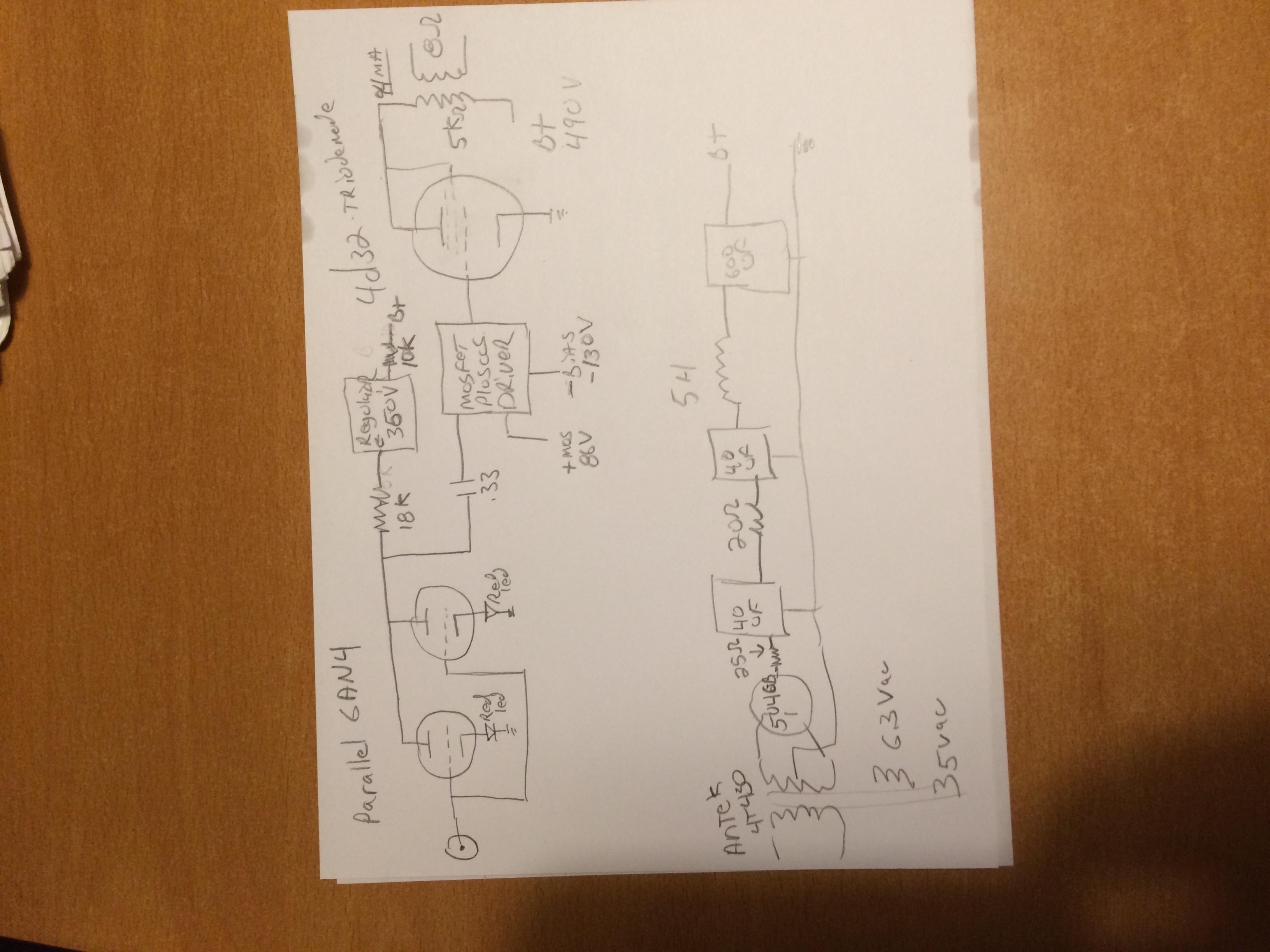

I had been experimenting with the 4d32 PP using your universal driver board. It works and is very powerful. I decided I have a few very powerfull low distortion amps and wanted to try something different.
I love my TSE and wanted to play with a bigger single ended amp. It's fun trying to get the most out of what I have plus I'm learning a lot working with this fairly basic topology.
E

yes George, i remember you posting about them years ago...
to get more power out of the 4D32, crazy drive can be used, i have seen schematics in the net by some Japanese builder ages ago....
regulating the screens in pentode mode gives you more power and very good sounds...
I first tried pentode mode but got much lower distortion in triode mode but also less power. I'll try regulated screens in pentode mode and report back.

regulated screens and while you are at it, regulate also the g1 bias, zeners are good to use here, no need for anything fancy, for G2 supply a mosfet type with zener strings will do nicely...
so then you can do away with the cathode resistor cum capacitor bias for more plate voltage and so greater plate swings...
finally a 2.5k load impedance for your output traffo, make sure your opt is gaped for at least 150mA dc...
post #10 study carefully the posting of PRR, there is a nugget of wisdom there...
another thing, do not get the b+ for the input stage from the g2 supply get it direct from main b+ instead..in my amps i use a separate winding and psu for the input stage i am able to do this because i wind my own traffos...
Tony. In post 10 do you mean the screen voltage being high?
My front end supply comes from the B+ now. Adding a regulator for g2 would be easy but I don’t what voltage range to shoot for. I bet this info is in the data sheet I just don’t yet know how to interpret it.
yes, you can play around lowering that voltage to say 280v and see it that improves the sound...
but i suspect feeding the screens from a very low impedance source is good enough...
when i used regulated G2, i never looked back at ultralinear amps again,
and that is because i wanted to used TV scanning tubes as well as transmitting tubes...

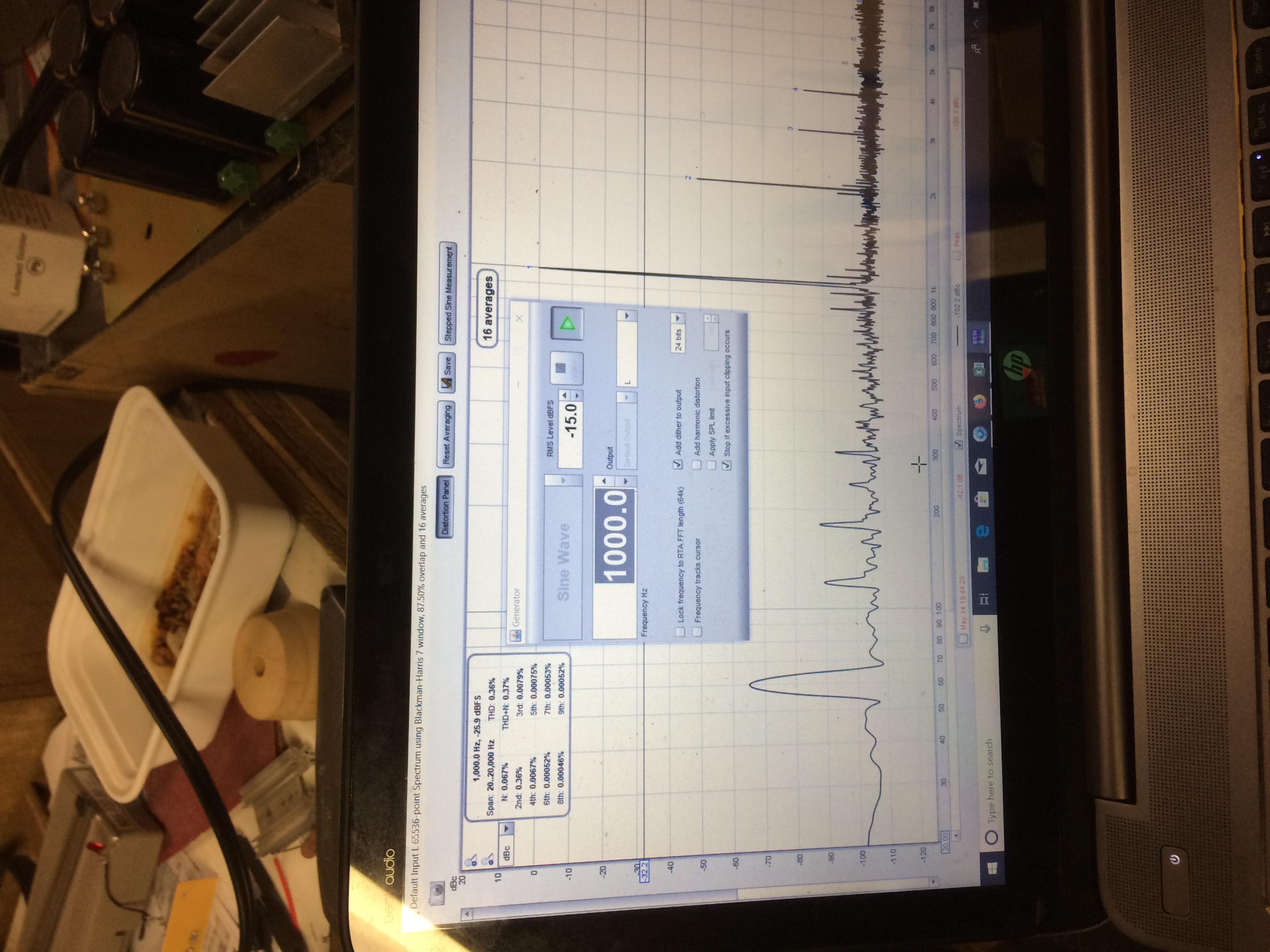

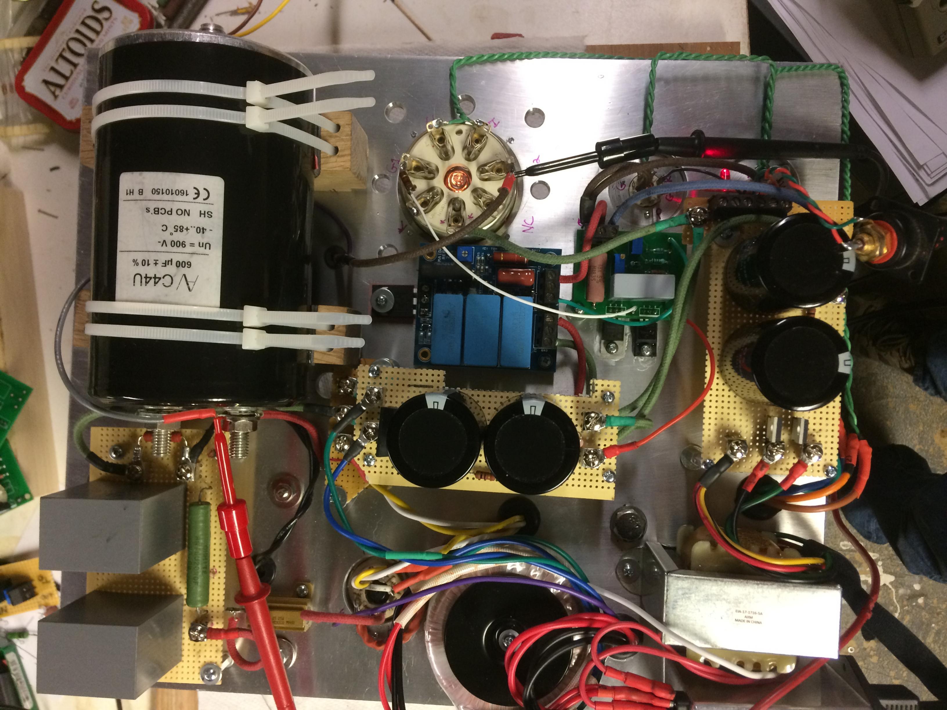

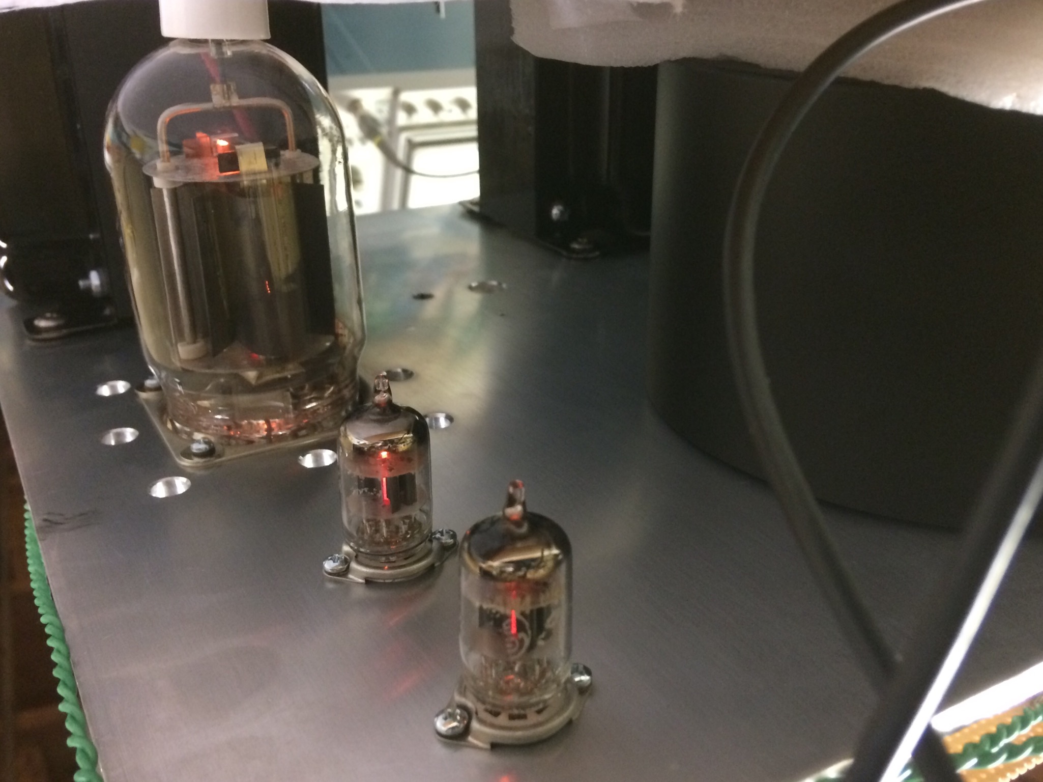

I wanted to update this thread and thank the community for the help. Here are a few photos of where I’ve gotten. Almost done. Just need a couple wooden boxes. I built mirror image monoblocks
Distortion at 1 watt and 10 watts.
I tried too many ideas to count but this seemed the best compromise
