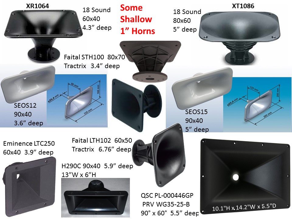

Another question: what about using a Tactrix Horn instead of the STH100?
The Beyma TD194 or 164 look like good horns but I can't find any user comments on them which seems a bit strange.
