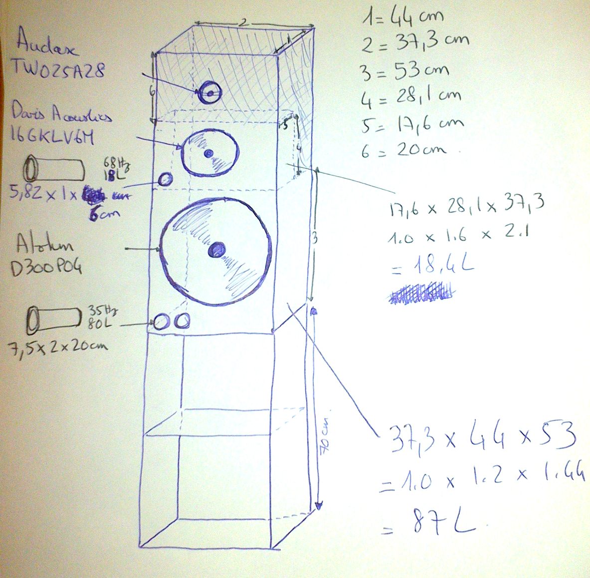

I have attached the plan of the speaker. Sorry for the metric system...
I would like to add two shelfs at the bottom of the speaker, in order for the tweeter to be higher to the ceiling. I don't know if it's a good idea. It doesn't look good... In any case I need an idea to put my speakers higher than just putting them on the floor.

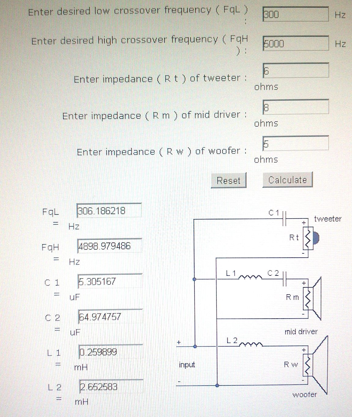

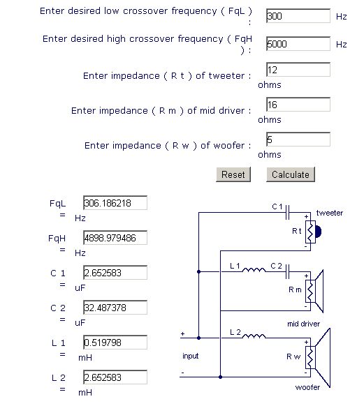

I intend to use a first order passive filter with the following layout:
- Tweeter : 5kHz - 20kHz
- Midrange : 300Hz - 5kHz
- Sub : 20Hz - 300Hz
I have attached the values of the components for the filter.

re: "Sorry for the metric system..." - don't be, only colonials who don't don't know how to have a proper revolution use anything else...
Re: your crossover, it's too simple, a kevlar cone on the mid & the tweeter are going to demand something more than a simple 1st order xover to sound good,
& you need to think about the relative sensitivities of the drivers - the mid & tweeter will need some padding: L pad calculator - attenuation dB damping impedance decibel loudspeaker speaker voltage divider - sengpielaudio Sengpiel Berlin

Why do you intend to use a tuned chamber for the mid? At 300 crossover, you are a couple octaves away from the resonance, so a sealed chamber that is "obviously" large enough would be fine.
It is current wisdom to put the ports on the rear of the chamber to minimize mid-range bleed ( reflections out the port. )
The rigidity of the box is important. One trick I liked was to make the mid-range chamber tie the front and back together. Brace and chamber all in one.

In fact, I was hesitating about using this filter instead:
Visaton HW 3/130 NG - 8 Ohm
It includes this Lpad attenuation that you talked about for the mid and the tweeter.
But it is built for a 8 Ohm Sub. Mine is a 4 Ohms.
Perhaps I can add a 4 Ohms resistance in cascade with the sub ?
Is this filter powerful enough (180W) ?
If I switch to a second or third order, I would prefer to buy it rather than build it because the price difference increases with the component quantity...

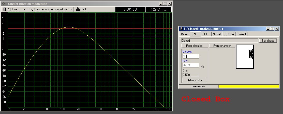

The Sub can hardly go above 300Hz because at this point the impedance is going above 10 Ohms...
I could choose 200Hz and leave the mid in the tuned chamber...

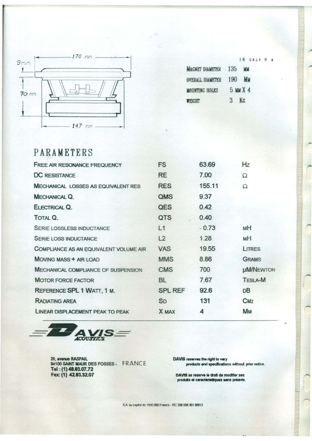

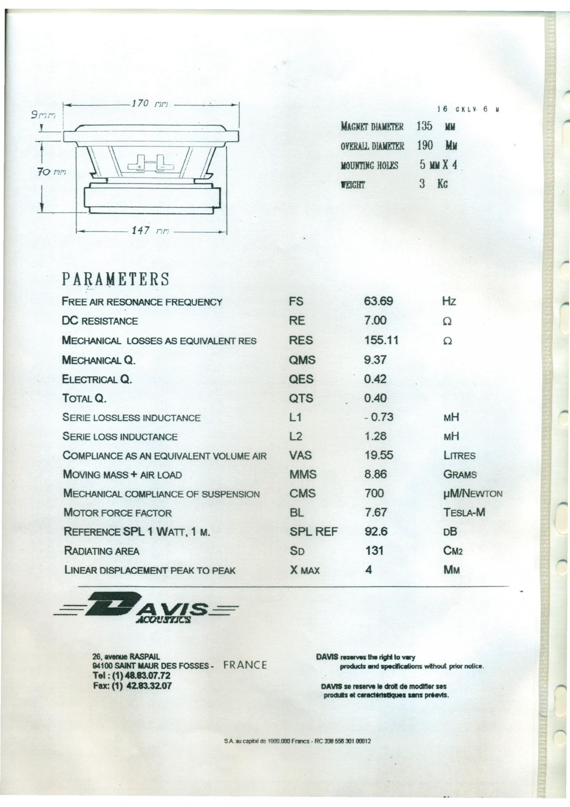

I have put in attachment the parameters of the loudspeakers.
I tried to simulate the closed chamber for the mid in WinISD. The -3db frequency is 150Hz. Isn't it too close to the first order xover cut-off ?
Ok, didn't know that. I will make the change on my plan. Thanks.
Is it possible to put the ports on the left/right of the chamber ?
Thanks ! 🙂
I wanted to keep my speaker as a single box.
It took me a while to find out a solution for two tuned chambers with the same width and completely different loudspeakers.

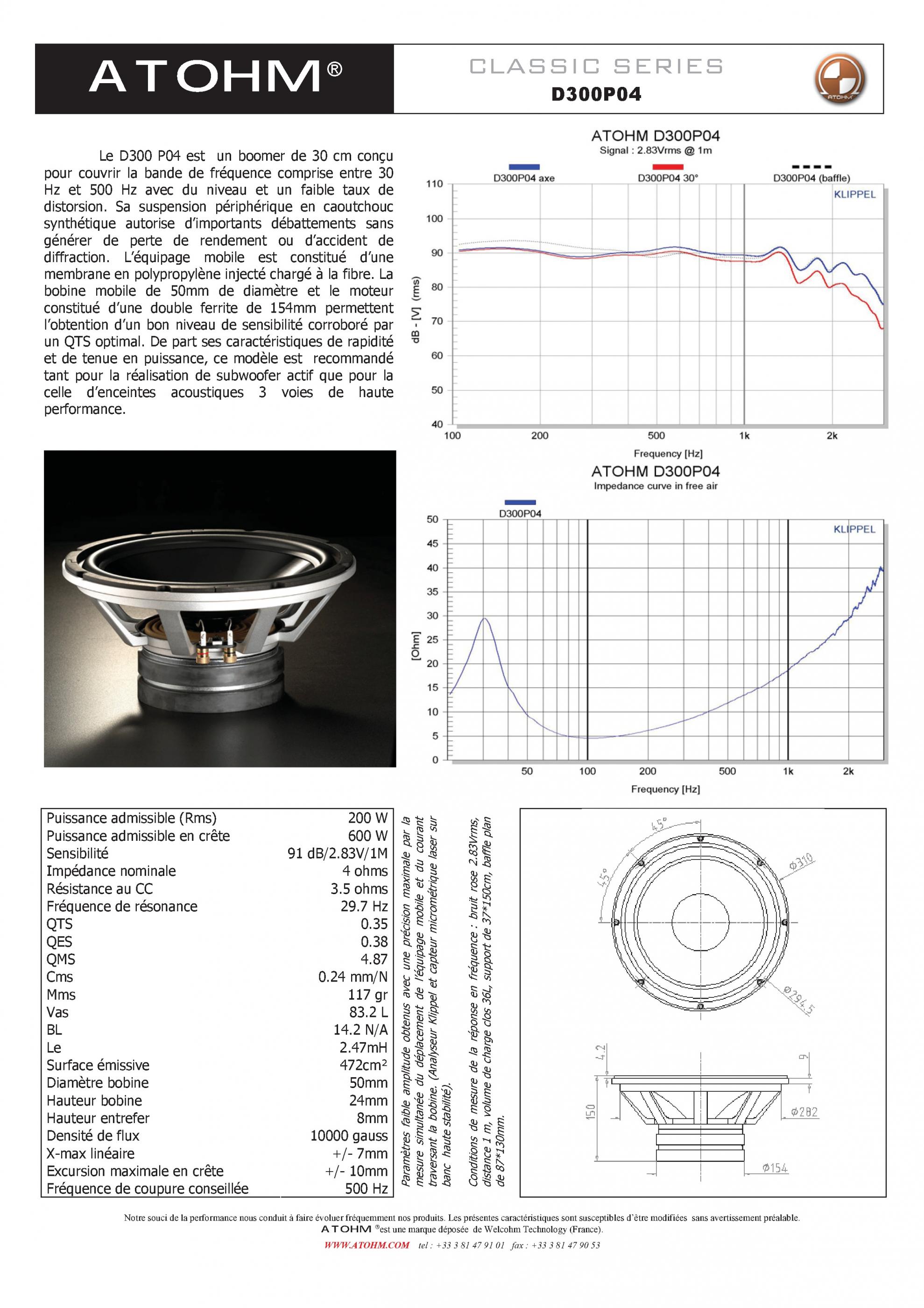

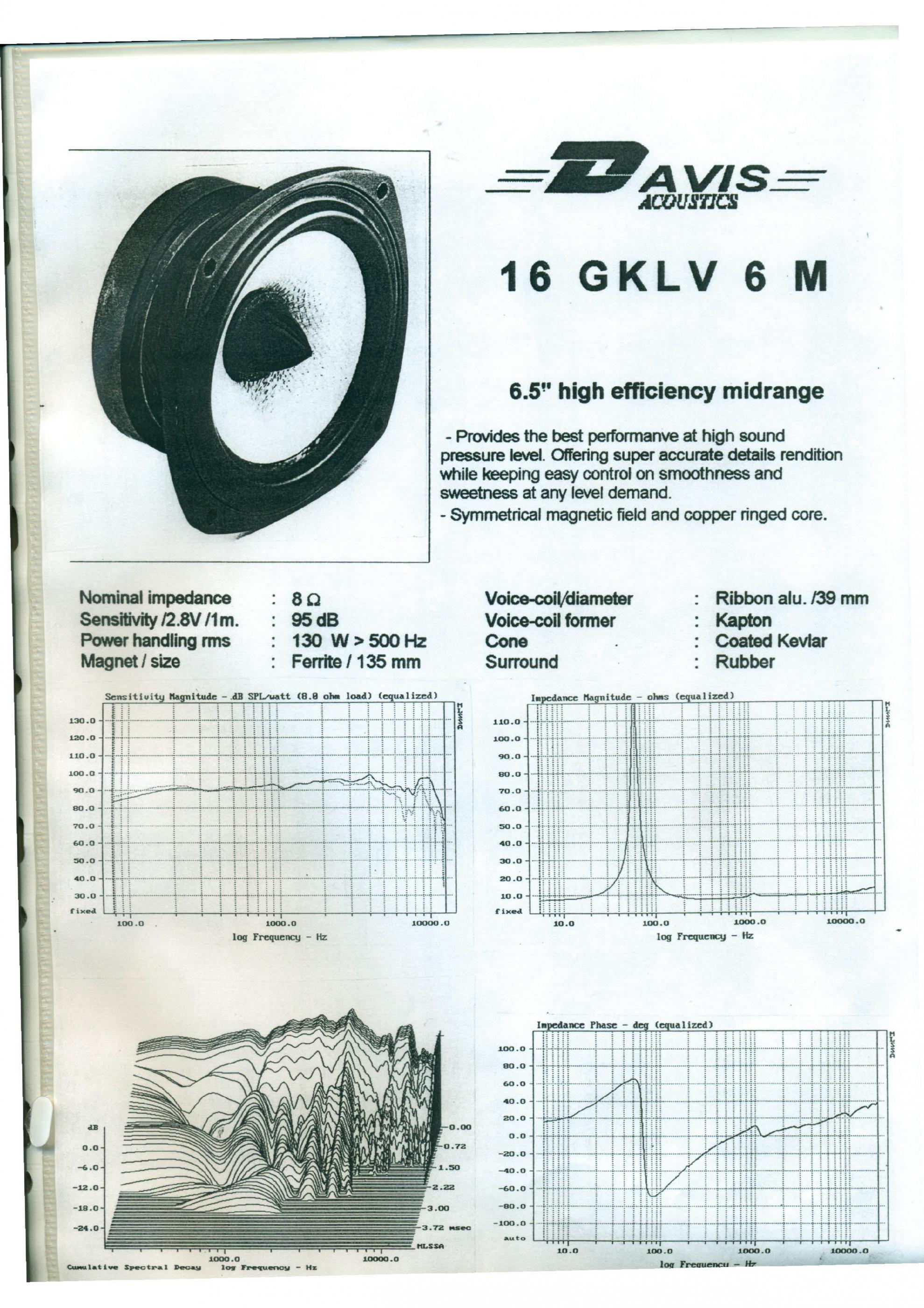

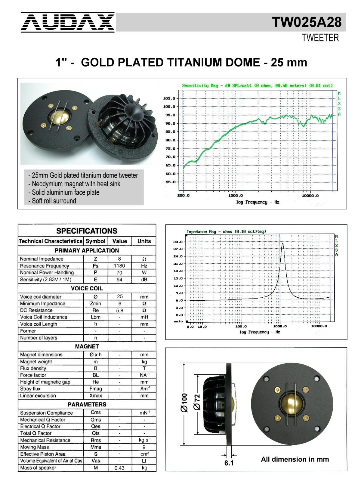

In theory, we should integrate the actual impedance curve in the filter computation. But I think this is a very complex computation only possible to make through simulation software and difficult to double-check in theory... The phase also, I am not sure what is the perceptible limit in the temporal shift between the speakers. Basically this is why I don't want to use complex filters. Simple is always better, right ? 🙂
I think using the average impedance value of the speaker on the working frequency range should be a good start. If the cutoff is correctly chosen, on the working frequency range the impedance of the speaker should be stable enough and have a trustable average value 🙂.
Re: the tweeter problem, another way to approach this is to use a tweeter with good wide dispersion characteristics e.g. SEAS 22TFF
I would like to keep it with "made in France" loudspeakers 🙂
It is the spirit of my projet 🙂
How can I check the dispersion characteristics of my audax tweeter ? (except listening to it ?)

You can find measures of the Davis 16 on part express :
Davis 16gklv6m 6-1/2" Kevlar Midbass 297-568

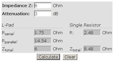

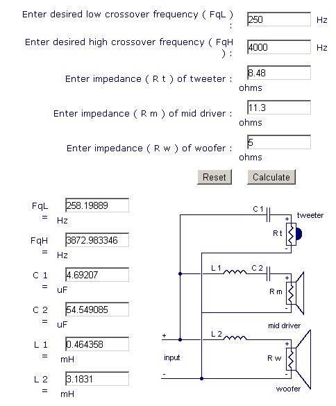

I have changed again the filter...
I want to use a lower xover frequency for the sub. I used 250 Hz instead of 300 Hz because I think the sub cannot really go much higher than 200 Hz and because the mid can do much lower than 300 Hz in a vented chamber.
I changed the high cutoff frequency from 5000 to 4000 Hz because the mid doesn't go as high as I thought.
I also used a 3db Attenuation for the mid and tweeter instead of 6dB because it's too frustrating to loose so much power in the resistors (power is money !)... Also the frequency range of the sub is quite short (30-250Hz).

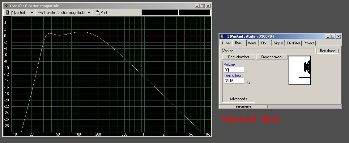

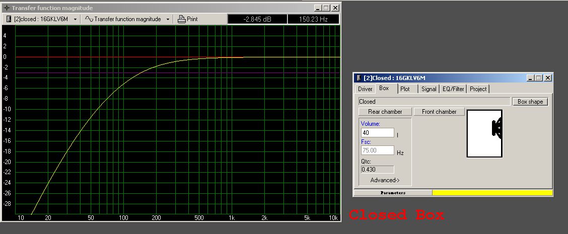

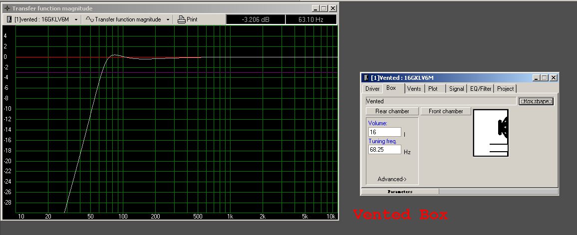

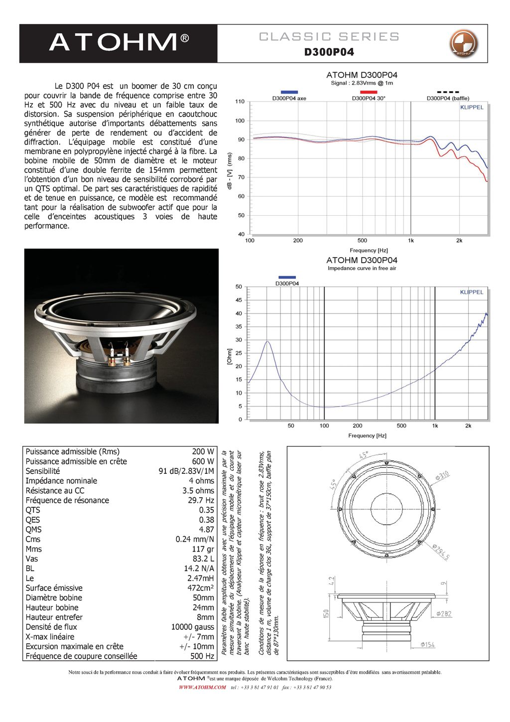

Ok, vented vs closed on the mid.
This is what I get in WinISD.
- Using a vented chamber I have a cut-off frequency of 70 Hz.
- Using a closed chamber I have a cut-off frequency of 150 Hz.
