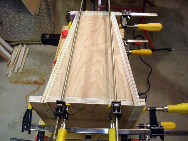

<Chuckles to self> No, just this clamping nightmare.
If you want to know how I figured out how to cut/fit the pieces for a trapezoidal enclosure, let's just say I learned a lot by building Wayne W's Cinderellas
http://www.geocities.com/cc00541/Cinderella.html
I'm no master cabinet maker. The fact that I used biscuits to do this is like a quantum leap for me. Up until now, everything has been screw n' glue. I'm tired of covering up screw heads, though!
(If you're wondering how I did biscuits in the angled parts, well, I didn't. Only perpendicular joints are biscuited. I couldn't get my brain to figure out how to line up the fence on my cheapo biscuit joiner in order to line up angled joints. Maybe it's time to save up for a brad nailer.)

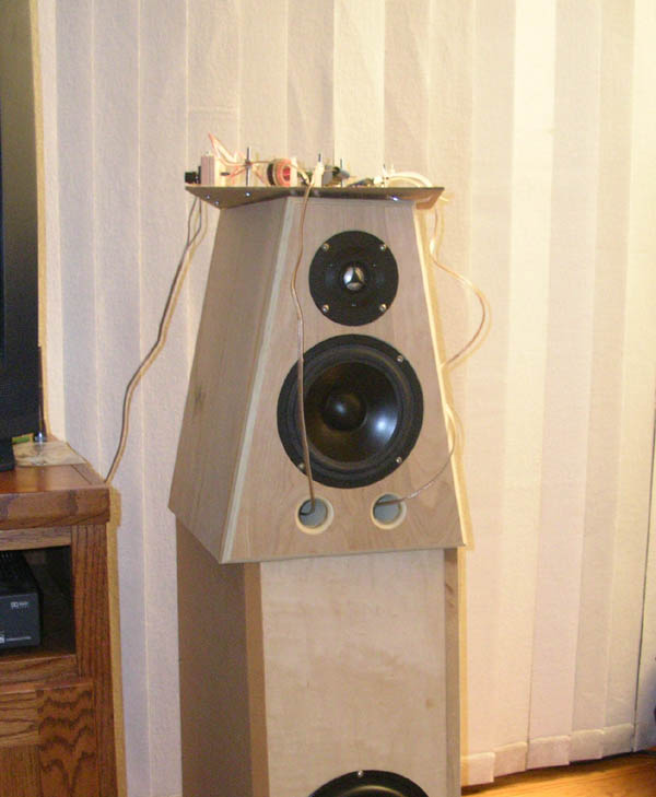

y8s... what a strange feeling it was to see that speaker. At first I just saw the top cab and thought I had maybe entered an alternate universe. Even stranger is that you used a "stepped baffle" to align the mid and tweeter, which is something I was going to do in my next project (though not a trapezoid. phew!)
Anyway, great job. I really like it. I imagine they must sound VERY nice.
it was weird for me too.
I did the stepped baffle as multiple pieces. You can put the chamfered step in and then trim the trapezoid shape after the fact to save you doing it twice and hoping it matches.
anyway, they did sound pretty good but it was an early project that lives in a friend's living room... and I haven't talked to that guy in years!

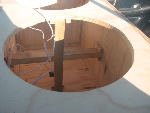

You can see them if you look inside. You have to first attach them to one panel with glue and nails and you do this using a spacer block the same thickness as the plywood to gauge where to put the cleat. Easy really. In this case I used strips of cabinet material, 3/4 (19mm) plywood

Cal Weldon said:
Forgot to mention, you still need bar clamps to hold it while you nail. Sorry for the OT.
? I just hold things together with my hands while I use the nail gun, the whole point of the nail gun to me is that I don't have to clamp then...
I thought I was going to build gobs of speakers when I moved here and I've got like three nice nailers and a big compressor. Sadly, it's been years since I've built speakers, all those tools waiting in my garage... Somehow finding the time to build speakers is alot easier when you work at a speaker factory 😛 (what I was doing before I moved back to the Midwest)
My dad gave me a biscuit joiner for Christmas the other year, but the nail guns are so much faster - the reasons I could see for using biscuits rather than nails are: if you're not going to veneer, or, if you want to do rounded corners and don't want to hit nails w/your router.
