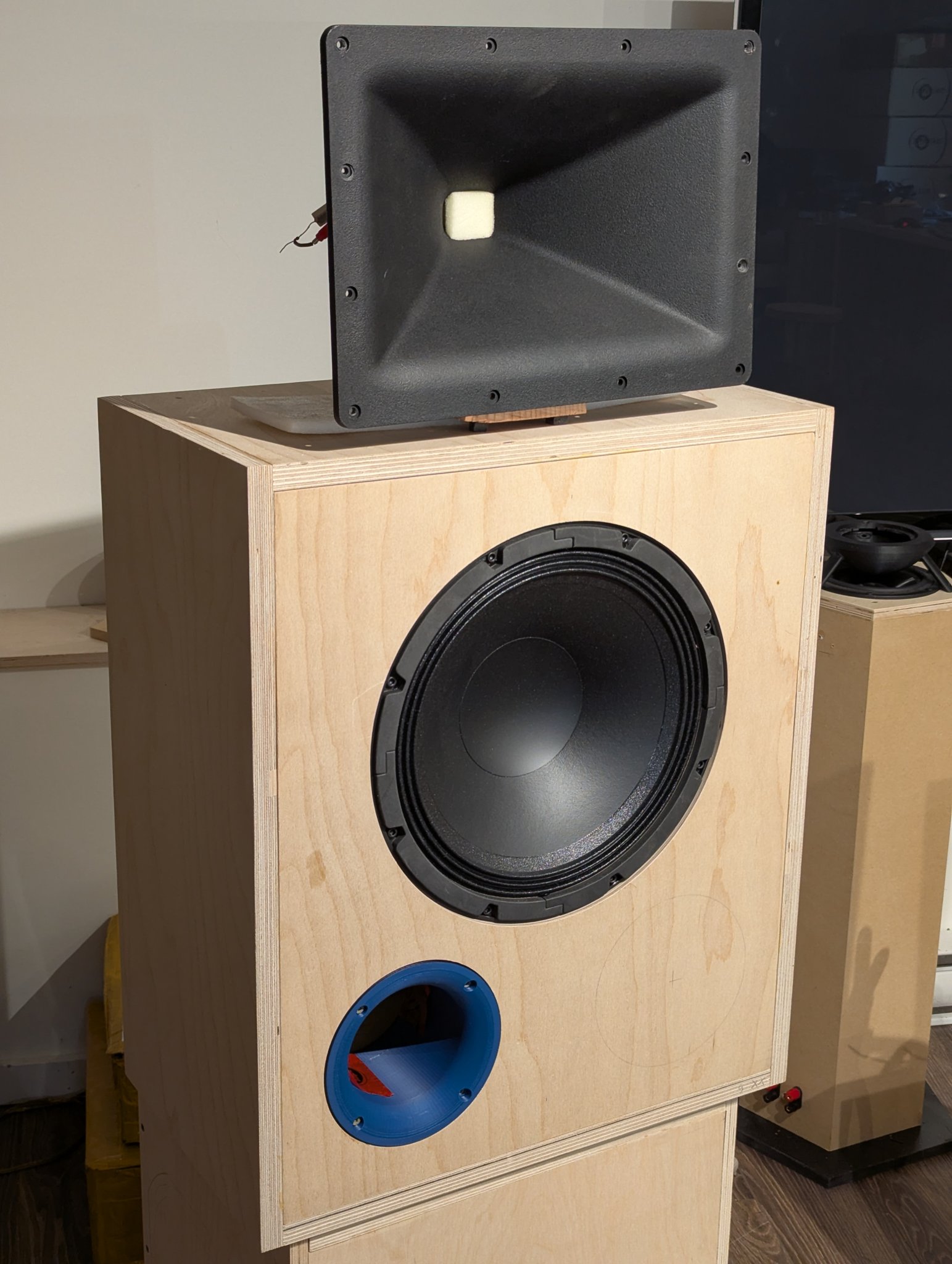

It was a size thing -- had to be 2cf max, and I thought it too small for 15"s. Didn't even think about the 15; probably should have checked. Has anyone modeled the 15mwn700 in enclosures?
Also I doubted the 14x10 horn + ROSSO-44CDN-PK combo could be crossed low enough in a 15" 2-way. I'm pushing it at 800 & 1000Hz, and getting away with it because the speakers won't be played loudly enough to raise distortion much. It's 110 dB sensitivity. But with a 15", I'd want to cross maybe 600 or lower and that's definitely too low for this horn & CD even at home SPL levels. And there was no budget or time to design/build an active 3-way.

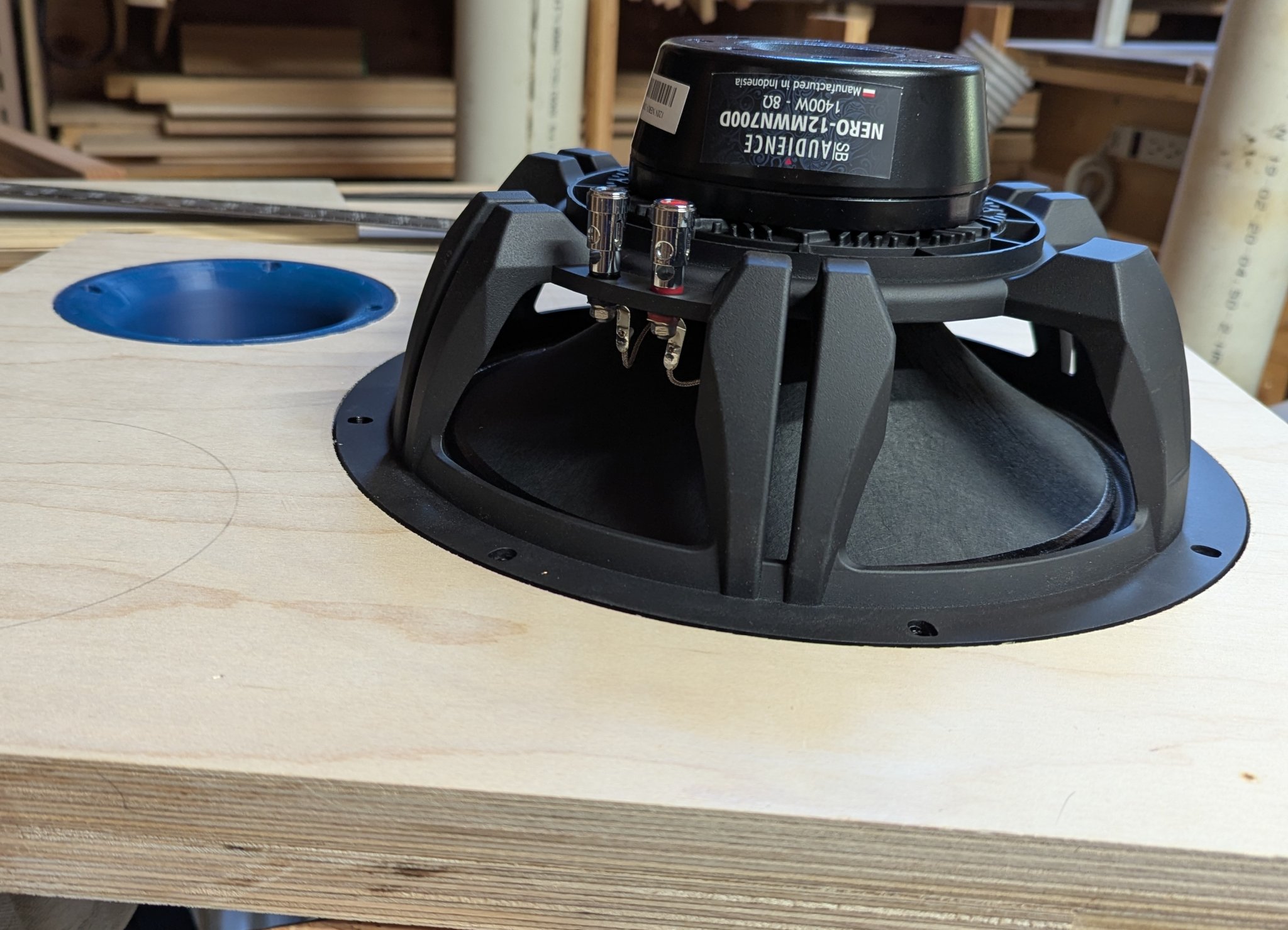

Full diy projects file pleaseI recently used the Nero-12MWN700D in an active 2-way 2cf 44hz port box with 14x10 (90x60 deg) horn + ROSSO-44CDN-PK compression driver. It measures flat to ~1khz and slopes down above. My EQ ended up with ~10 dB 0.8 Q low shelf boost @ ~70 Hz, with LR8 high pass at 25hz to protect against subsonics.
The driver handles the boost well, easily hitting 105+ peaks without any sign of strain with modern bass heavy music like Bad Guy by Billie Eillish. Output drops steeply below 40Hz, but above, throughout the bandwidth (crossed 1khz LR4) the Nero-12MWN700D is very convincing, full bodied, rich, dynamic.
It's my first system using all pro drivers & I'm seeing the light: the high efficiency & dynamic range allows them to cruise with low distortion at any normal home HiFi volume.
