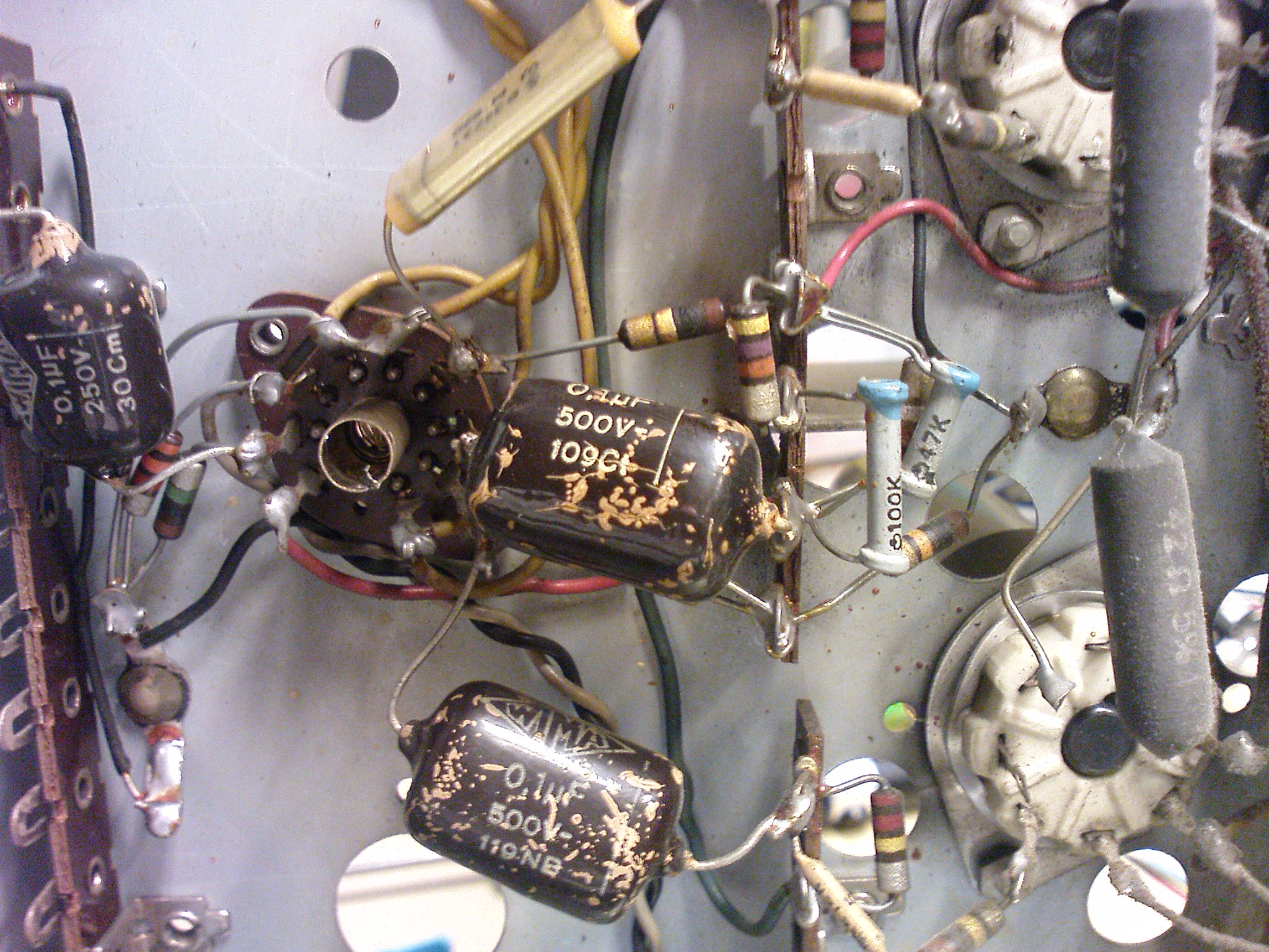

Just recently almost two years later I stumbled over the dreadful black Wima cap.
Anyone recognize these? 🙂
Nigel,
I know what Wima cap you mean, the axial one dipped in black.
Capacitor was very common in old tube amps and radios.
Terrible cap, if present you'd better replace them all as they would all fail sooner or later.
I have been looking for a picture on the net of the cap in question, no success so far.
It would be nice if someone could post a pic of the cap in question.
