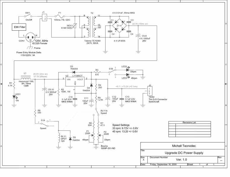

No. After investigating the Never Connected desing I came up with these results:
-The Never Connected PS is using a short conduction angle rectifier to charge a cap, then this cap is used as a supply reservoir for the Standard Michell DC power supply using a LM317 regulator. Nothing really fancy there, no speed regulation.
-The Michell DC motor needs a small current, about 75ma. The conduction angle of a low current rectifier supply is small anyway. So a normal rectifier in this application will behave as a NC supply.
-Others users commented than a low impedance supply (big transfo), low ESR Caps, Fast recovery diodes, CLC filtering and Low Dropout Regulator will probably give equivalent, if not superior results than the NC Supply.
-In particular the CLC filtering gives superior supply capacity. This principle is rarely used because choke are expensives.
-The Michell supply provides only 1 speed. My supply provides 2.
So my ver 1.0 is the first version of the upgrade supply. A possible version 2 will add a Back EMF motor speed regulation. I may try to add this functionnallity in this version 1.0 PCB using a daughter PCB, or redesign a complete new one and compare the listening impressions.

Here the final schematic with reference voltages. I added R8 (330R) to drop the relay supply voltage to 12V.

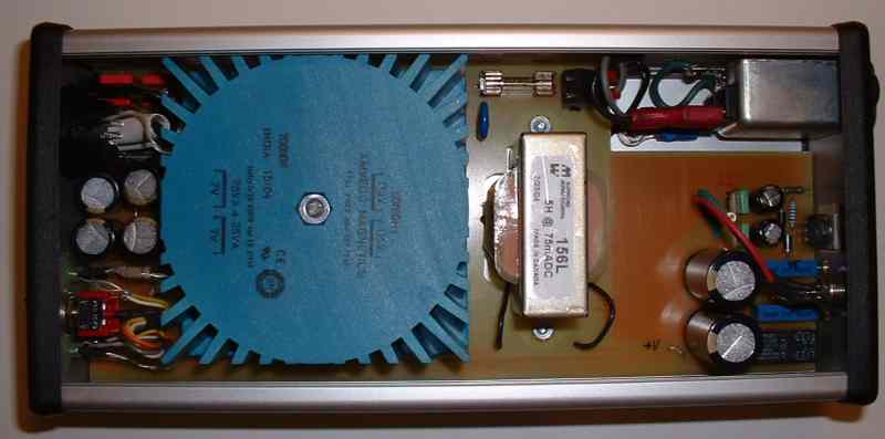

The ver 1.0 is completed. Here the images. First the top view showing the complete PCB mounted into the Hammond case.
On the front are the first section of the supply, rectifiers, first Caps of the CLC filter and the controls: Power-On switch with integrated Power-On Led and the speed selection switch with its two leds. Everything is modular and mounted on sockets so the pcb access and removal is easy.
In the middle section, we can see the big 50VA Telema power transformer and the Hammond DC 156L choke 😎
Then on the back the last section of the CLC filter caps and the LT1085 regulator, the speed selection resistors relay and the 2 multi-turns potentiometers for the speed fine adjustement.
We can see also the power entry module with the integrated EMI filter.

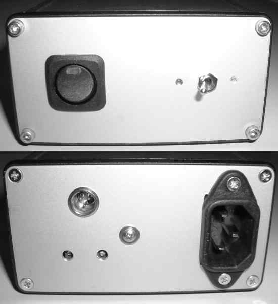

Finally, the front and back panels views. I'll add identification stickers in a few weeks, but for now it is not to bad for something hand made 😀
On the back panel we see the two MT pots access holes, the Michell small DIN connector and the AC socket. The small screw in the middle hold the regulator to the back panel.
