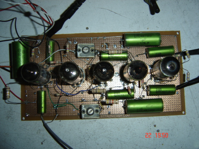

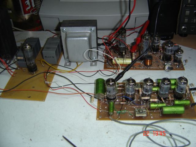

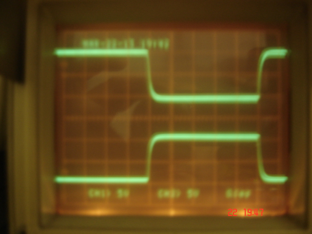

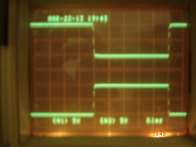

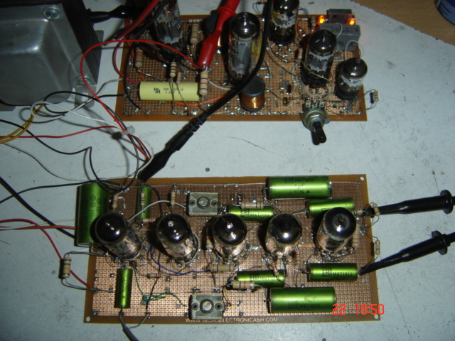

Here are the photos I promised (1 of 2)!
1) The workbench: at bottom, ham radio sets, and one of the 486's. nearer, the DUT.
2) The test setup: DUT, power supply and voltage regulator.
3) The DUT (Device Under Test) near board with 5 tubes aligned,
4) The DUT (Note the 2 mica compression trimmers).
5) The oscillogram with the trimmers out.
6) The amplifier just trimmered (Neutralized).
7) The amplifier overcompensated.

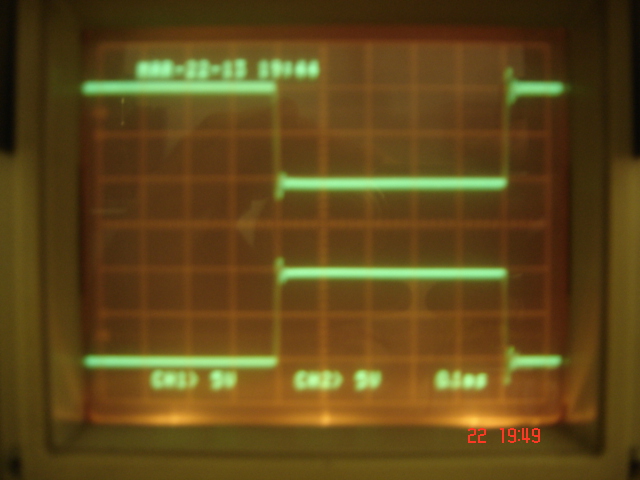

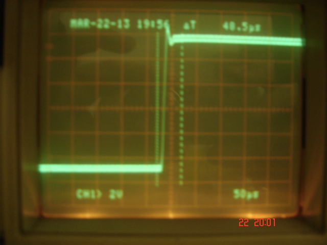

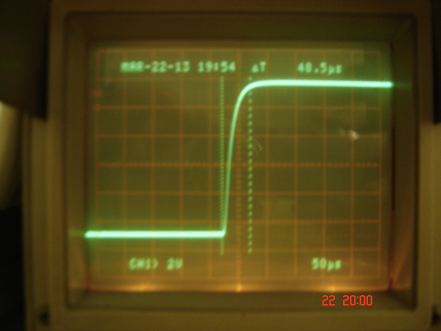

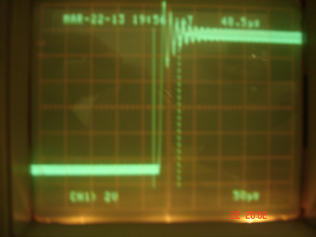

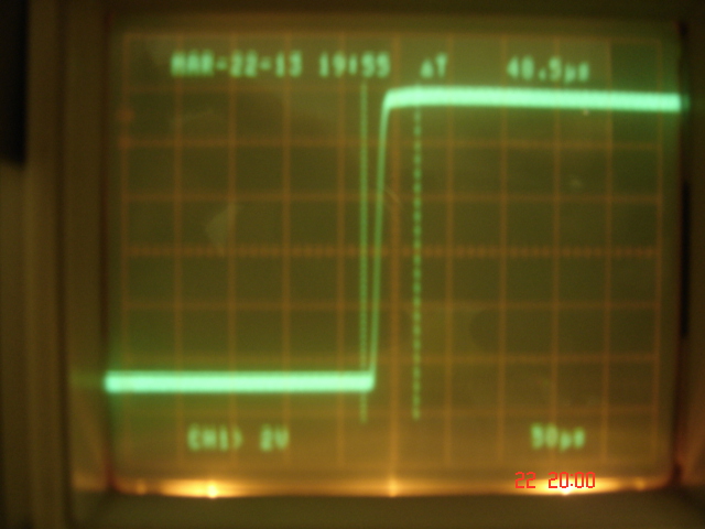

Only one channel viewed, 50VPP (limiting output voltage is 80V, so no grid current, no plate saturation, only amplification) 1 KHz (The test output from oscilo to calibrate probes.).
1) The amplifier undercompensated. Note the cursors approaching the slew time.
2) The amplifier just compensated.
3) A bit of overcompensation (Note peaking).
4) More overcompensation (Peaking and ringing).
5) Still more overcompensation (The amp breaks into oscillation).
Comments? Suggestions?.

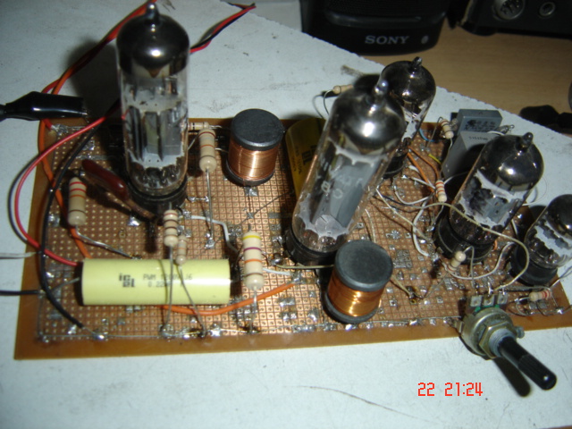

Imagination
Can any of you imagine what does the regulator board do? Observe two 22mH chokes in it. Tubes (Valves) are: ECL82, EY82, ECF801, ECC82, EC900.

You must need lots of imagination, this circuitry is unique in the world in its class.

Beautiful, you did it ! Congratulations !
Another tool for the box, thanks !
Thank you. Since now, buy lots of 3-30pF trimmers for your future amplifiers and or designs.

Interesting work.
In the second trace ("Just Compensated"), the top of the trace appears thicker than with no compensation. Might there be some high frequency noise introduced by the compensation process?
Yes, a local 990KHz AM carrier. Some tents of kilowatts at 20Km more or less.Interesting work.
Also the camera's focus at such short distances, 10 cm (4") isn´t too good.
I forgot to write that the amplifier is capable of catching and amplify the AM carrier without detecting it, which is the key point in my scheme.
