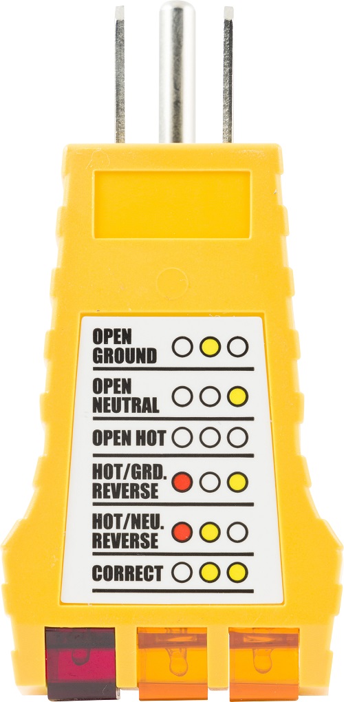

In North America the wall socket has dedicated hot, neutral, and ground connection points and the plug at the end of the electrical cord has dedicated prongs also. There is only one way to insert the plug into the socket. So a properly wired wall socket and electrical appliance would have identified hot, neutral, and ground connections within. In this system the hot is live with electricity and the neutral is connected to earth ground.
The proper location for the fuse within the amplifier is directly at the hot line after it enters the amplifier chassis. This way if an electrical fault occurs, the fuse blows and no live AC enters the chassis.
If the fuse is connected to the neutral line instead of the hot line, the fuse will blow if an electrical fault occurs, but the amplifier would still be live as the hot line is still active and the ground, which is connected to the neutral, is still active.
So then we come to the situation with identical fuses in the hot and neutral. If during an electrical fault the fuse in the hot line blows, then it has done its job. But if the fuse in the neutral line blows, then the chassis is still live. So the theory is that if a much higher value fuse is in the neutral line an electrical fault would force the lower value fuse in the hot line to blow.
Of course this is all dependent on proper installation but that applies to all aspects of diy. To be safe the wall socket should be checked for proper wiring too.
