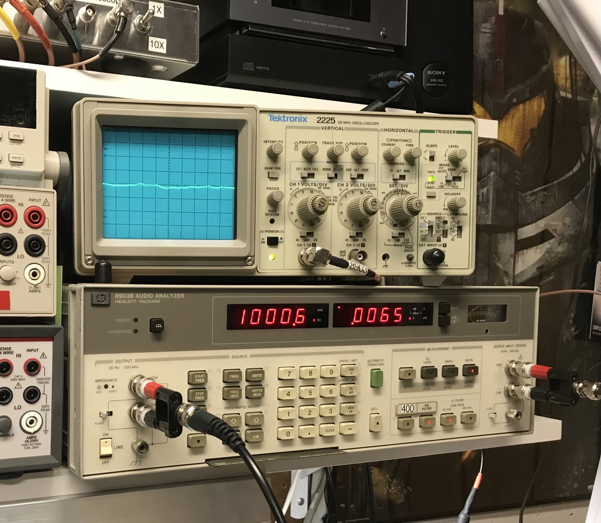

At any rate, here are some pictures and these are my results as measured on my HP8903B. Even though the HP is much more limited (but perfect for tube amps) than the newer AP equipment, I am impressed on what I am seeing - the best I have seen on this rig. Great job Tom.
Power Rails: +/- 28VDC using Neurochrome Power-86, with Antek AS-2222 transformer.
Full Power: 38.5W (both channels very close), 0.886Vrms in.
THD+N: 0.0065% with 30K filter on
DC Offset: 4.5mV
Gain: 26dB
Signal to Noise: 97dB at full power with covers on
Will post the Modulus-86 build sometime this summer.
Cheers!

Very cool. It looks like it came together nicely for you. Thank you for sharing. The SNR measurement is probably limited by the HP8903B.
Tom
Yes I think so. When I do a loop back on the HP I get SNR: 102dB, THD+N: 0.0018% (-95dB). I think that is fairly close to spec. This guy was designed at a different time but still working fine - I expect a re-cap in the near future - that might make some minor improvement. I have it paired with the Tek 2225 to show the HP's monitor output to reveal the signal after the fundamental is notched out - in this case not much left...
One other comment - I thought I was very conservative on the heatsink for 2 LM3886's but in actual use, even running fairly loud with music, they don't get that that hot - just using the feel test. That has been my previous experience but reinforced now by Tom's commentary on crest factor. For sure testing to full power with a sine wave gets this baby hot; however, in practice most of us are playing music through our system and the stress is less; hence, can get by with a smaller heatsink. Also, as can be seen by the pictures I was space limited so I guess it works out for my implementation. Size accordingly, especially if you are going to play Van Halen at 120SPL - that used to be me at a much younger age 😎
For a while I would buy defective HP8903A on eBay for not that much money and repair them. Usually it was the power supply caps that had dried out. Swap those and the box came to life just fine. I'd then run them through the calibration test procedure using the calibrated instruments I had access to at the time. It's a great box for its time. I do like the instruments of that era.

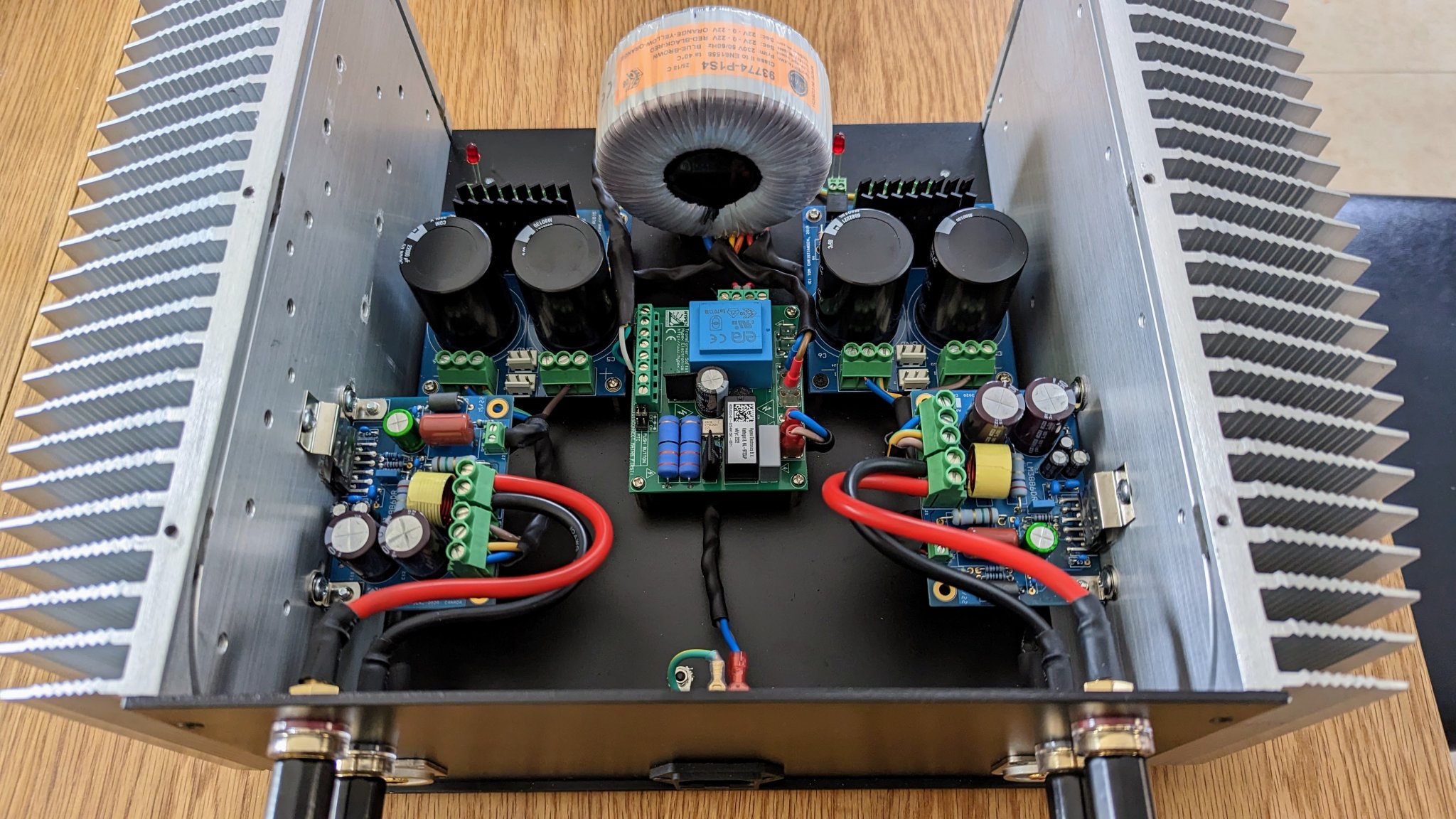

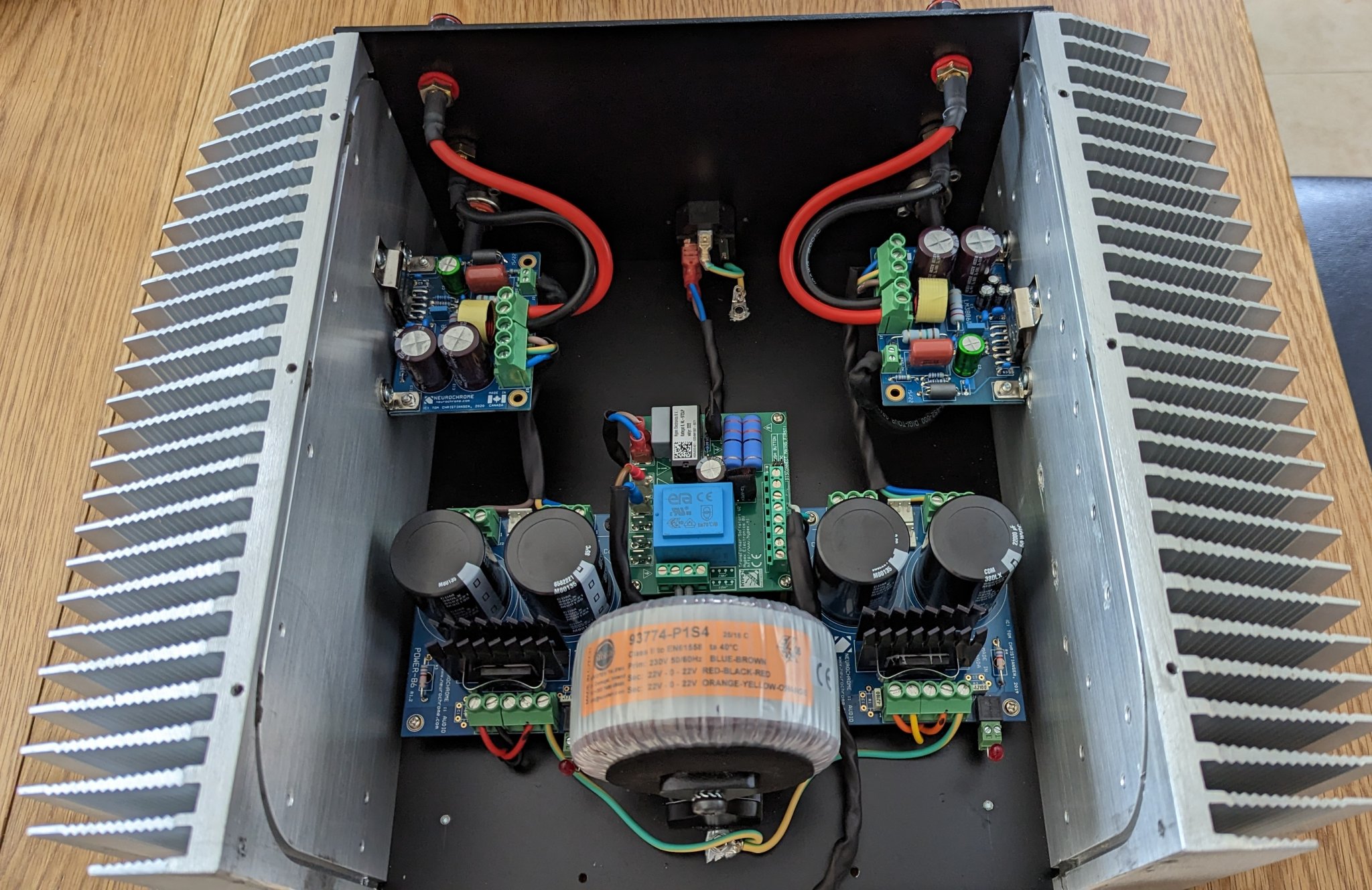

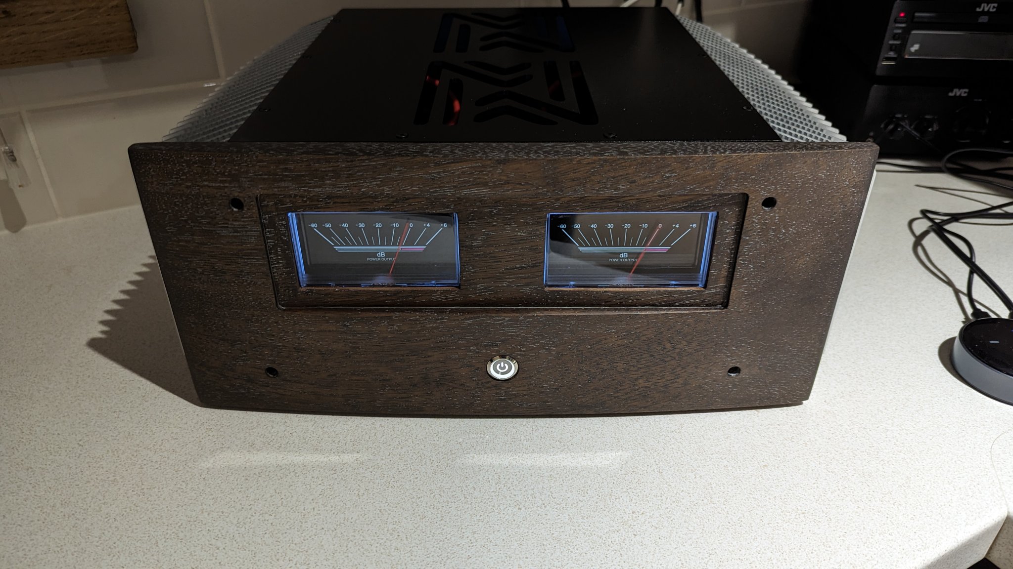

Thanks to Tom for a great quality product that was easy to build. I took his advice and went with a dual mono set up. I know people will cringe at the absolutely useless VU meters but i couldn't resist. This is my first amp build. I built the chassis from scratch, with the heatsinks coming from a renewables company. I cut the heatsink in half to create the two sides. The amp sounds very quiet, super detailed and musical if fed decent material. Highs can be a touch forward but I put that down to the Wiim Mini and my old B&W DM14's (now being re-done to look more modern). I will get a decent dac as the one in the Wiim is not great.
Thanks for the help Tom and well done on brilliant service and product.
I will build a pair of Modulus 86's in the not too distant future or maybe save that for the autumn.

Thanks, it looks better in the flesh. No issues at all with ground loops. Super quiet. The VU meters are a bit of fun, I used a completely separate power feed for them, 12v. I have the meters connected from +- on one channel output and + on the other channel. I can't here any degradation but have since took my B&W's out so I've only heard the sound on the ceiling speakers in the kitchen. I will be interested to see if the VU connection causes any difference (they are powered by a separate board)
Mike
The output impedance of the LM3886 is pretty low, so I wouldn't expect that you'll be able to hear any difference with/without the VU meter added.
I like the clean build as well. Nicely done. One thing you may consider is to add standoffs on the two front mounting holes on the PCBs so they aren't cantilevered off the heat sink.
Tom

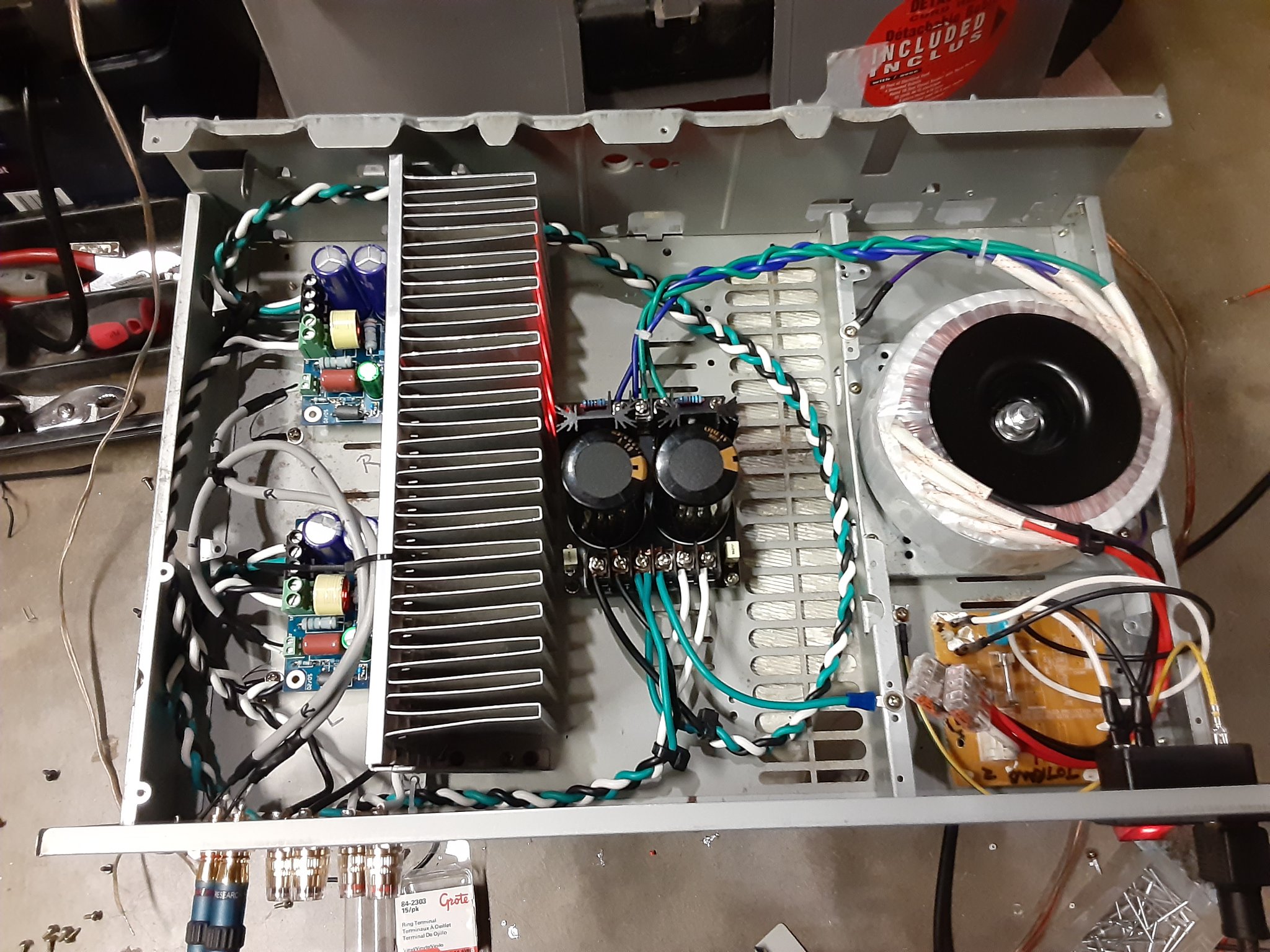

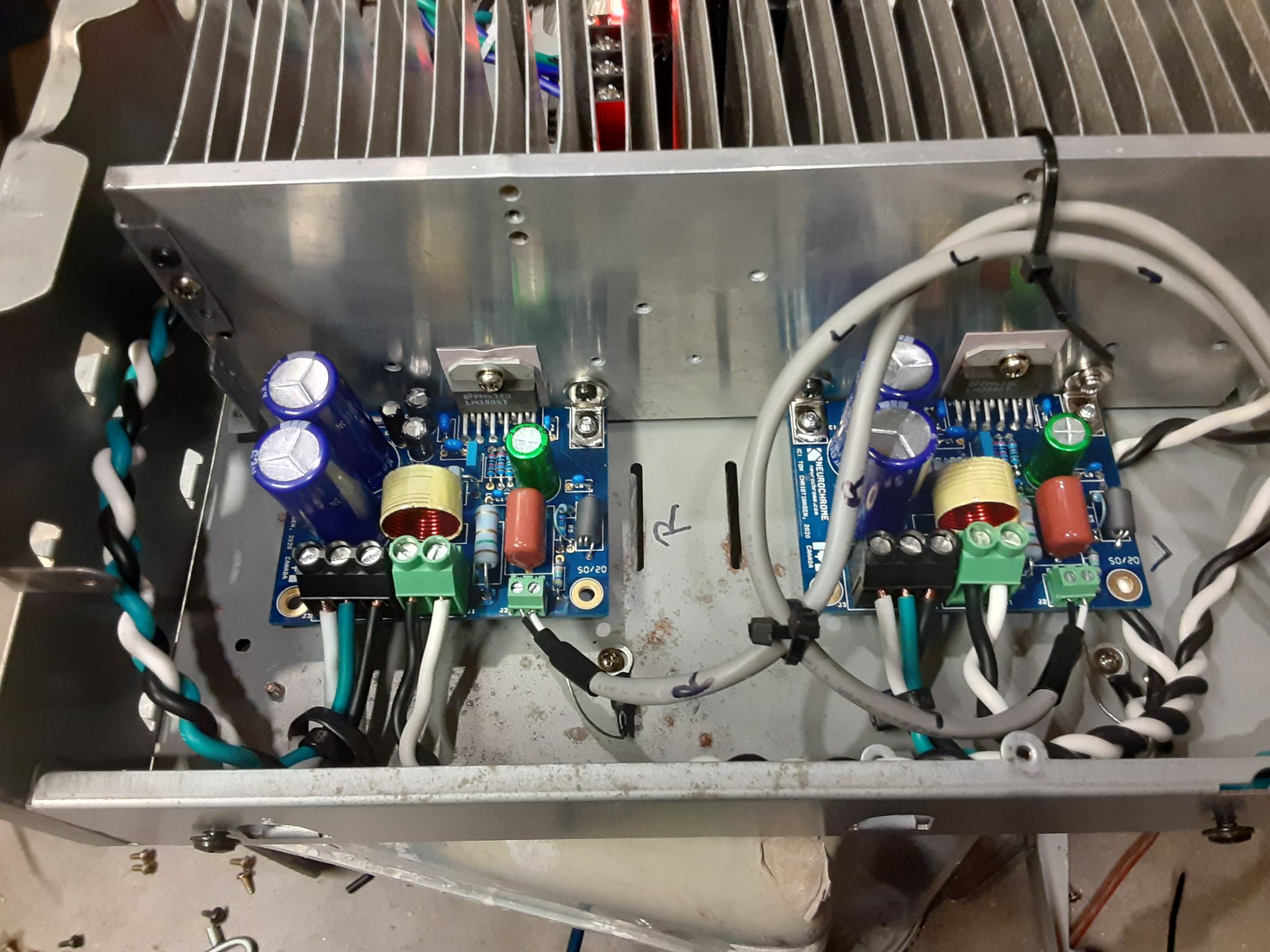

I have finally got my LM3886DR put together. It is a bit of a Franken amp. The case was from an old JVC receiver, the heat sink is from a Sony receiver the power inlet board is from a Kenwood subwoofer that is fused with a 3 amp slow blow. It is not complete yet, I need to add a face plate to the front of the case. Using the 400 Hz tone and multimeter test gain was spot on and DC offset was extremely low. This amp is the quietest amp I have had. Lots of fun and sounds great. Kudos to Tom for a great set of instructions and supplying some parts during COVID, I know its being going on for a while.

That's excellent. I like that sort of chassis reuse or 'upcycling'. One suggestion, though: Next time you have the lid off, I suggest adding some standoffs and mounting screws from the two mounting holes away from the heat sink to the bottom of the chassis.
It can be a pain to get the mounting holes in the right locations for this. The proper tool to use is a transfer punch. But few have those. My trick is to use a mechanical pencil with a 0.5 mm lead. I extend the lead far enough that it'll reach the chassis bottom. Then gently trace the outline of the hole in the board onto the chassis. From there it's easy to centre punch, drill, and de-burr.
Tom
Already have a plan. I have some plastic standoffs but are slightly to short so I need to shim with a bout an 1/8 " (apx 3mm) Thank you for your suggestion. One last thing, how do you tell your wife you need to build an amp using the Modulus-286?
Nice build! I solved a similar problem with a bunch of washers in the past. I moved from LM3886DR to Mod-86 which was very worthwhile. Can't help with the finances and the spouse, but I'm sure she loves you 😉

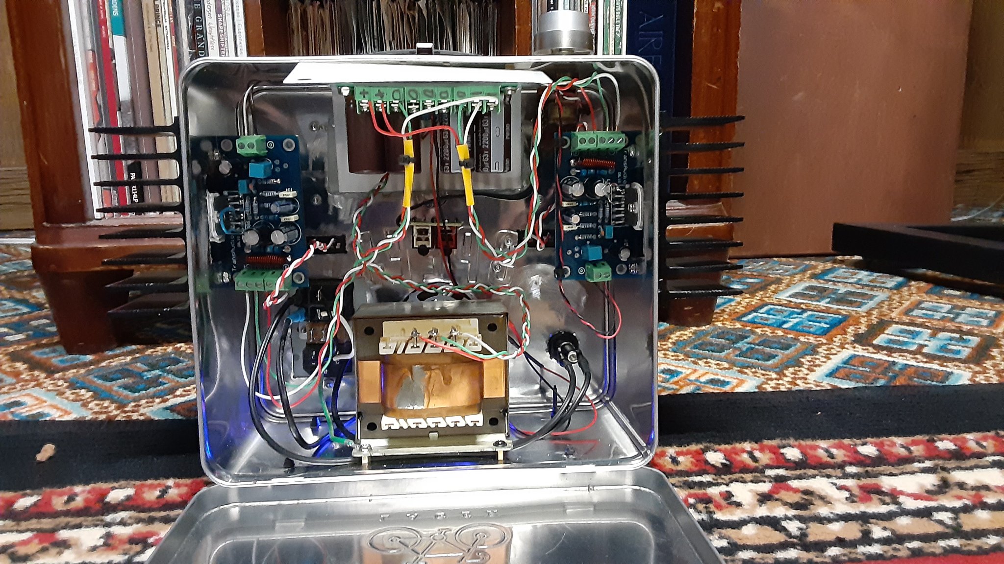

So the first LM3886 I build was a Chinese kit, which I built for fun and to see if this gain clone amp hype was worth the time and effort. The case was a lunch box I got at the LCBO and the beers were just a side bonus. Other parts were scavenged form the local e-waste bin. The transformer was a bit big giving me apx +- 39 volts puttin it at the top of the limits for the LM3886, but this was just a test so if I let the smoke out no big deal. Well the results were pretty good but it had some hum issues. So I decided to build the LM3886DR, glad I did.
