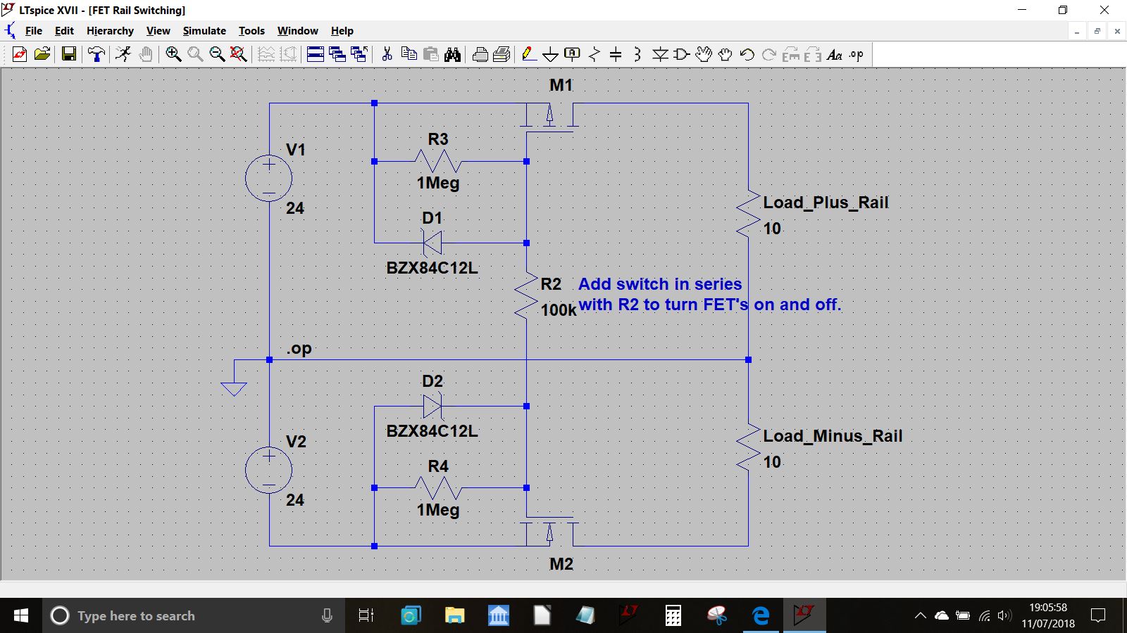

If I am using four 12V (fully load 13,3V) batteries in series as "power supply" will I have to switch all 3 wires with an SSR or only "+ and -"?
Yep. There's no need to switch the ground. Just switch V+ and V-.
Found an SSR from Panasonic.
May be better than no-name-Ebay.
I'd say definitely better than a no-name from ePay.
Double-check with the data sheet that the SSR you've chosen is suitable for switching DC. Also note that some SSRs have zero-detection and require the switched voltage to be near zero before they'll switch. That'll work great for AC, which crosses 0 V twice every cycle, but not for DC.
You could also make your own SSR by using a pair of power MOSFETs and a floating photovoltaic gate driver.
Tom
Something like this could be workable. Switching R2 into circuit enables both FET's (together) and opening the connection turns them both off. The zeners ensure that Vgs is never exceeded.
The switch in series with R2 could even be replaced by an opto enabling remote control of the PSU.
(Its just a quick doodle and not intended as a fully worked optimised example).

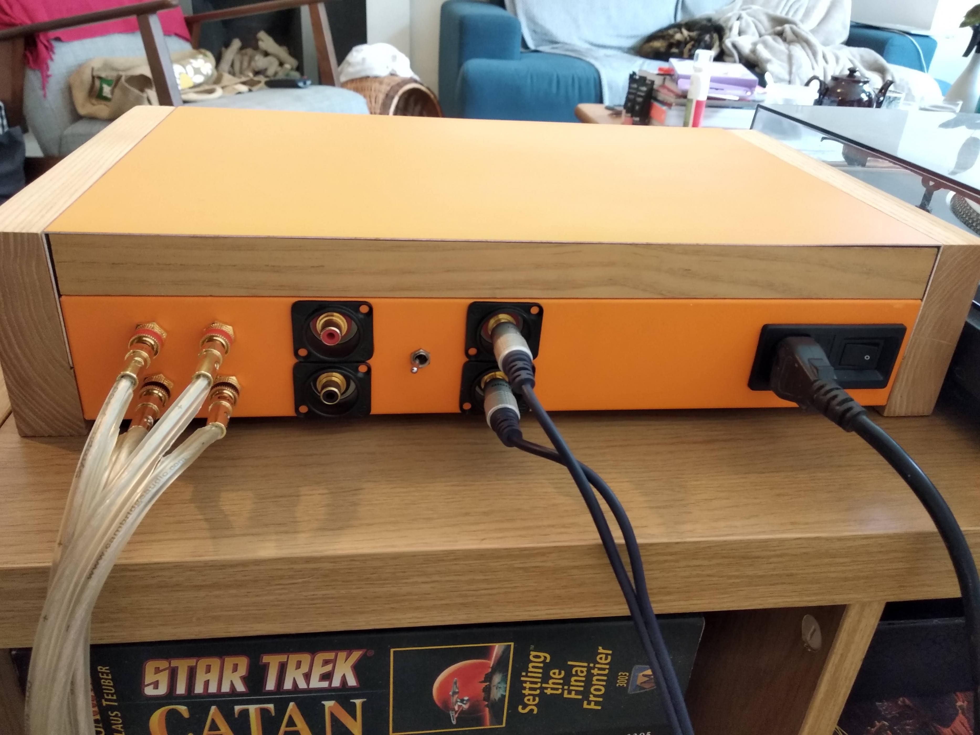

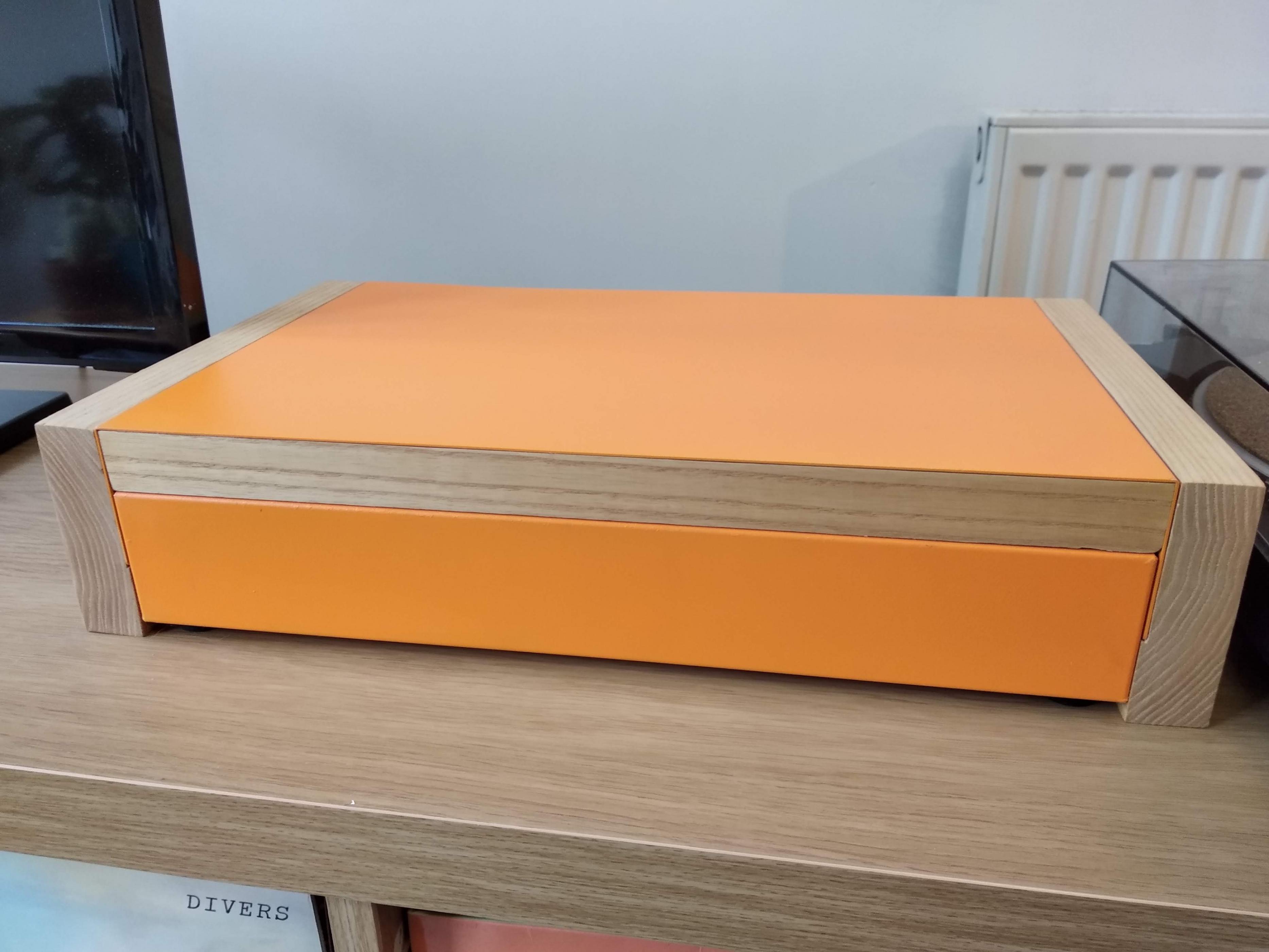

I got two LM3886DR boards from Tom back in February, and I've been putting them together in bits and pieces in the time since. I'm a student and this is my first build, so it was a big learning process for me. Thankfully Tom answered every single one of my questions, over and over, and I got it working after he helped diagnose some dodgy soldering. I wasn't sure if I would be able to notice the difference from the old receiver I was using, but you definitely can! This amp is definitely getting a lot more out of my speakers.
I have my TV connected to it via aux, and the only issue is that there is noticeable noise when the TV is on. With the amp on and TV off there is no noise, so I'm not sure what is going on - any thoughts appreciated!
I'd thoroughly recommend both this build and Tom's support - thanks Tom!
Very cool. Thank you for sharing your experience. I'm glad you got it working.
Unfortunately, the images don't load. Would you try attaching them instead of linking them in? You can attach images in the "Advanced" view (click the Go Advanced button below) by clicking the attachment button (paper clip icon) there. That way the images will also remain live and available for everyone to see for years to come.
It sounds like you're dealing with a ground loop through the TV. If the noise goes away when you unplug the TV, I'd try switching both the ground and the signal on your input selector switch. Unfortunately, this means you'll need a 4-pole switch (L+R signal+ground).

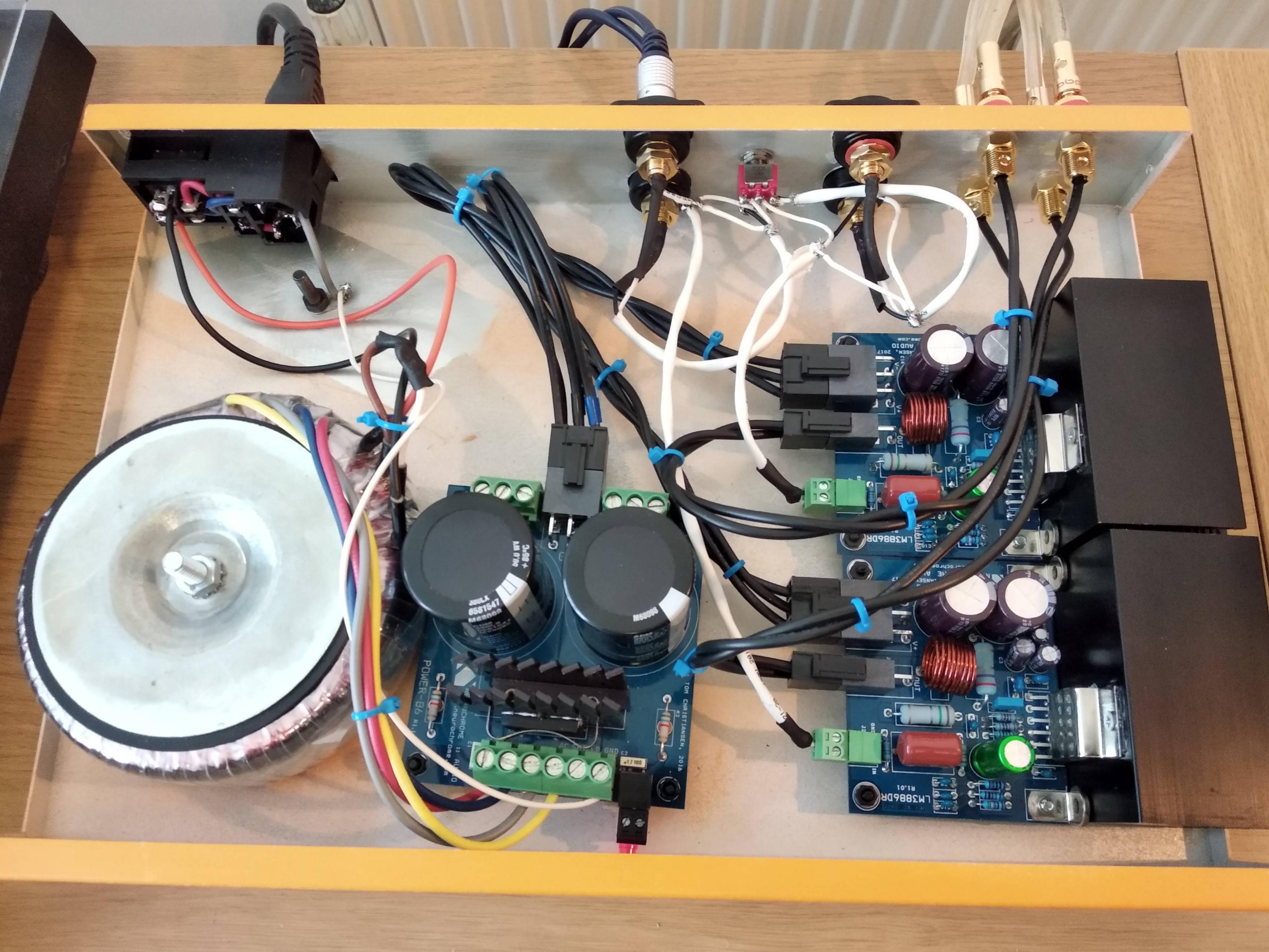

Thanks for the heads up about the photos - hopefully that's them attached now:
Do you think that the noise could be avoid by using the TV's optical output to a DAC? It doesn't sound similar to ground loops I've heard in the past - it's more static-y than buzzy. Although now that you mention it - perhaps I should just go to bed and read; sod this whole DIY Audio deal 😉
Yep. Thank you! Looks good, by the way. I hope you have some ventilation holes cut for the heat sinks.
That'll work. As long as you don't have a ground loop between the DAC and the amp. If you have a DAC available, it's certainly worth a try.
Tom
Yes, you definitely want those heat sinks open to free air, otherwise you’ll likely dramatically shorten the lifespan of the amp chips.
Ah, that I do not have. Any recommendations on how to approach that? I guess literal holes bored through the side would be one approach, or perhaps routing a channel on the inside that exits at the back?
