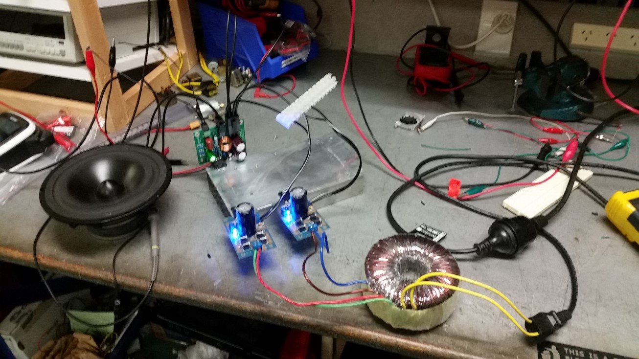

I've been absolutely flat out with work, but slowly chipping away at getting this finished - thankfully a lot of the work is getting me familiar with CAD which I will use to the benefit of this project.
I ended up buying a new toroid as the other one is going towards a build with an integrated pre-amp. Nothing fancy, 2x25v/300VA.

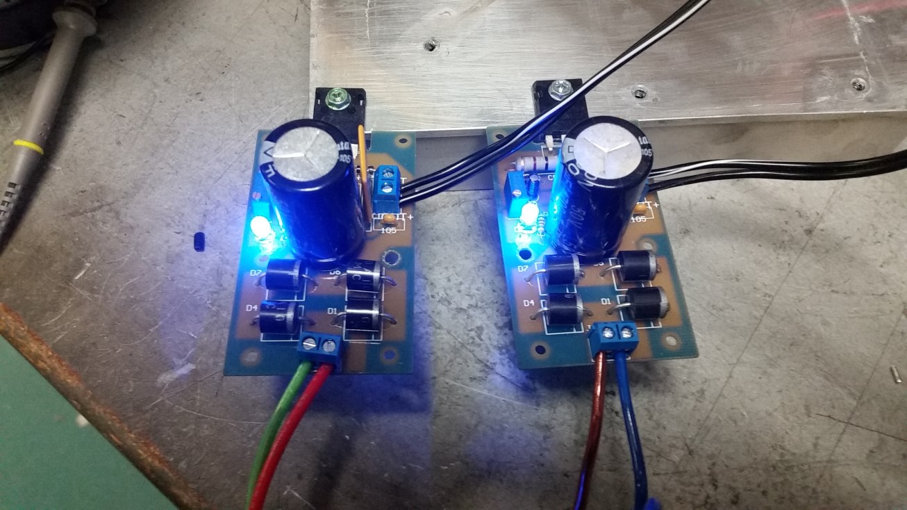

Got the two eBay regulator modules (set to 30v output) set up on an old heatsink with a mica washer, along with one amp module (was doing this at 8pm at night so didn't bother hooking up both).
Ran a 50Hz sine wave (as a stress test) through one of the spare speakers for 10 minutes continuously @ ~30w output. Zero voltage sag even when increasing this to 50w output. Pretty happy for $30 worth of Chinese power supplies!
Good news is there is no audible background noise, and both the regulators stayed completely cool in this time, with the LM3886 getting fairly warm to the touch (but still cool enough to hold my finger onto). I know this is a fairly big chunk of heatsink and only one module was running, but on the final assembly the results should be similar.

For the final assembly, don't forget the thermal goop on those mica washers. Or better yet, use one of the SilPad thermal pads intended for the purpose.

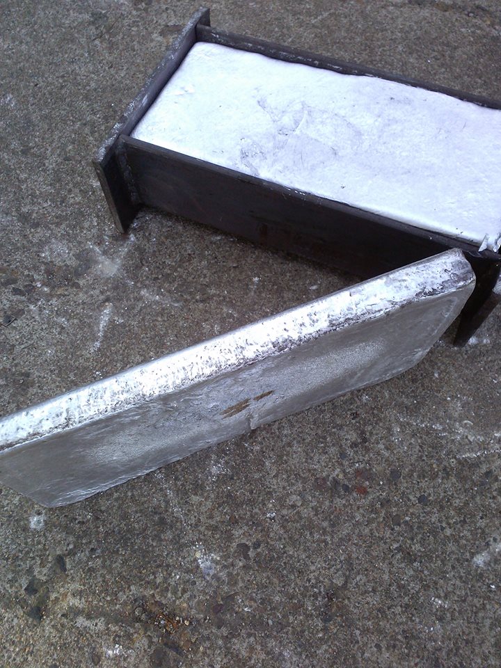

Well, this takes things back a step. While I was working on machining the cast slabs of aluminium up, somebody was playing around in the electronics lab with a 2kw electric skateboard. Somehow, they managed to crash it into the storage shelves I was using which knocked all my stuff to the ground.
Snapped the IC's off both of the regulated board and bent the 3886 up really badly 🙁 I've managed to carefully rebend the pins on the 3886 back into place, however the regs on the power boards aren't repairable (and it's more expensive to replace them than the entire board).
I've ordered new boards which should be here in the next week or so, however they're slightly different so I won't get too far with the machining just yet.
