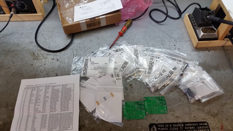

Hey guys,
a few months ago now after a failed attempt at buying a chipamp.com kit, Tom mentioned he would be making the LM3886DR Kits, so I immediately put my name down for the first one. It turned up quite a while ago, however I've had a busy few months and haven't had a chance to start putting it together until now.

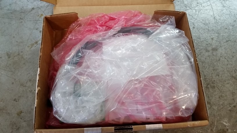

Cutting the box open, everything was individually bagged and labelled from Mouser - so much more convenient than trying to figure out a handful of components. Thanks to Tom for helping me out with getting all components along with my boards.
Printed off the design documentation - super comprehensive and walks you through every step of the build (including about as much information on the chip as you're going to find anywhere). Easy enough to follow that providing you can solder, it's pretty hard to go wrong building this kit.

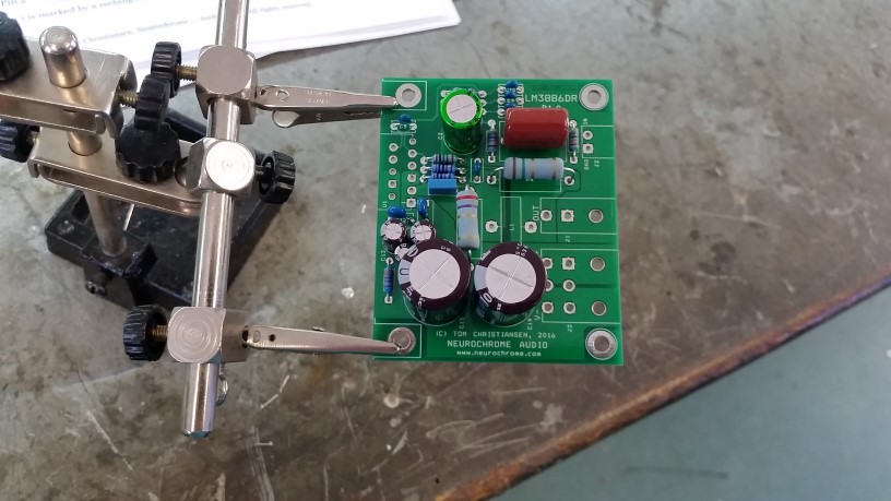

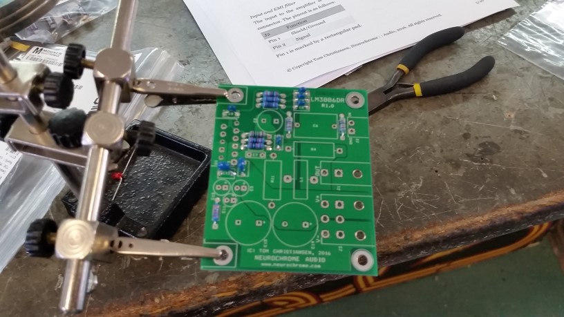

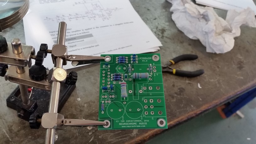

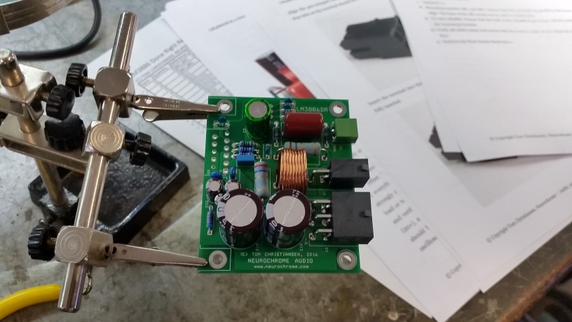

Started populating the boards with resistors. Again, having everything bagged and tagged makes this process super easy.
Power resistors in. Left 5mm gap for airflow around the resistors.
All caps in.
Connectors and inductor in.

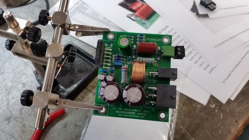

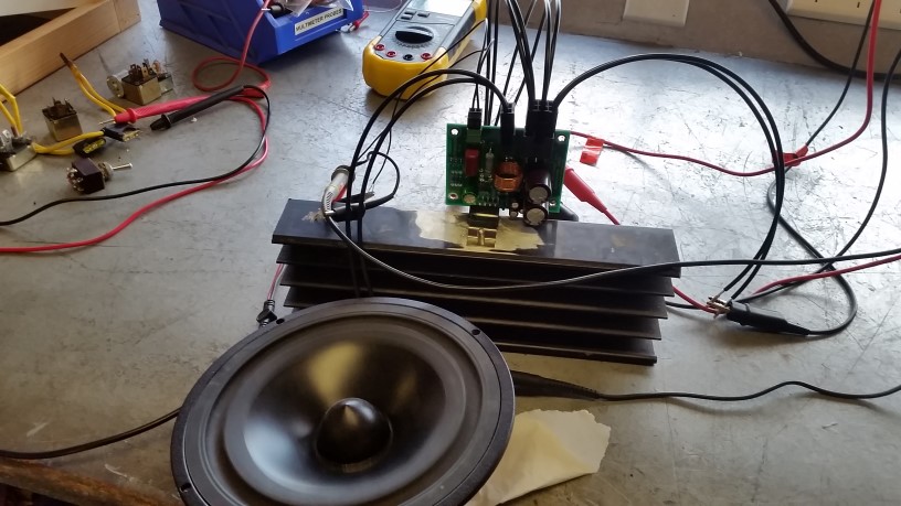

LM3886 in (easy to solder, was annoying trying to lift it a pinch off the board for clearance - more due to my fat hands than any issues with the kit).

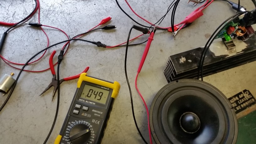

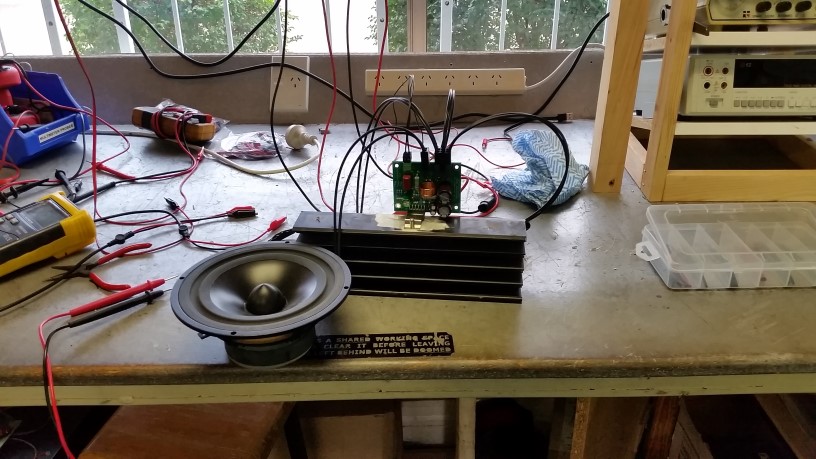

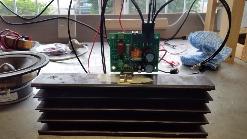

Chip attached to temporary heatsink for testing. Definitely overkill, but I had it floating around. Checked DC offset at the output - 3.5mv; perfect.
Attached to a test speaker and lab power supply. At the start of testing I was hearing some terrible things - the cone flapping around, continual cracks and pops, etc. Figuring I had something wrong I went through and verified all components with no success - turns out I had a faulty signal generator! Switched over to another one and it was perfect.

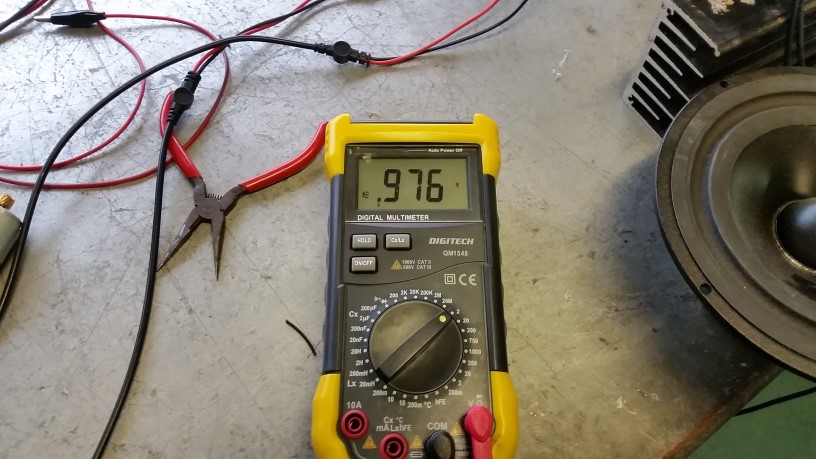

Had a few other people in the workshop so tried to keep test volumes low - 400Hz sine wave input.
And speaker voltage. Near enough to +26db gain
Unfortunately I didn't have time to put it on a scope, but I'll try for that over the weekend.

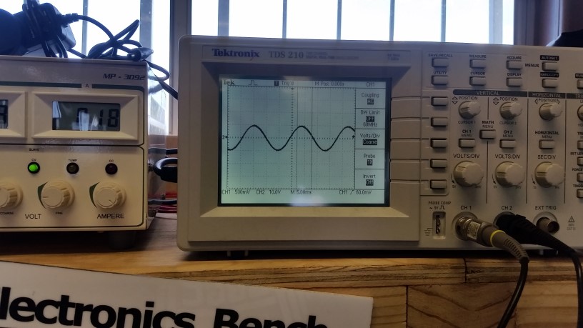

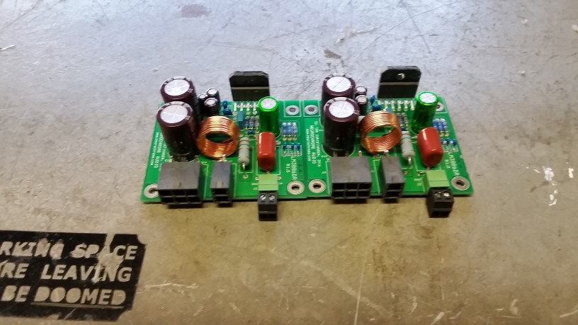

#2 built and on the test bench. Again, pretty much 26db gain on the dot. You can see the poor cone having a fit with 50Hz haha.
Scope set up with input and output signals. 500mv/div on input, 10v/div on output - perfectly lie on top of each other (outputtinga bit under 50w here, if I remember how to math properly).
Both boards side by side.

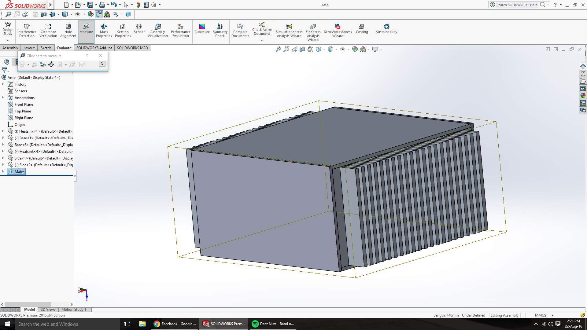

Now, for the enclosure. Original plan was to put it into a 2RU enclosure, along with a pre-amp and some other bits and pieces (including a handful of modified eBay regulated PSU's that I've tested to 30V/5A output), but I'm thinking I might cast some aluminium and machine an enclosure on our CNC and go for a no-frills approach. We've recently got set up with a fairly decent foundry and have ~1000lbs of scrap aluminium, so it's a possibility! I've also got 500VA of recycled 24V transformers that I can use, along with a few toroids
Math is Pout = Vout^2/(2*Rload) with Vout in volt, peak.
or: Pout = Vout^2/Rload with Vout in volt, RMS.

That's about what I figured; close enough to 50w!
Knocked this box up in Solidworks, but the guy helping me CNC said it's not 'sexy' enough (he's a crazy German engineer haha), so we're redesigning. Still undecided if I add a preamp and some other bits and pieces in or not, I'd love matching PSU/amp boxes but running a preamp with that just complicates umbilical wiring.
I'd shy away from umbilical cords. Using such cords increase the supply impedance which will degrade performance. There's no need to keep the amp and supply separate.
Tom
Tom
Tom
