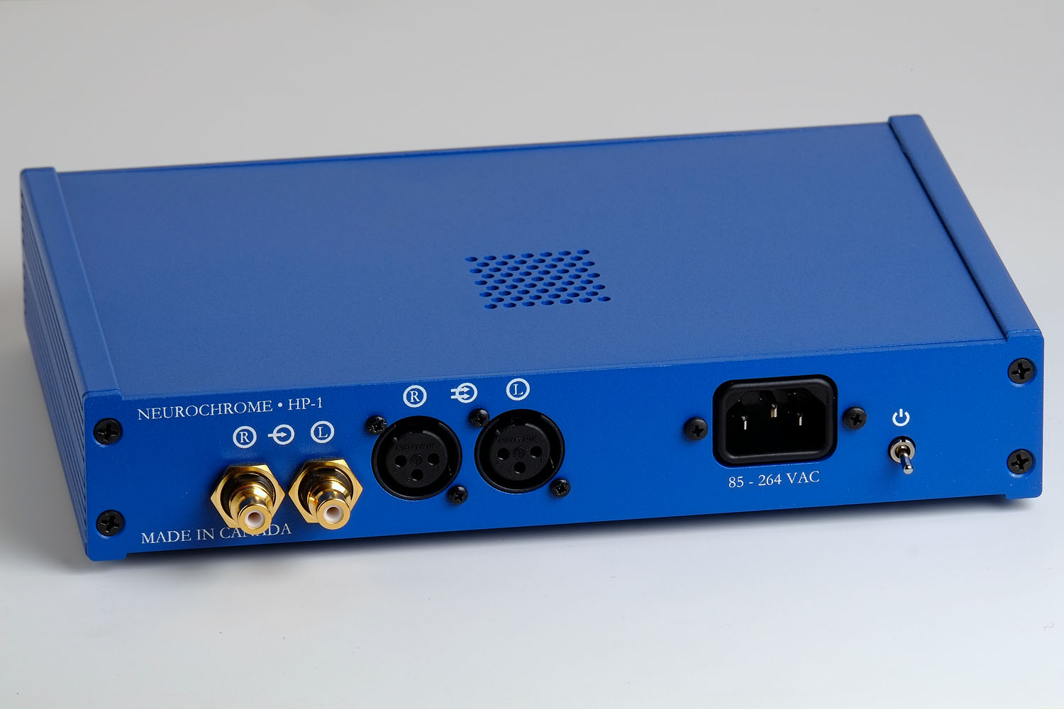

Now in blue. Enclosures are in stock and the documentation is almost done. Yay.
All components are provided by Mouser Electronics. The volume knob, RCA connectors, chassis, hardware, and feet you can get from me. Bam! Done!
Tom

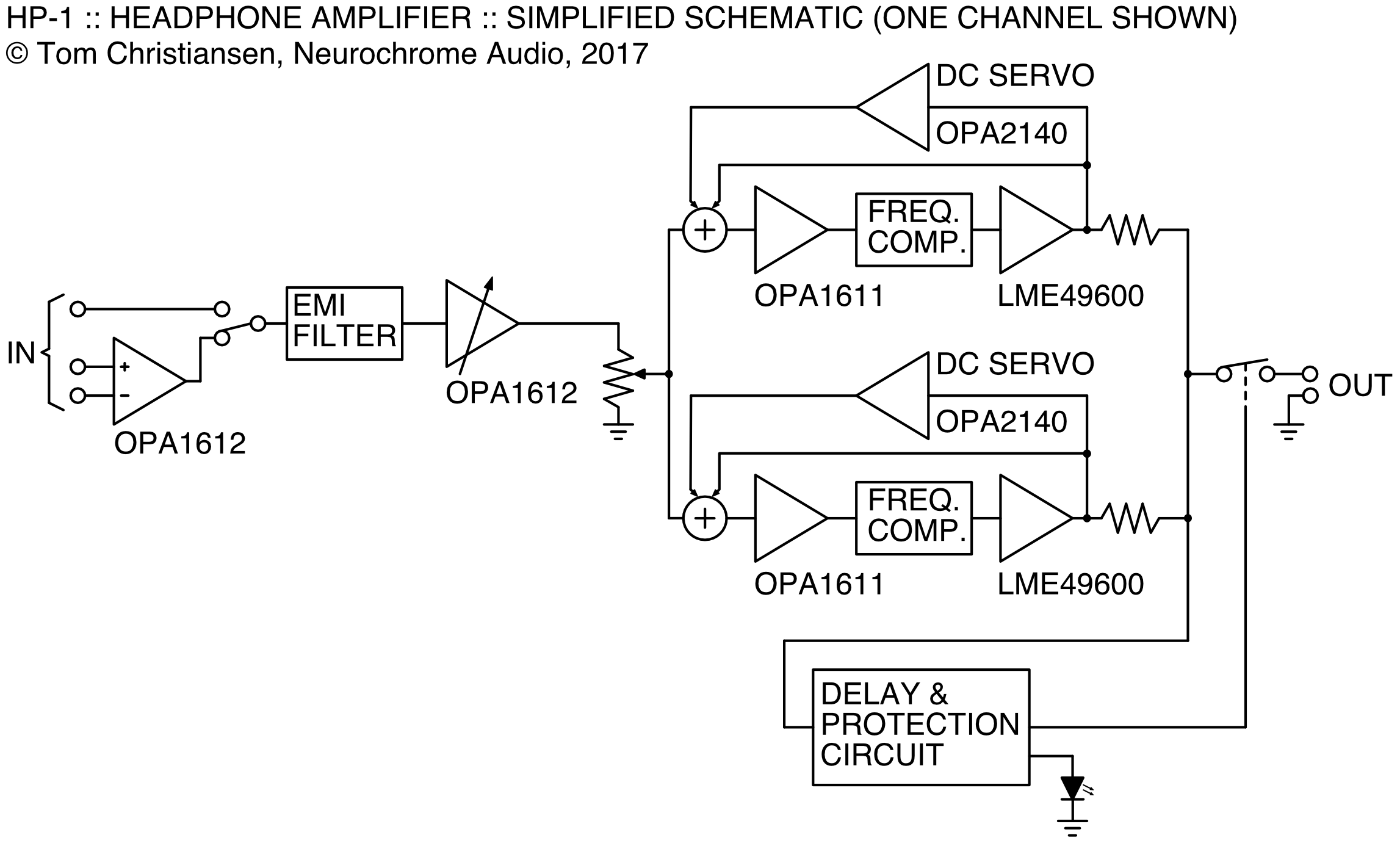

A question - what is the output impedance? I just looked through the specification listing on your site and I didn't find it. I'm just curious if you have a series (output) resistor after the looped OPA1611 + LME49600 pair or not. I'm guessing not, since it sounds like you have designed to maintain phase margin for the expected headphone/cable capacitive loads. Probably no need for the resistor to isolate load capacitance.
Whoops - didn't know it was parallel. 🙂 Yep, agreed, I have 1R on the output of each op-amp half in my parallel ODA amp (3 dual NJM4556AL on each channel) for the same reason. 0.5R is just fine, IMHO, insignificant damping factor effects. Thanks for the reply!
