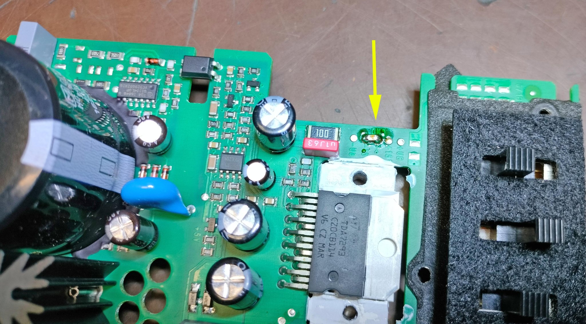

I have attached a photo of the board

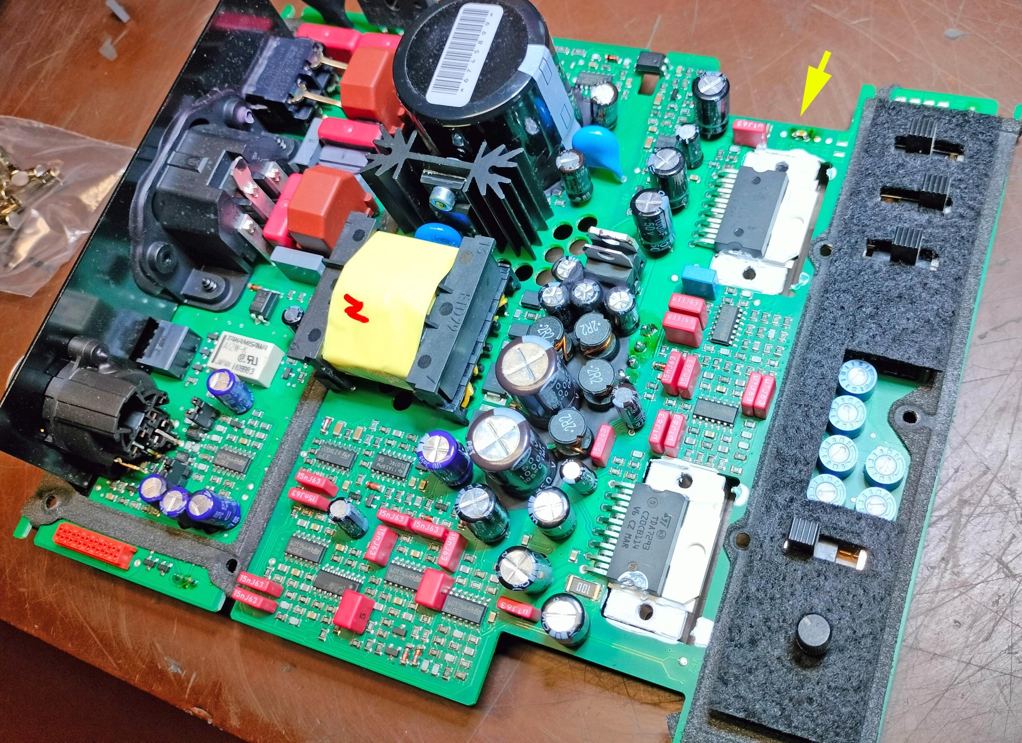

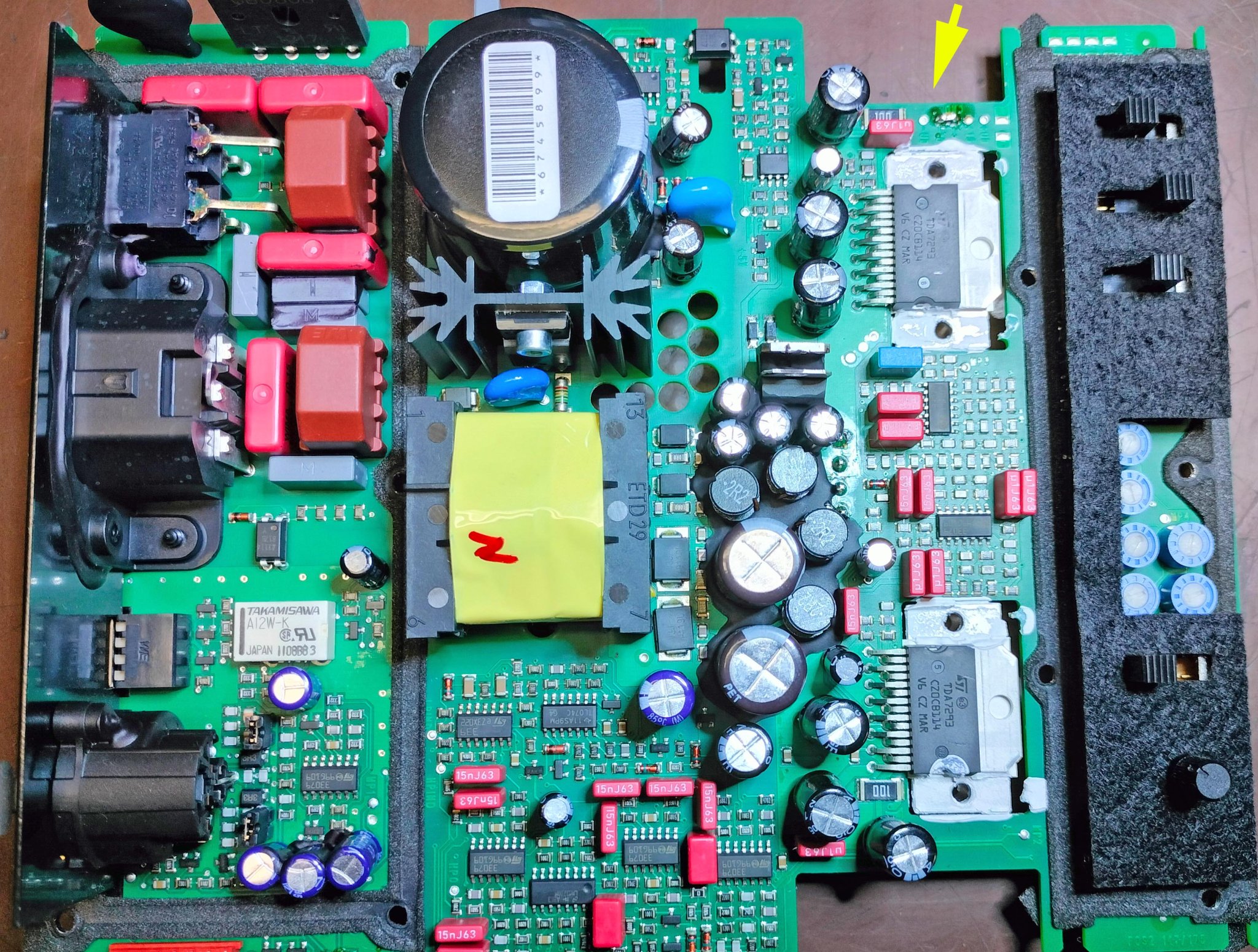

At my KH120A the fuse burns too. I have dissambled the monitor. Is there somebody here who can try to fix this for me?
