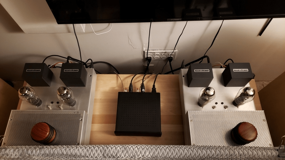

The characteristic that matters to me is low risidual noise. I'm using PA coaxial drivers with horns on my main speakers, and the first processor I bought was quite noisy. Despite having massive L-pads on the horns, the hissing was significant. But when I replaced it with the MiniDSP HTx, the noise was gone. I can just barely make out a slight hiss if I put my ear against the horn now. (Everyone says, "it's a ground loop" or something similar, but it isn't. It's just high sensitivity horns. I'm kind of tired of that conversation, so let us not go there? Thanks.)
I would just check to see what models are compatible with DC. My 2018 SHD was fully compatible once I applied all of the updates.
Horns with DSP is quite viable.
I used the SHD with DIY analog XO with horn based system and it was quiet without padding. Current system is only stereo with MiniDSP SHD Studio into Danley SC-48 to 4 way speaker systems. It is possible to find gear that is quiet enough not to require padding the horns. Horns on mids and highs are 110dB efficient and quiet.

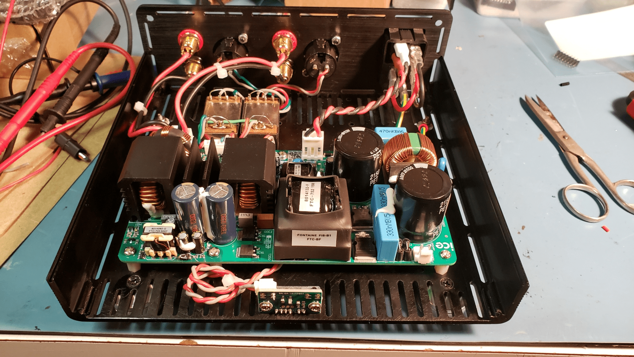

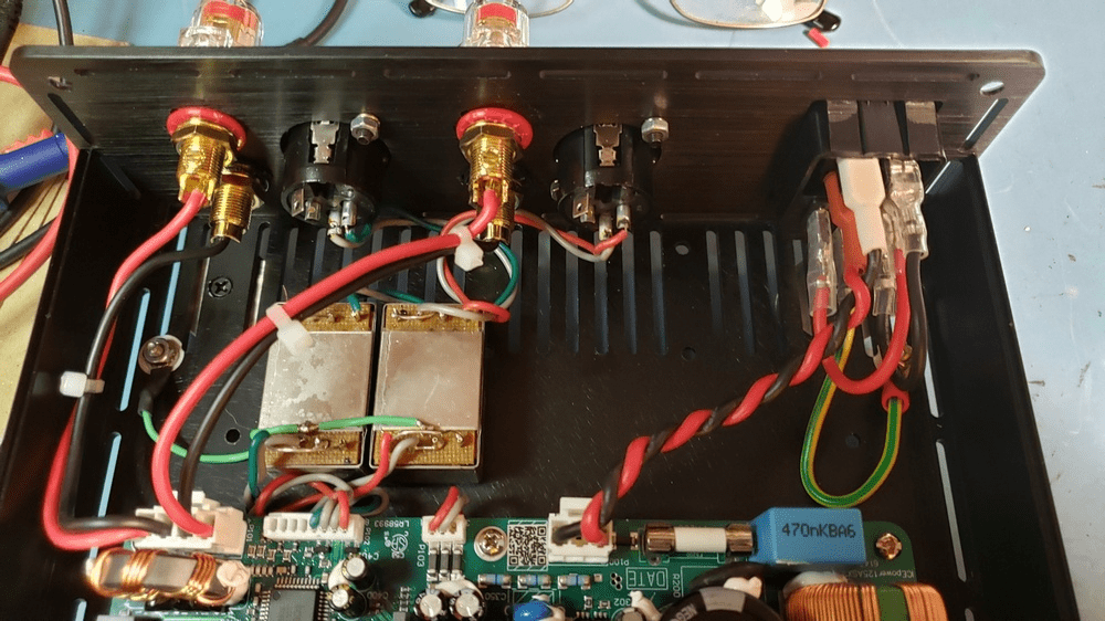

I am using Icepower 125ASX-2 to drive my Onken bass cabinets (Iconic 165-8G woofer) from 45Hz - 890Hz and have no complaints. (Very clean and quiet.) I use diy 300B SE amps to drive the horns. (A-290/TD-4001 and STH100/HF10AK) Subs are class D. Cabling in the analog domain is balanced XLR, and in the digital AES/EBU at 2496.
I built mine with a 125ASX-2 module I had to import from the EU, and a box from Ghent Audio. https://www.ebay.com/itm/325321243371. I replaced the RCA with XLR and added a pair of Lundahl 1544 transformers. You might want to shop around for the most cost effective solution since you need a lot of amps. 😀

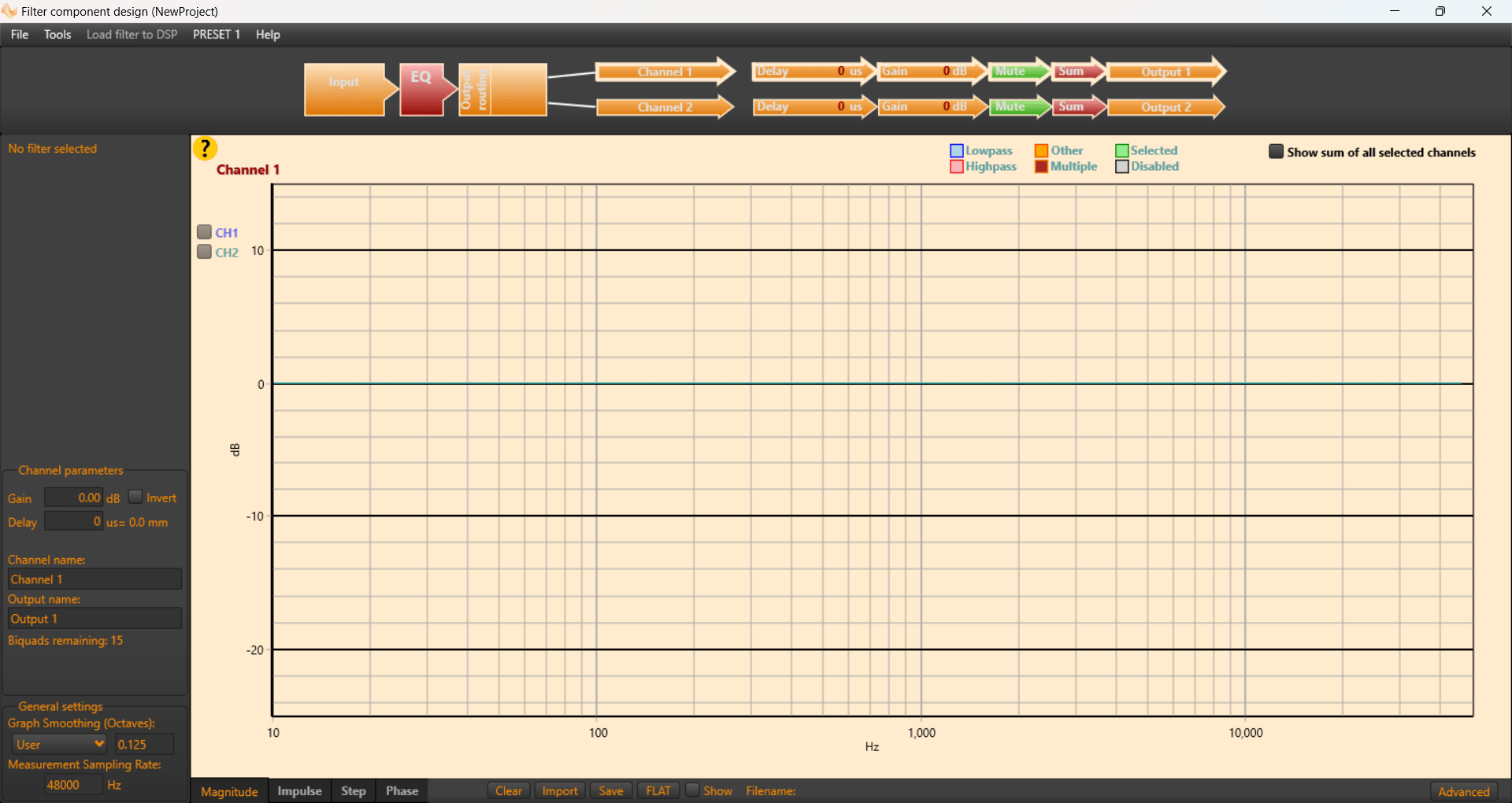

I'm looking at the Hypex website, but I'm not finding manuals that explain the unit's DSP capabilities in detail.
The hypex has "15 biquads" vs the MiniDSP's 6 PEQs (+ high and low crossovers). I'm not sure if "15 biquads" is more or less adjustment than the Minidsp? From what I've read, it sounds like you need to stack biquads to get high order filters, which will eat up biquads pretty fast. I assume the crossovers are also entered as biquads, so those 15 biquads may end up being about the same amount of adjustments as the MiniDSP?
I have used the Hypex Fusion FA 503 and the FA 253. When you consider the cost of equivalent amplifiers, miniDSP, speaker cables and coax cables these are a bargain. I actually configured speakers with the miniDSP, separate amps etc and then did a second system for the same customer with the Hypex. The Hypex system was much more compact and simple in the end.
You can download the Hypex software anytime. Go to the Hypex website, on the page for the plate amp, click on the downloads tab, scroll to the bottom. There's a like to HFD Hypex filter designer. In the .zip file is the software and a .pdf of and extensive manual explaining all the filters and amplifiers. Without the amplifiers connected you can configure and save filters. It enables an additional page of amplifier configuration when you are connected to the actual amp. These are the model specific gains, inputs, limiters etc. To add a filter you just click on the response graph and it puts a little dot there and you right click on that dot to change the filter parameters. It's a little weird. You stack dots in the same place on the graph to cascade 2nd order filters to produce 4th order etc. There are 15 2nd order biquad filters per amplifier channel. So that's plenty. Yes, those are used to produce the crossover and driver EQ. I think there is another set of filters for the input signal to do room correction, just like the miniDSP. They enabled FIR filters several months ago. They run at a sample rate that was unfamiliar to me. See the .pdf
