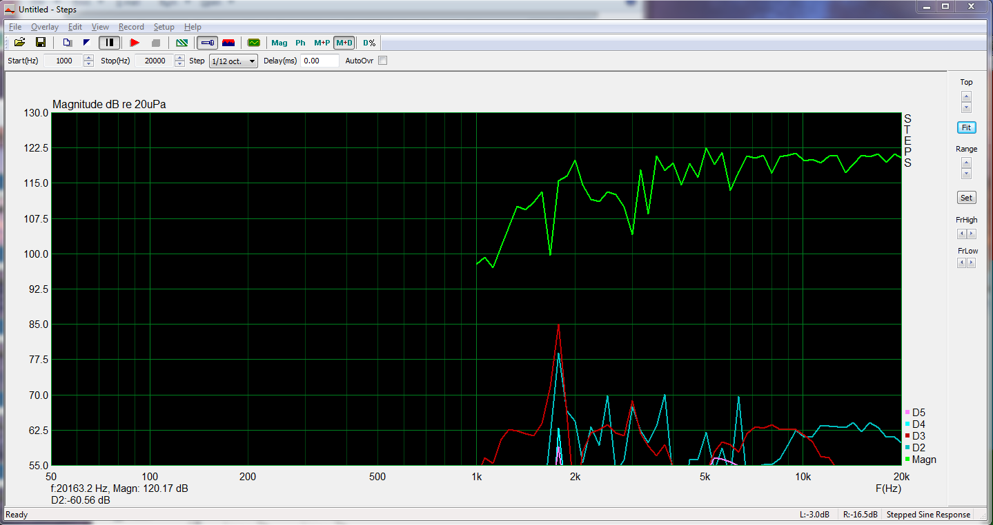

So I took measurements from various locations and the drivers seem to sum pretty well at my listening position. I've attached a response graph at the listening position which shows decent in-room frequency/phase response. This was captured when I had the xo set to 2500Hz but the poor upper treble sound persists. Even tried 2200Hz 4th order to no avail... I don't think I can go any lower with this tweeter....

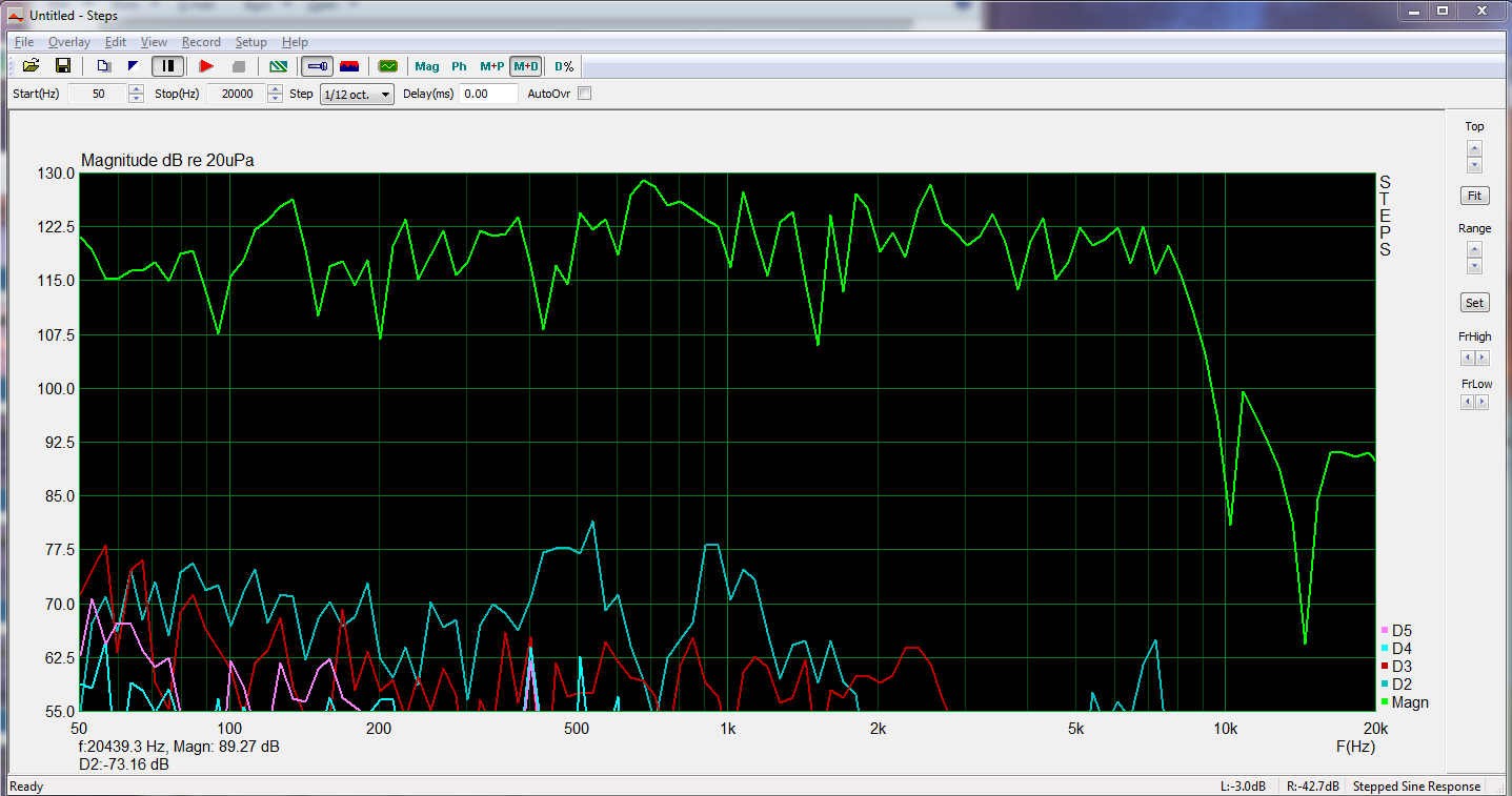

I was able to run distortion measurements on both drivers and nothing really stands out that wasn't already known. The low end of the ribbon is a little rough but otherwise it all looks pretty decent.
I ran CSD and that is where things got interesting. The Neo3CD seems to ring like a bell. I'm pretty confident it's not cabinet resonance as the minimum baltic birch width is 3/4" but much of the cabinet has 2x3/4". There is a cross brace inside and commercial fabric padding on the side walls.... Guess I need to invest some time and money into an accelorometer to really know for sure:)
To be fair, this CSD was run in room and not in my typical measurement setup however the first reflection in the IR was gated out..... I've done many, many CSD measurements and this is the first time I've seen something that looked this bad......

I have used Fountek NeoCD3.5H also without the horn. Nearfield response looks a lot like NeoCD3.0. Resonance at 1,5kHz is huge, LR2@3000 is definitely out of question. Acoustic LR4 around 3000Hz could be minimum. The horn gives huge boost for low freq, this version can be played much louder or crossed lower with eq'd response.
Here is my csd and distortion without the horn. Looks pretty much like jf's NeoCD3.0

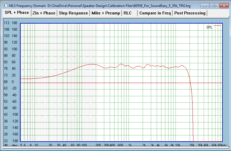

Happy Easter all! Just an update.... I've been playing with this Neo for quite a few days trying everything imaginable and nothing sounded quite right.
I dropped the Seas Millennium in and set the XO to 2nd order at 1.5kHz. Left BSC in place and took a guess on the attenuation for the tweeter in miniDSP. Amazingly, my first try I got the attached response graph (note this one is using 1/12th octave smoothing but looks better because I'm measuring from the center of the room and reflections properly)! This combo sounds waaaaay better then the NeoCD3.0. The 15W/8530k00 is much happier with a tweeter that digs deeper and my ears are very happy, especially considering the phase all lines up nicely. Hopefully I can execute the passive XO as well as it sounds with miniDSP. This is a formidable bookshelf.
