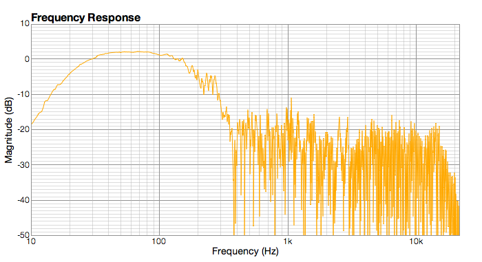

Qts should be about 0.5. With the right parameter set one probably can get away with a simple low pass filter. Let's wait and see how the SLS-12 Ripole turns out.
Here's the frequency response at the front chamber (24dB lowpass @ 150Hz, no EQ):

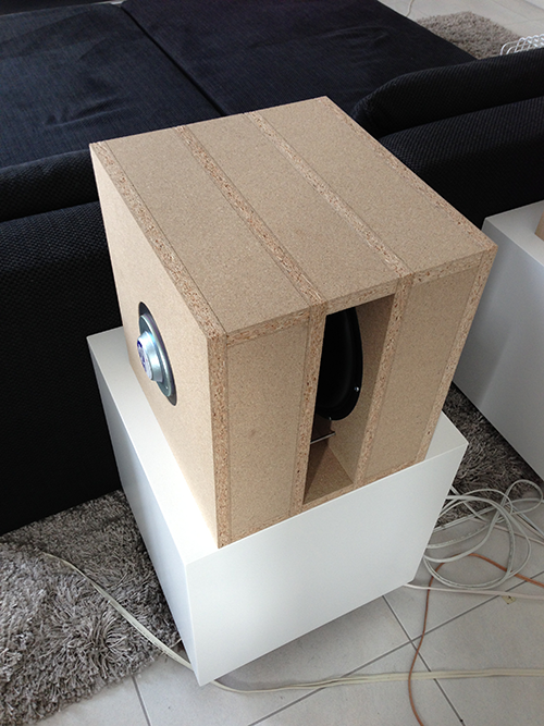

InDiBA 16.2 a different Slot Loaded OB Project
Work in progress...
Nearly at the same time I presented my version of SLOB with high WAF in a small cabinet.
I'm totally astonished to see this thread working with same principle, collecting chassis area by arrays of chassis in a slot.
I think we are invented to combine all our KnowHow to go ahaed.
Some more words.
My InDiBA 16.2 started as a low cost event but went to a concept of scalable SLOB.
What's new ?
InDiBA is a synonym for Integrated.Dipol.Bass.Array and it means something similar to a W-Frame but with an array of chassis in a special arrangement.
First I want to have a small box/baffle, so I need to compress the chassis as close as possible and I did.
16 x 5" Sub plus COAx-Tangband >> 18,5 x 94 x 34 cm³
Later on I did some homework in Germany: Sorry, search for:
DE202012008642U1
It's only to be shure no one will earn money with my ideas.
wr
Wolfgang

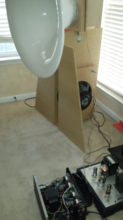

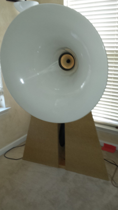

I finally finished one of the bass unit for my Lowther horns(PM7A). I'm using the horn full range to about 150-160hz, and using mindsp for Xover and EQ for the bass unit. I'm not sure if the JBL 2226J is a good match for the design with a Qts of .31 and Fs of 40hz. But I have 4 lying around , and they are efficient with good power handling capabilities. So far with preliminary test and listening with only one unit ... They sound very natural and is usable to about 35hz and matches my horns well. I need to build the second one and start tweaking

It was suggested to me to use 1/6 to 1/8 of woofers SD, I'm currently using the slot opening area of 1/3 of SD of the woofers. What are the pro and cons of using a smaller opening ?
I'm guessing:
Pros: Higher pressure at opening
Cons: Possible damage of drivers due to higher pressures ?
Drivers are JBL 2226J with MiniDsp as Bass Xover.
