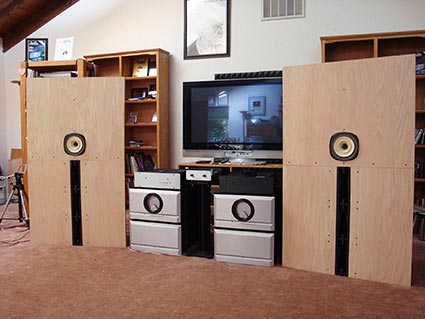

How did you mount the drivers? On the slots or the outside panel on the sandwiched plywood?
On the slots. Back side was also open so there was no blockage form the outer layer of plywood (1/4" ply was used).

... I'm just contemplating about worthwhileness of converting my plain OB's with a single Beta 15 into something like this...

I'm now working on another version with one driver facing foward...
It's now OK to go. (and please ignore my unfinished style of finish)
Rear mounting:
In position, with removable 'door' for an adjustable slot:
The slot in the picture above is 10cm wide, and about 35% of Sd. Later I tried various slot areas, including the largest (i.e., no) slot.
I settled at slightly larger slot then the above, 12cm wide, about 44% of Sd, for now.
When using the smallest slot (10cm, 35% of Sd), the bass sound tends to be "heavy" at the bottom end. It's not slow, but the effect of giant's steps is too much. Fun in the first few mimutes, gradually annoying.
OTOH, without slot, it's acting like a normal small OB. The slam is lighter, an open and easy going sound overall.
Between the two extreme, I settled at 44% Sd of slot for the time being, a comfortable compromise - bottom end with proper strength but not too heavy-footed.
These sound quality stuff might be nonesense to some. I understand. I can't do meaningful measurements for these, so no fancy chart whatsoever. The construction of 'door' shown above is super easy. Anyone can try that if interested.
BTW, measured by WT3, the smaller the slot, the lower the fs. It's now 15Hz or so.
