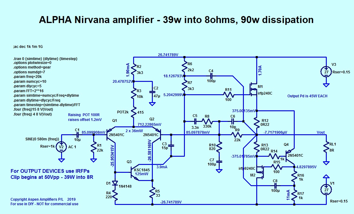

These are Hugh Dean amps but I'll try to describe what I think are teh differences. The Alpha Nirvana's active CCS is no longer based on the Pass Aleph topology but a PNP-BJT controlled P-channel output MOSFET with symmetric sense resistors. It also has some refinements in the frequency dependent feedback to give it higher damping factor in the bass region for excellent grip of the woofer.

Is there any advantage of building the alpha 20 over the alpha nirvana?
I am only wondering why there is still interest in alpha 20 if a better more modern and better sounding alpha nirvana exist?
Simpler PCB that is UMS heatsink compatible with MOSFETs directly mounted to PCB. The sound is still excellent.

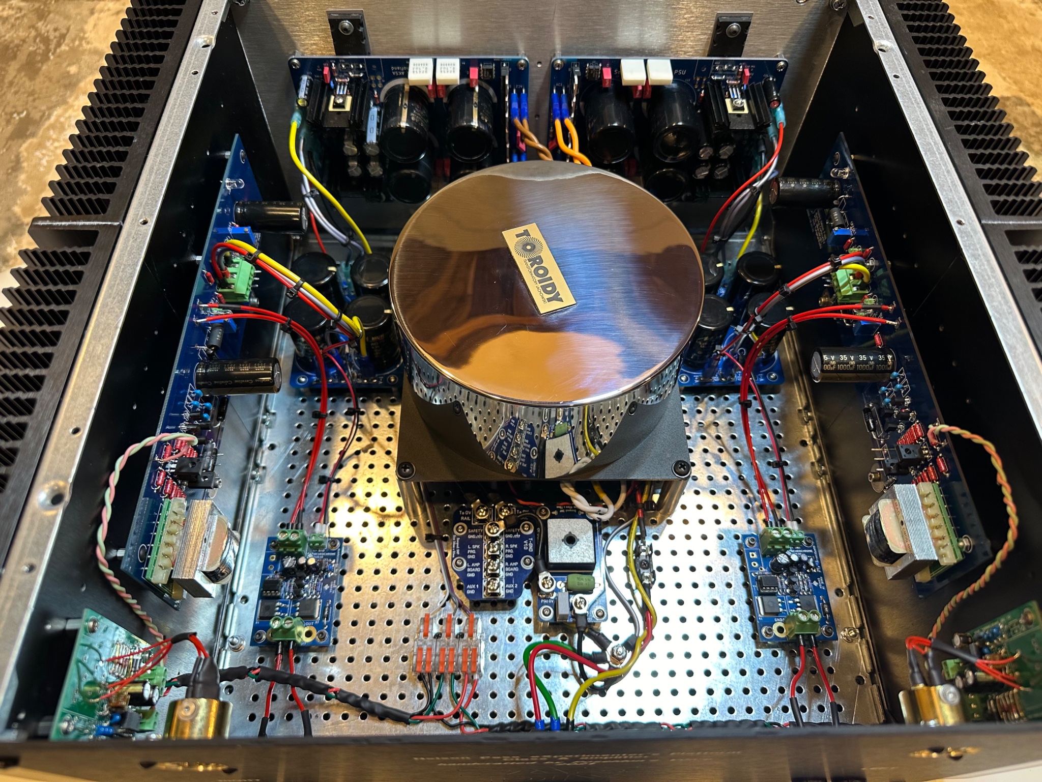

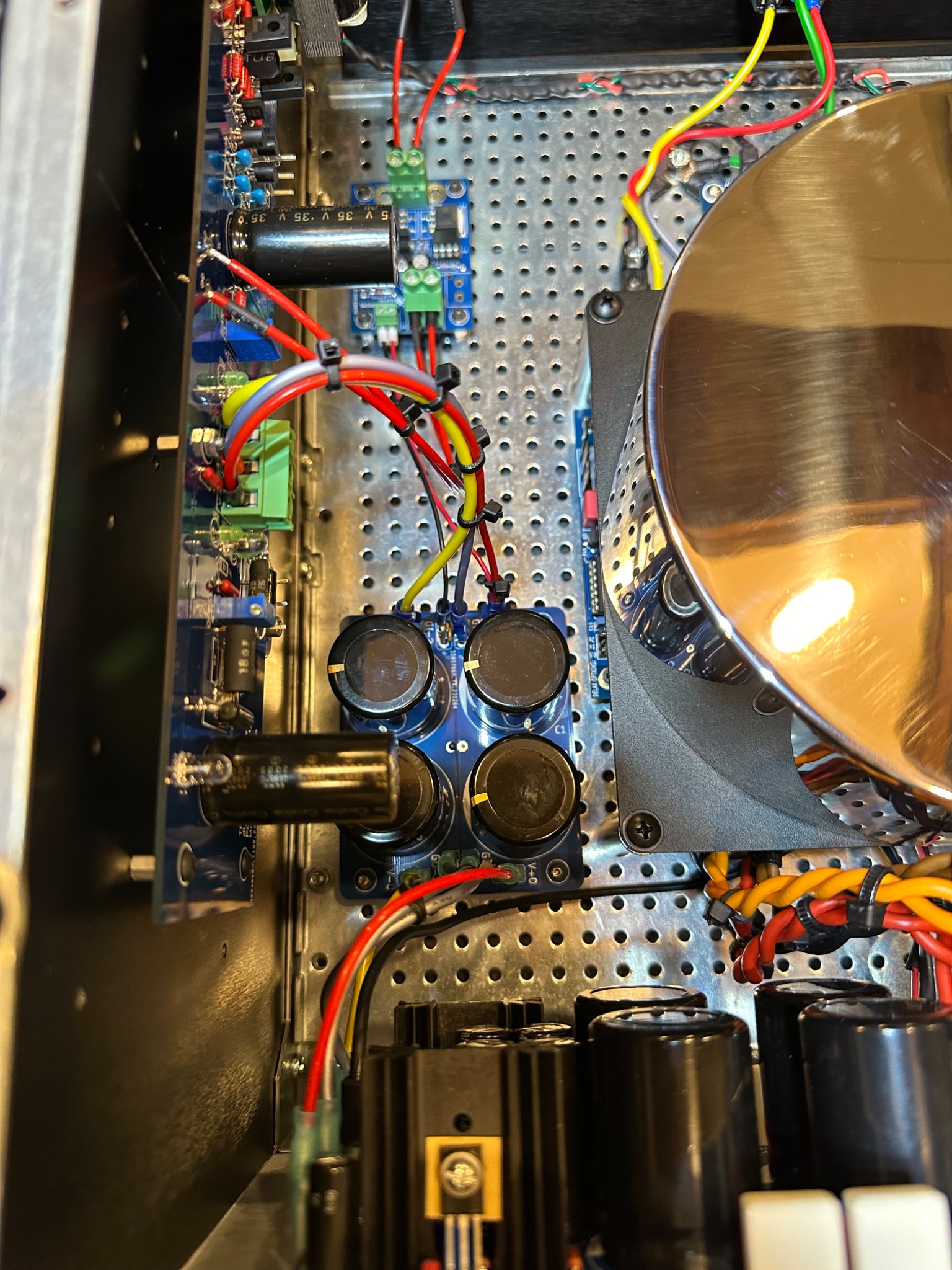

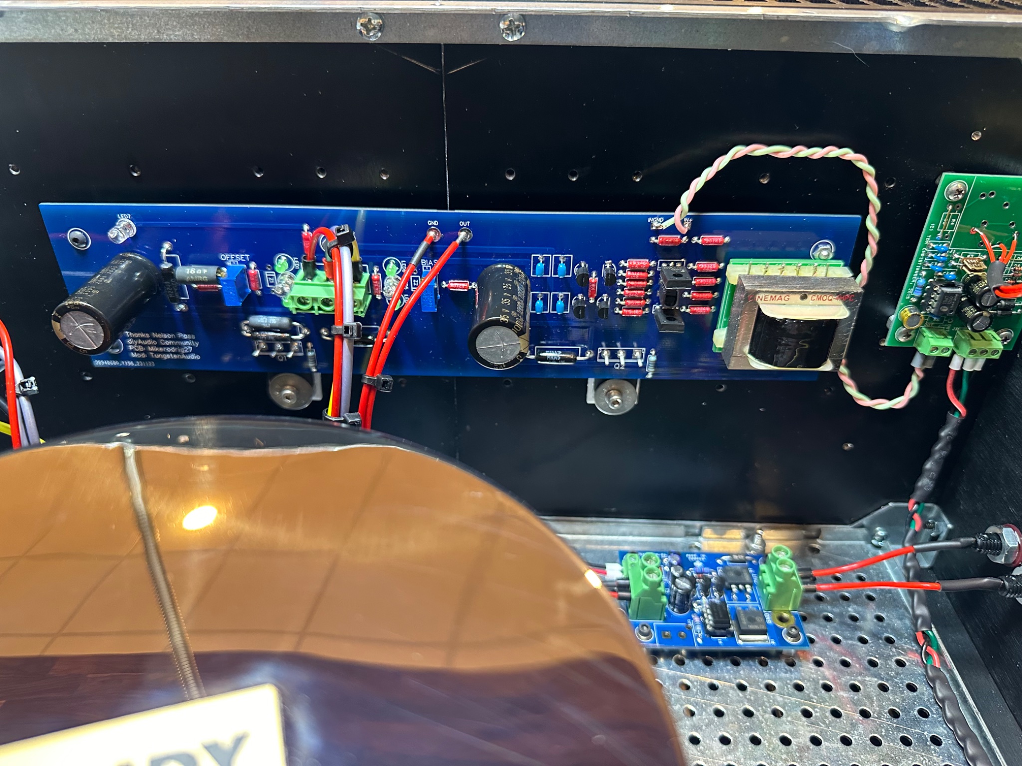

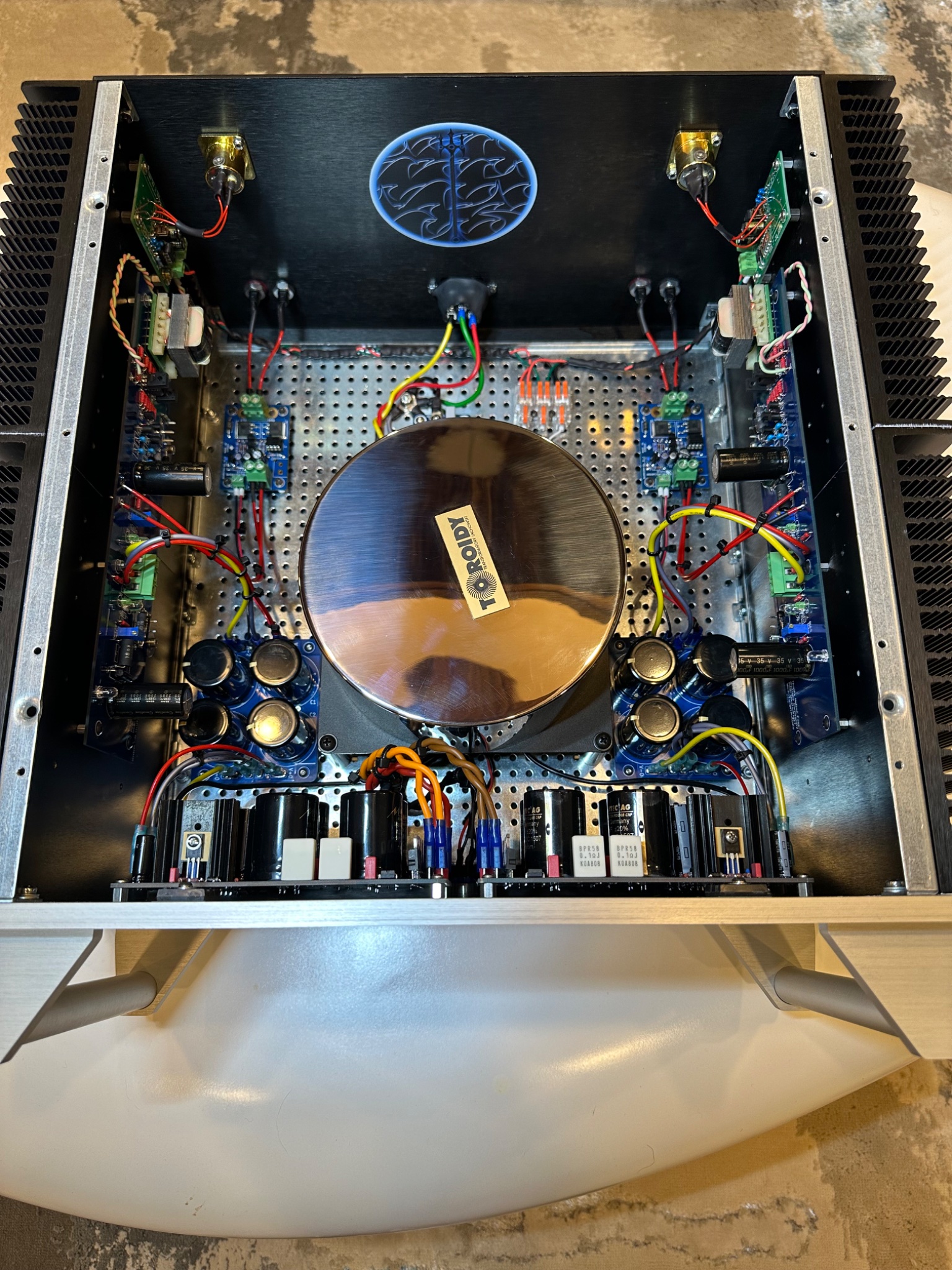

Time to resurrect this thread! It’s been a bit and I’ve been busy, mostly tending to myself and my health since DIY does take up a lot of one’s spare time.

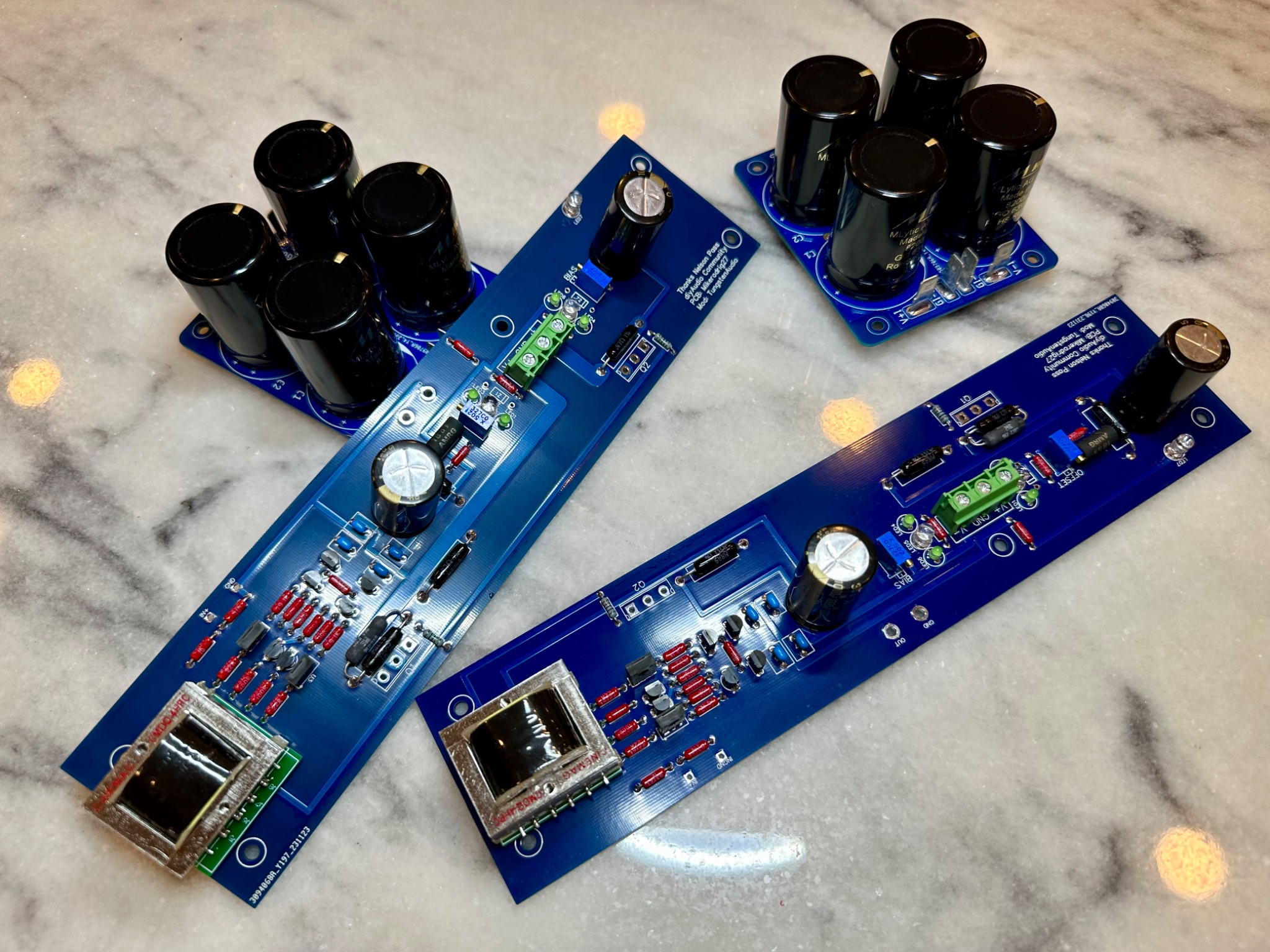

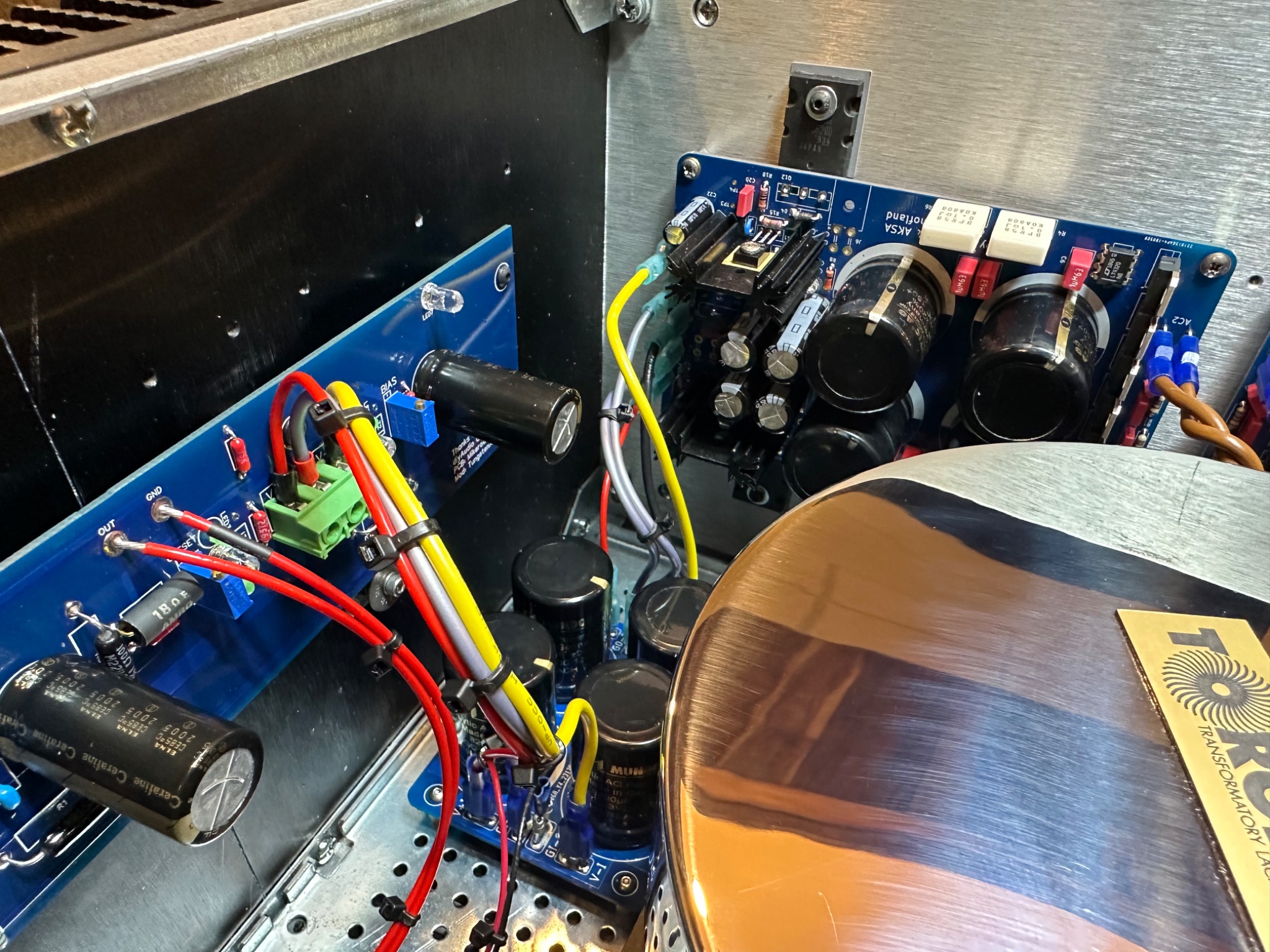

Earlier this summer, I decided to rebuild my NPXP which had my Alpha Nirvana encased in it and sounding super nice. This time around I implemented Tungsten’s excellent version of the F6 which has everything I would hope for and is scaleable for power as well. My supplies remain +/-24V so we are mostly sticking with 25 watts/8 ohms and 50 watts/4 ohms. In addition I used the IXTQ75N10P output mosfets which sound divine in this circuit biased at 1.8A. For the transformer, I had some Cinemag CMOQ 4HPC (80% high nickel) pressed into service. Finally, I added a cap bank, about 32mF/ch as I recall.

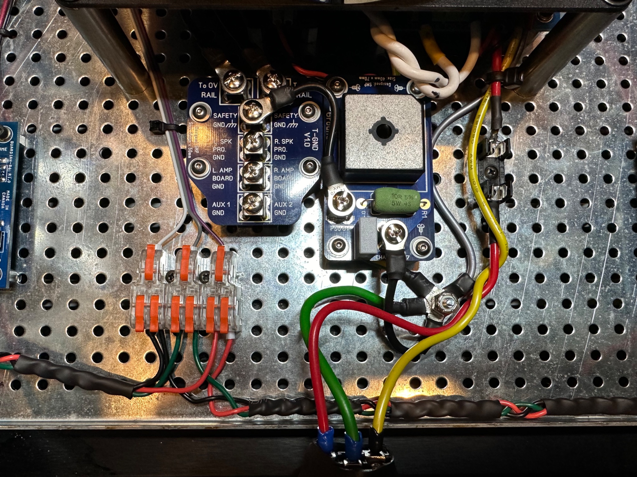

I was disappointed with the internal organization of my NPXP (see 2nd photo, 1st post of this thread) and particularly the grounding scheme. So what you see is something more organized. With the ground lift circuit in place and the T-board, it’s a very quiet amp rendering all the minute details I love to hear. DIY builds are all about the subtle details and tweaks.
Best,
Anand.

Good to see you back Anand! Great looking build as usual - is this one I’ve heard???

Anand,
Beautiful work... kudos!
The neat organization, the multi-colored colored wiring with mirrored curves/twists on both sides, multiple circuit boards, and the shiny transformer in the middle somehow reminded of something out a Sci-Fi movie...🙂
Great to see more action happening on your NPXP platform.

How does the F6 sound compared to the others?
More neutral than the Aleph J variants and other single ended output stages on this platform. Much more resolution than a standard F6. More harmonic texture. Tight clean bass, not as deep as the finest Class AB designs but good enough to be honest. Staging is wide and deep. This is in fact my first push pull design in the NPXP. Since my main speakers are 96dB sensitive, the 25 watts/8 ohms and 50 watts/4 ohms (nearly all of it in Class A since my bias is at 1.8A) power hasn’t been an issue.
Tungsten’s marriage of Mark Johnson’s “Austin” input board + Cinemag phase splitting transformer + N channel high transconductance MOSFETS is a good one! I hope @Monk55 completes his build! We missed him at BAF24 this year!
Best,
Anand.
