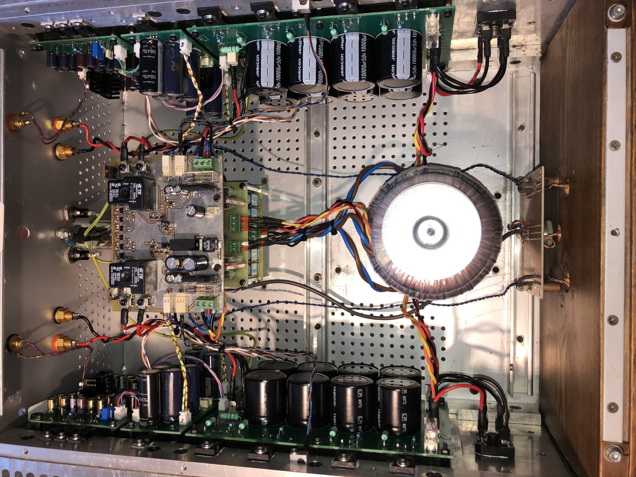

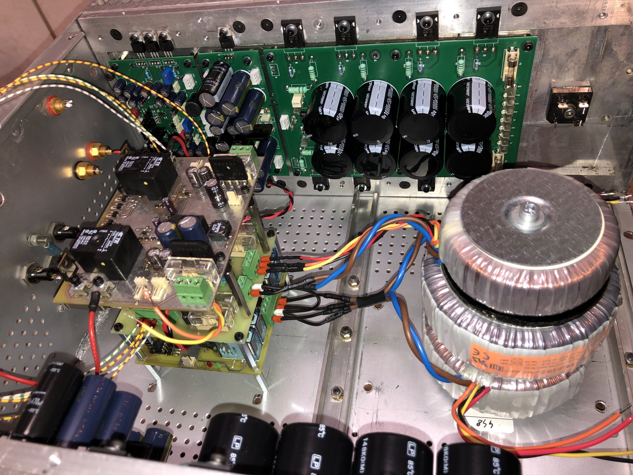

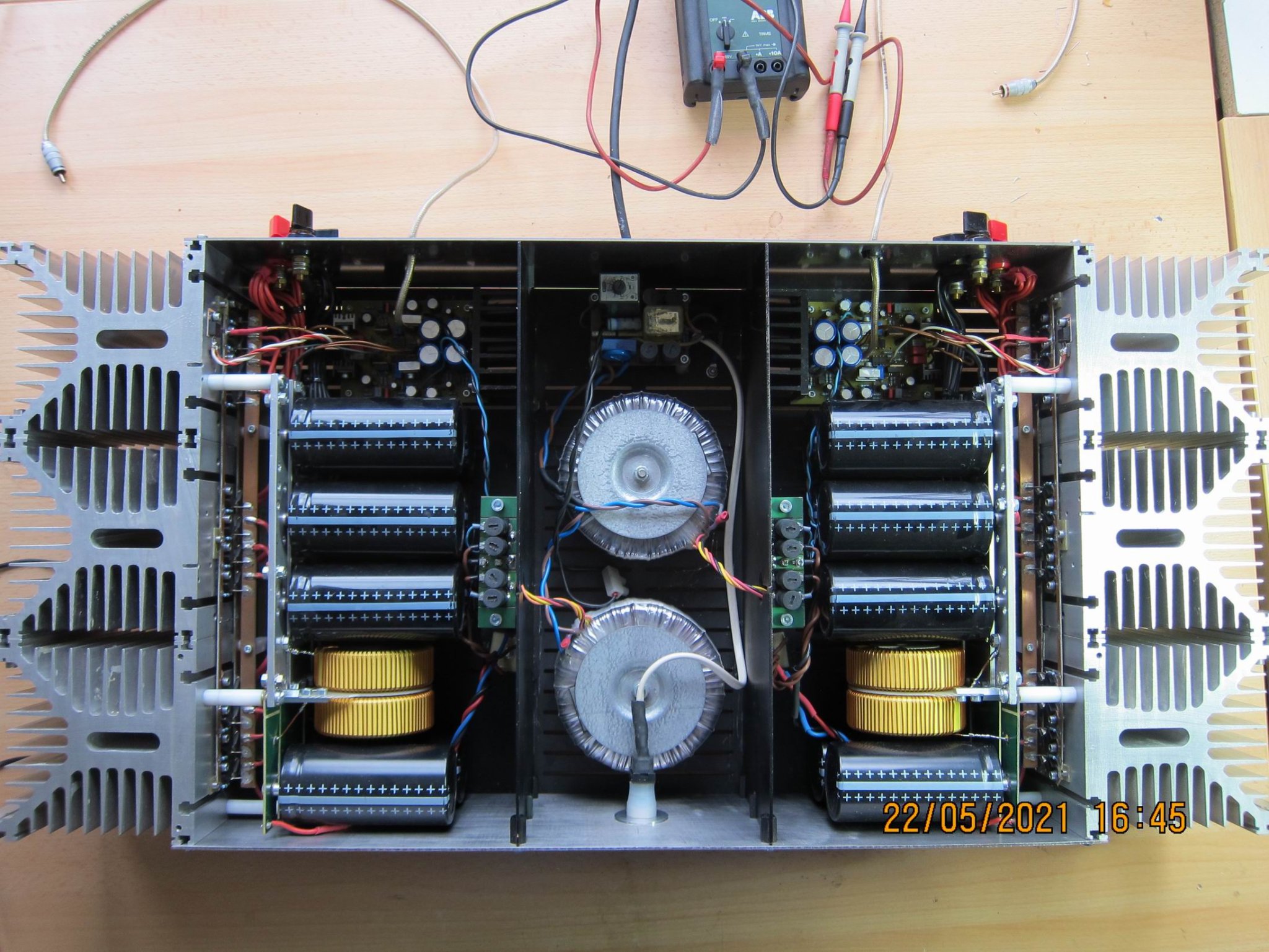

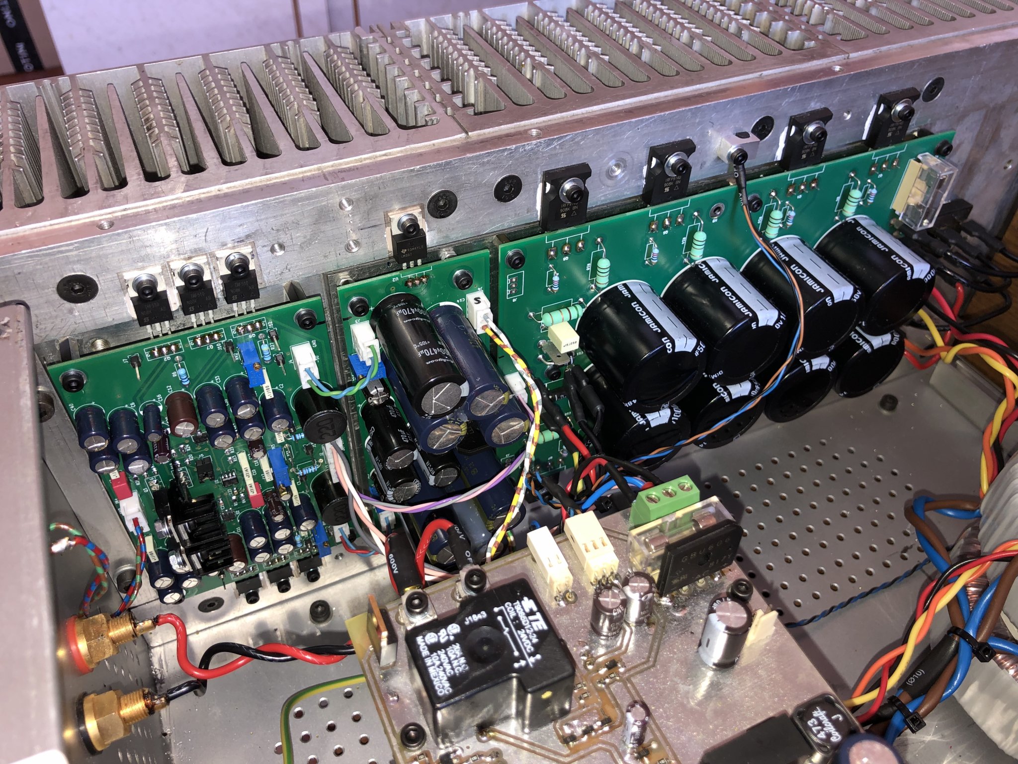

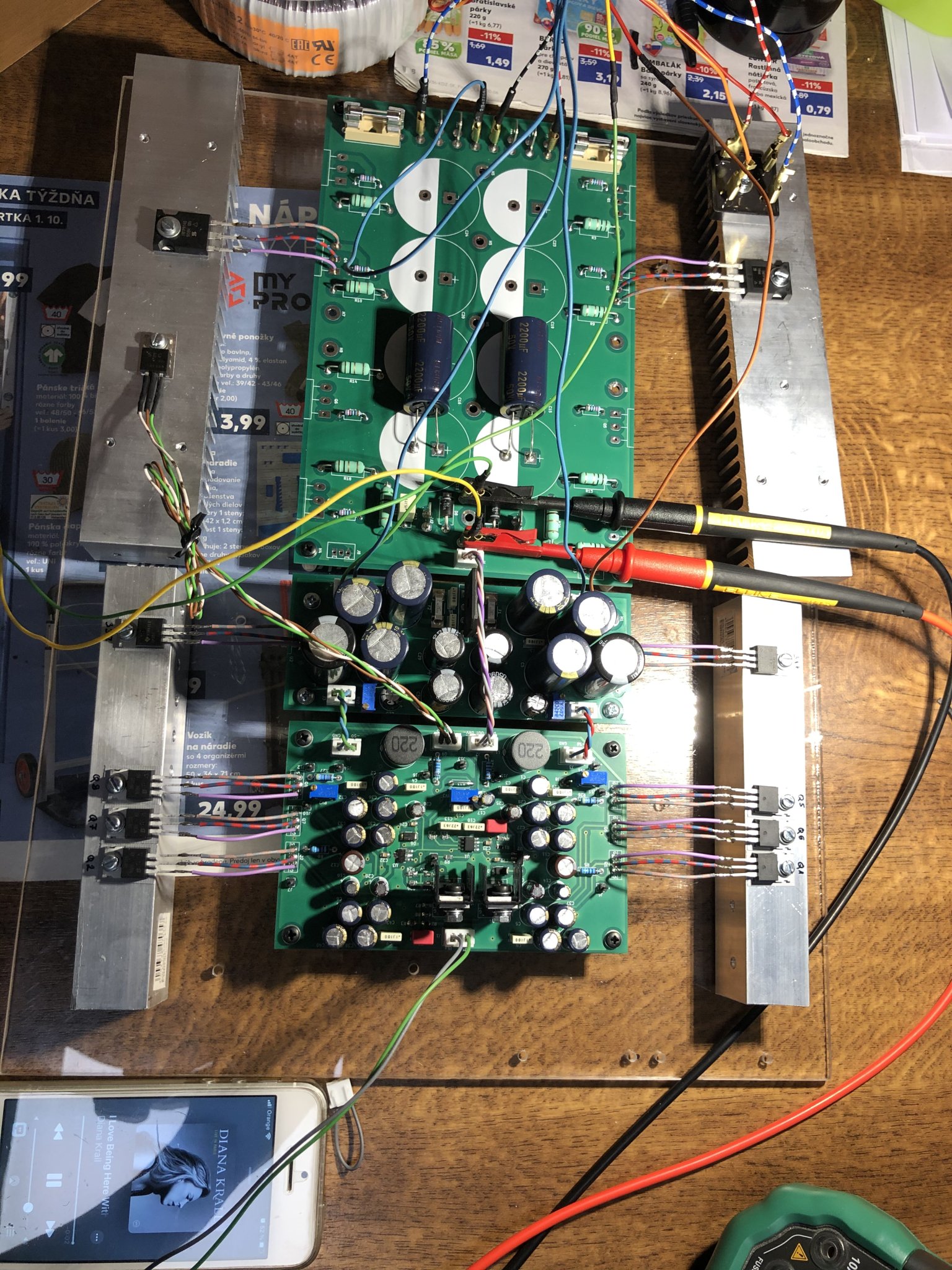

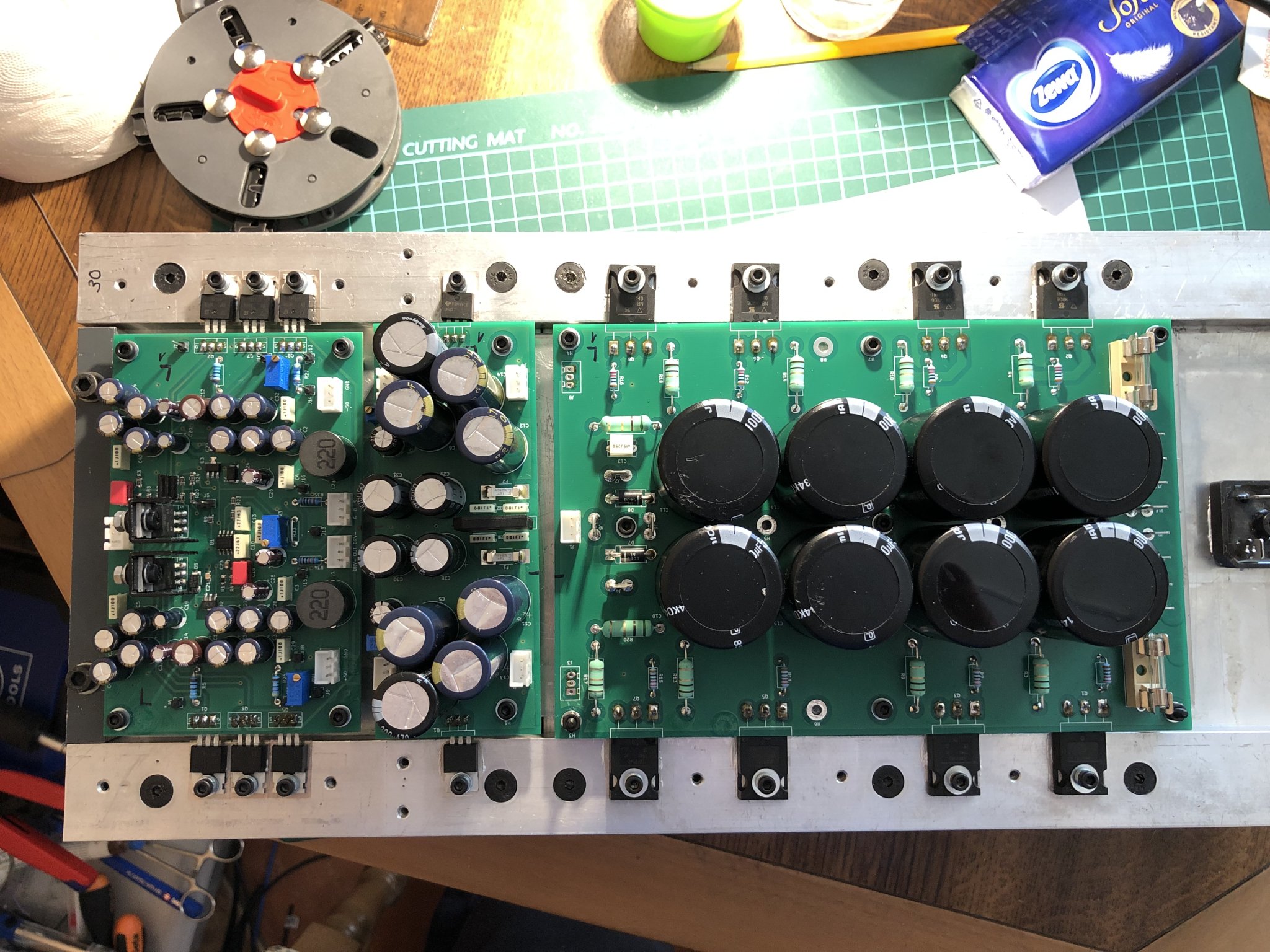

This is my modified A75 amp - maybe just an A40 from Nelson Pass. It worked the first time it was turned on and has been working great for 2 years.
The chassis is still not made, but it still sounds good.

Impressive work, especially the protection circuits and µC. Well designed and a good layout, i wish i could say this about my A75.
A low power A75, although the heatsinks look like they can take a whole lot more. Anyway, the A75 is a great sounding amp.
Your regulated +/-70V power supply for the frontend is a nice addition, i thought about building one for my A75, but in 15 years i only changed the voltage doubler caps once as a precaution, and they still measured well.
I presume D3 and D4 are some kind of protection, is there any documentation about them or did you put them yourself ? I found only two documents about changes from the original A75 article. If you have other documents or information it would be great if you could share them.
Is there a reason for keeping the 1 ohm source resistors ? As you have double device current, you could have reduced the source resistors to 0,56 ohms for same amount of degeneration. It would be interesting to know about sound differences.
Also, can you show me the connection of J5 DC_Out (vstup), i could not find.

I used all transistors IRF510 and IRF9510. I tried different types, but the 510s proved to be very good.
I didn't even use diodes D3 and D4. I've seen it plugged in for stability somewhere. But this amplifier worked right away on the right connection without hesitation.
I did not deal with 1 ohm resistors at all. I don't think that reducing their values would audibly change the sound. But it might be worth testing. I do not know.
J5 is a switch that connects and disconnects the DC Servo. I use a DC servo. Of course, only after the correct setting of the amplifier - RV1 and RV2.
If you want some background from this amplifier PCB - gerber, program with protection or soft start - there is no problem.
I am very happy to share what I know and what I have.

Thank you for your offer. My A75 is nearly identical to the original design, biggest difference (some would say mistake) is use of TO-220 IRF9630/630, and i have no additional protection at all. There were some output device failures (thermal ageing), but not catastrophic and the amp still worked well with app. 2V DC on one output, only the heatsink got really hot.
The DC-Servo is interesting. My amp goes to ~200mV offset shortly after start and settles down to 50mV within 10 minutes. Did you adapt the integrator to the time constant of the heatsinks ?
I think that the source resistors will affect the output impedance/damping factor of the amp. How much of a difference that makes i dont know, but i put 0,82 ohms with 12 MOSFETs (130mA bias) in parallel and I can say that bass is impressive (also physically), but this will depend on speakers too.
Your schematic shows C7/C15, did you put them in ? Also, did you try different settings/values for R81 and R21/22 ?

I used a DC-servo from my previous amp. I didn't change anything and it works fine.
Without a DC servo, I managed to set the output offset below 10 mV on both channels.
I also have a temperature sensor on the heatsink - DS18B20. Everything is checked on the protection board.

I used C7/C15. R81 = 0R and R21/22 = 100R. I did not try to change them or test their value in any way.
