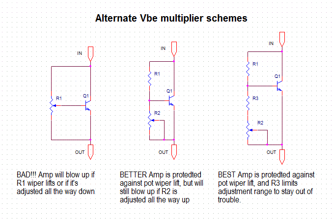

The collector of Q6 should go to the collector of Q5 and Q7-8 base, not to thee +V rail. Just having a pot to set the bias current in the output stage is dangerous, as the amp will blow up if the wiper lifts on the pot.
Here's a little tutorial on Vbe multiplier schemes. I fixed a Sony receiver that used the first scheme and blew expensive output transistors when the cheap carbon bias adjuster pot had a wiper lift. I lost respect for Sony product after that experience. I also replaced the faulty pot with a more reliable cermet multiturn unit.

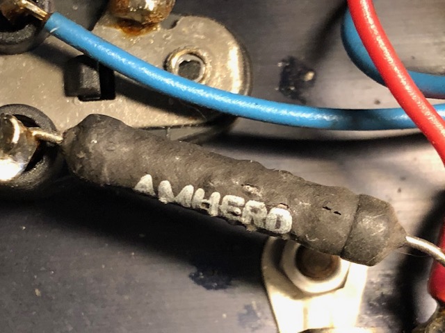

With the amp fully assembled there is not a lot of space for manoeuvre around the circuit board and I am thinking I may have shorted the incoming power supply to the chassis by accident. If that were to happen what do you think would be the first thing to go?
R16 is looking a bit crispy......
