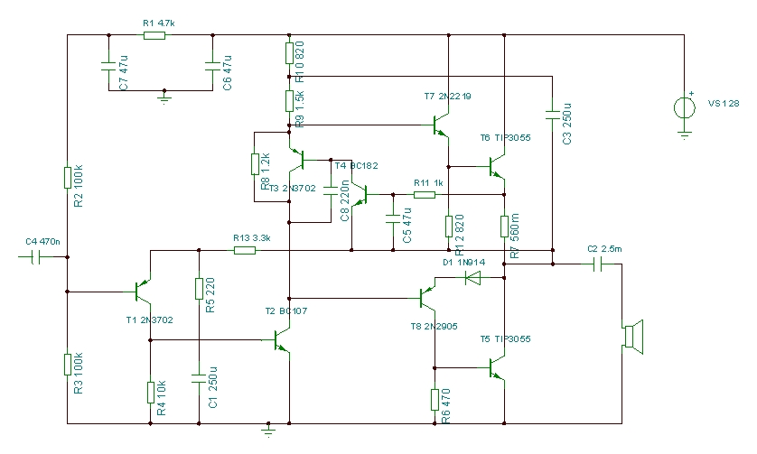

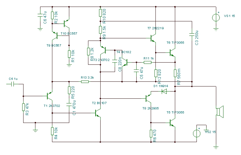

I have a Nelson Jones amp that after fourty years is in need of some work. It's a homebuilt affair by my late father, on veroboard. I've tried many other amps but always come back to this cos it sounds great. Maybe i'm used to it's sound or maybe i'm sentimental! Lately hum has become an issue, with power supply caps visibly dying. As part of it's refurbishment i'm putting in a symetrical supply to get rid of the output cap. While it's on the bench has anyone any other ideas for improvements? Getting rid of the bootstrap cap? I’ve enclosed the original circuit and my proposed rework.

Whilst eliminating the output cap is probably a good idea in principle at least, many including myself would say that for an old and simple design with no pretensions to hifi, fitting a current source in lieu of a bootstrapped capacitor would be a backward step. If you like the great sound, keep it.

The position of the suggested current source looks a bit strange. I think it is intended as a substitute for R1 + R2 and associated capacitors. The input section is very similar to the one i JLH. You can find several suggestions for improving it to reduce noise on the Internet.
The Nelson-Jones amplifier is very traditional: input + VAS + output while the JLH is not. If one of them have a distinctive sound I believe it would be the JLH.
The bias control in the Nelson-Jones can be improved. As is, it only senses the output current from one half of the output pair.
If You like the sound of it I don't think You should try and improve the design. Replace the ageing parts and be happy with what You have.

I would not use a symmetrical supply. I would use the output cap.

As drawn you'll have about 0.7VDC across the speaker. You'd need some way to keep it at 0V, a differential input stage or a servo. I'd stay with the big output capacitor, myself.
You missed the 4k7 in the supply line - so it would be significantly less than 0.7V. However, OP, I'd stay with the output capacitor because the output offset voltage is still probably a bit high for comfort. And the capacitor will protect your speakers in the event of a meltdown.

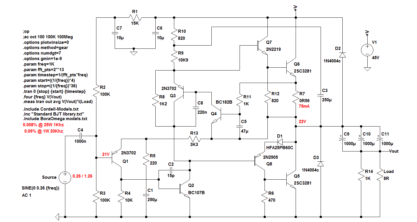

R2 in the CCS will be a pot, so i don't think offset will be a problem. Tried sticking a CCS in place of the bootstrap, and as was pointed out it made things worse, in terms of simulated distortion. I'm going to investigate the JLH input stage noise, then get it rebuilt.
